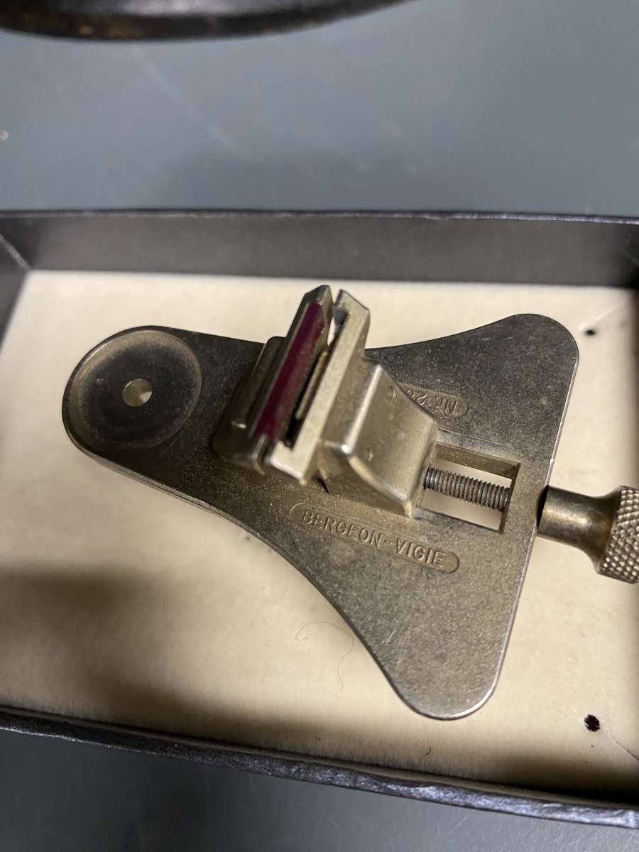

      This cropped up on a local auction house. It’s probably not a lot of use as one of the jaws is missing. I’ll post a link if anyone is interested.

        It would be quite a challenge to reproduce the missing piece, to Bergeon standards.
        But it looks like Cousins would sell you a pair:
        https://www.cousinsuk.com/product/poising-tool

            It looks like a saller version of a grinding wheel balencing fixture.

              So what would a poising tool be used for?
              #719348
                Effectively the same as David mentioned … but for the balance-wheel of a watch.

                    In the absence of ruby pieces, I wonder if solid carbide scraper blades might be polished and used.

                      When I worked on steam turbines they had a giant version for balancing the wheels. It had steel knife edges. Stanley knife blades might make a good start for a little one.
