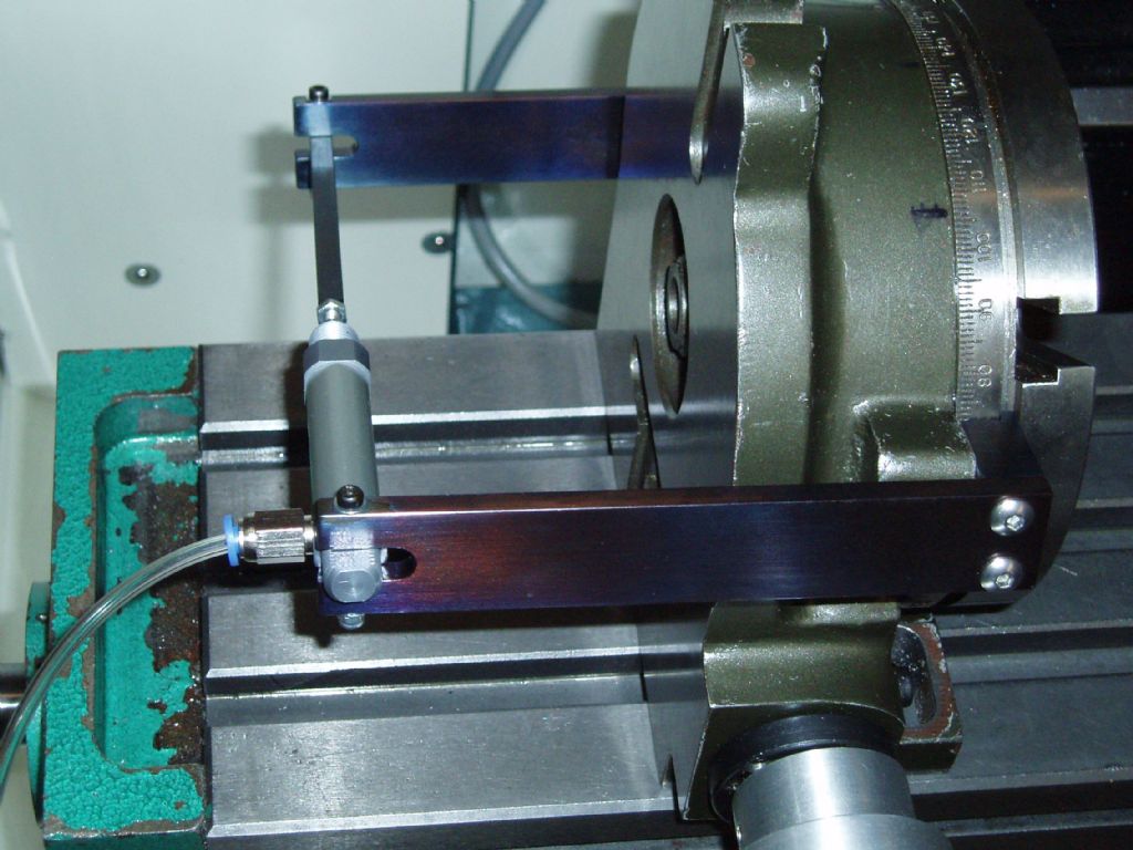

        I thought that this pneumatic brake for a CNC rotary table might be of interest to the forum. It's not difficult to make and just attaches to the original table clamp bosses without any modification. I think the picture says it all. (thats assuming this link works. I don't seem to be able to upload a picture directly to the board…)
        The air is supplied by a normal compressor, and a short Macro gets called by Mach3 to operate a solenoid air valve. Each 'A' move is wrapped in a pair of unlock/lock calls and the rotary plane is then held locked for the XYZ moves. I have got very litle backlash on the rotary axis, but it's still much better clamped. Anyway, it's certainly proving to be very effective.

              Welcome to the forum. The clamps certainly look impressive. Does the air pressure hold the clamp on, ie, failsafe, no air pressure equals no clamp?

                Yes, Andrew, no pressure, no clamp. Also, within the macro that I call to operate it, the A-axis gets disabled when the clamp is on, and re-enabled when it goes off. Not that I would ever try to code an A move with the table clamped But although Mach3 won't do A-moves from Gcode when disabled, the A jog still functions so I can still get it wrong.

                    Great bit of kit, now we look forward to a compact unit so you can use the table in both horizontal and vertical axis. By the way, what was the clunk clunk clunk at the end of the video ?

                      Yes, a compact version of the clamp for horizontal use would be nice, but I couldn't think of a simple way to do it – some cams under the clamping bolts would probably work. In the end I just wanted to get it made for the job in hand, thinking that normally you don't use the rotary table vertically on a cnc mill because the XY movements can do it all. That is until this week (!) when I came to cutting the internal gear by that clever method suggested by John Pace in last months MEW…

                        Regarding Brakes for the Rotary Table … There's one idea that keeps lurking in the back of my mind:
                        Could we adapt the hydraulic disk brake from a bicycle ?

                          Yes, using a bicycle brake is a nice idea. I'm sure it would work well. They are very strong with just the lightest of pull at the lever, and quite compact.
