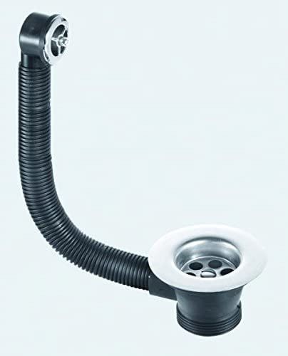

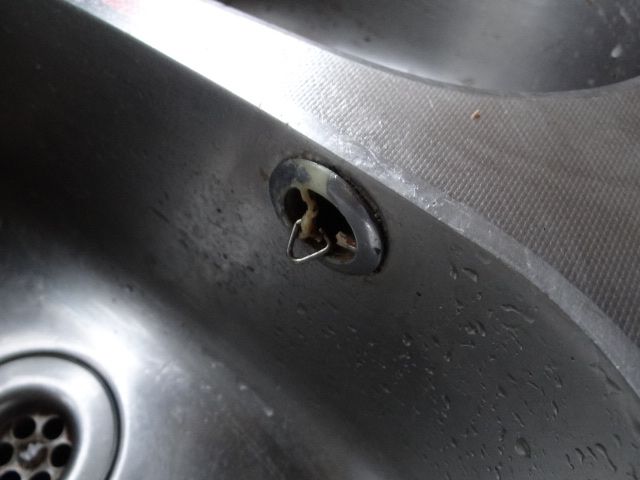

      I'm deeply embroiled in doing up my son's new house, which has loads of minor defects and a few big ones!
      Can anyone advise on how to replace this common fitting, which combines the sink overflow with the plug chain end.
      It connects behind to a flexible plastic pipe, which then dumps overflow into the main outflow.
      I suspect the fixture just screws in but the plastic is brittle and likely to break. Or it might be glued in , a press-fit, or special to this particular sink. Does anyone know how and if these can be replaced?
      Ideally it's a standard screwed part, or I could make a non-standard one on my lathe. If changing it likely to go horribly wrong, I'll just leave it, because the fix is mostly cosmetic and the upgrading the kitchen is on the cards in the distant future when (or if) Son Of Duffer can afford it.
      Ta
      #10740
        #533149
          They usually screw in to the plastic "elbow" behind. usually come complete with the whole sink waste.
          Edited By JasonB on 11/03/2021 09:31:48
          #533151
          Journeyman
            @journeyman
            As Jason says just unscrews not usually much more than finger tight.
            Whole kit less than a tenner from Wickes, Screwfix, B&Q etc.
            #533152
            Mike Hurley
              @mikehurley60381
              As Jason says – simply screws into the elbow ot the rear. Have a look at Screwfix's website and search for sink overflow fitting and it will make it clearer.
              Hope that helps
              Journeyman beat me to it!

                  Looks like Dave wants to change it as the chrome has worn off rather then just wanting a chain
                  Beware the above linked to unblocker as they do not mix well with push fit waste fittings!
                  Edited By JasonB on 11/03/2021 10:05:30

                                              Oh dear, didn't go well. Stuck tight, and cracks rather than unscrews. Left it for the time being…

                                                Not surprising. Lots of composites become brittle with age..
                                                Looks like you are in the market for a new overflow, at minimum, or complete drain outlet assembly.
                                                Search Screwfix, Toolstation, B&Q, Homebase, Plumb Centre etc
                                                If you are lucky, you may find fittings that are compatible with e flexible pipe that is in situ.

                                                  That's why they sell the whole thing as a kit. Just rip out the old one and replace the elbow, screw in cover and corrugated tube . The tube is just a push fit over the spigot on the waste outlet. They don't usually leak but the push fit doesn't inspire confidence in water tightness.
