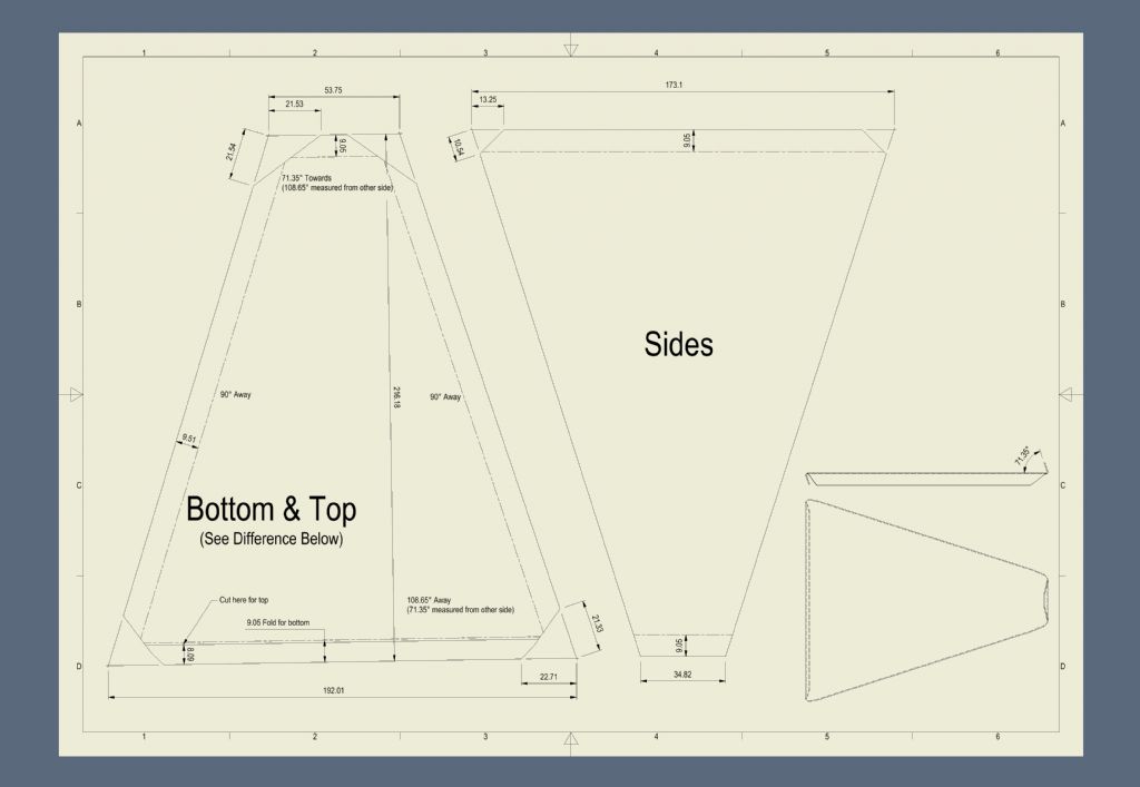

      I want 6 to 10 17cm pellet traps and at £10-15 each, it soon adds up!
      I've got a load of cold roll 0.7mm steel pre cut to 12" wide and a 3-in-1 12" sheet metal machine, so I've decided to just make my own. Here are the drawings if anyone's interested.
      This drawing is for the top, bottom and sides. These can be spot/tack welded or riveted together and are designed to be attached to a vertical piece of steel or wood if you like. I'll be using whatever I have to hand, likely a bit of angle iron. Note the angles are beyond 90° so I guess I'll be finishing off the fold by hammering over a piece of metal or something (I'm not a sheet metal worker, I'll just keep hitting it till it makes sense)

        Drawing for a 17cm sheet metal pellet trap

          The plan is to mark out the steel and then cut out the full trapezoid, then the clip the corners off as show and then get busy with the box/pan folding, finishing off the +90° angles by hand unless I can machine a new "thing" for my 3-in-1 machine that will help me do it, since I'll have a lot of them to do. The tac weld them together and tack the assembly to a vertical piece of 50 or 60mm box or U channel or something I can easily attach to 2" wooden pegs.

                    The angles on the sheet metal are wrong, I'm just trying to get my head around it….
                    #335461
                    Russ B
                      @russb
                      dwg fixed at that link – I'll change the one in my album now
                      That was a hell of a headache, not as simple as I first thought. The way I'd constrained the sheet metal in the 3D software led to a wonky box who's edges didn't align!!
                      Small, but very very important changes to almost every dimension on the drawing pulls everything in to perfect alignment.

                        I can't remove the "wrong" drawing in the original post, despite removing it from my album.
                        Here is the correct image…. I hope….
