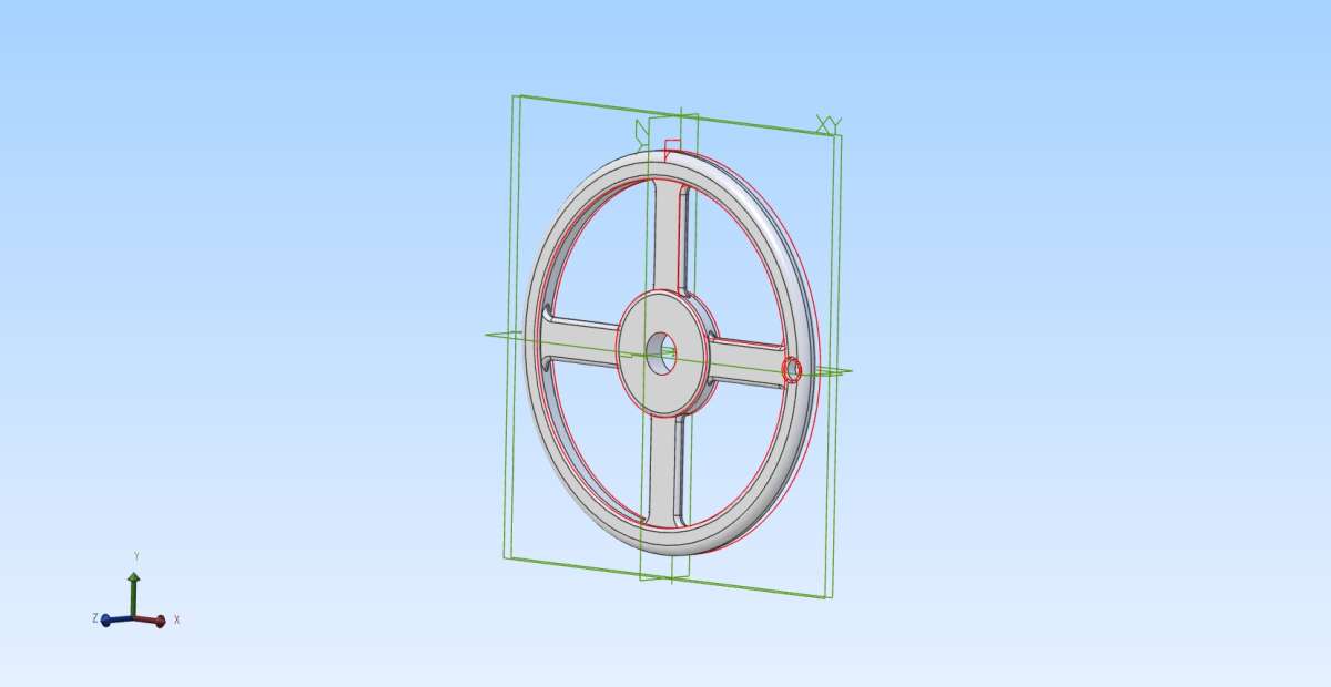

                  Steering-wheel. 4.75″ dia, which seemed about what the photograph gives and scales to 14.25″ full-size so probably not far off. The small hole in the rim is for a vertical handle.
                  The central bore is nominal so far. I’ve yet to work out how to fit it to the shaft.
                  It was only after I laboriously rounded to rim by an extruded cut then the inside edges by “Fillet” I realised I could have used the Fillet tool for the rim as well!
                  Steering-wheel

                    Yes several ways to do things, another would have been to draw a cross section of the rim and revolved that as a solid. That way you would not have the problem of needing a smaller radius on the inner edges to avoid cutting through the spokes.
                    Assembly to shaft is much like you have done with the crankshaft and it’s parts: Concentric constraint of shaft to hole and another constraint of the underside of the hub’s face to the end face of the larger dia of the shaft

                      Much truth in Nick’s comment “Your one hell of a struggle is self-inflicted“.  Trying to run before one can walk is always painful, and moving to model the crankshaft assembly immediately after trouble with the block was several steps too far.   I’m impressed by how well Nigel is doing considering how difficult many of his ‘simple’ tasks are.
                      How best to learn is personal, but the usual method is to start with the basics and then advance step by step.  When a step fails, it means that an earlier lesson wasn’t quite understood, and it’s necessary to go back and fill the gap.  Frustrating, but I don’t know of a better alternative.  Leaping ahead doesn’t work for me.
                      The steering wheel is a good learning project, and I recommend exploring it thoroughly.   There are a number of ways of modelling it as a single part, all with pros and cons.   Worth experimenting with a steering wheel made as a:
                      • Single part, from a flat disc, spokes cut out, edges filleted
                      • Single part, from disc, produced by rotating an extrusion. then cutting out spokes with a pattern
                      • Assembly of a single part rim, with ‘n’ spokes, and a single part hub.

                        I didn’t draw that wheel right through in one go.
                        It took a few attempts to get it right.
                        My first mistake was laboriously plotting all four cut-outs, which meant chasing very many misconnections between lines and arcs. Then I spotted the sketch fillet-tool and worked out how to use that for the corner radii.
                        The spokes now “worked” but looked too wide so I remade them, this time using the radial pattern tool to copy just one plotted hole.
                        Making the “form-tool” for the rim radius needed a few attempts too. The first left a razor-edge “burr” round the wheel, so I made the second generating circle diameter very slightly larger than the wheel thickness. Then had a minute fragment of line from somewhere in the construction, that proved very difficult to track down and delete.  I’d also extruded the wheel from the flat plane, not through it, making this construction harder.
