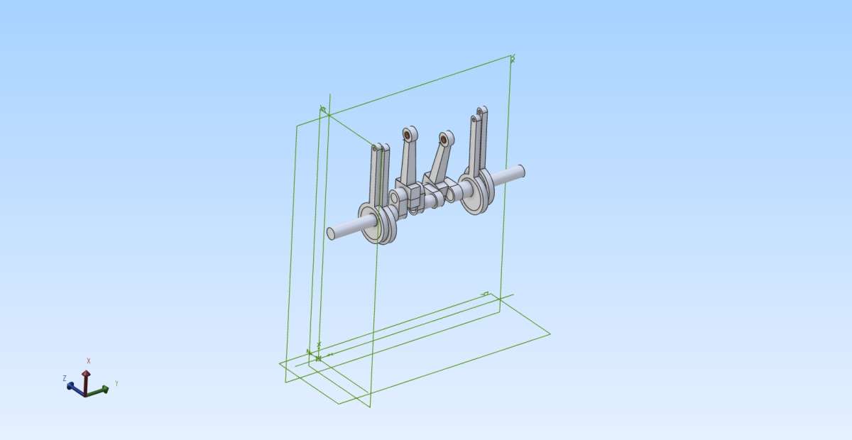

      With several hours and false starts, I created an image vaguely resembling my engine’s two-throw crankshaft.
      It has four identical webs but I had to make three separate web drawings, pointing up, left and right; because four copies from just one gave one correct pair and one handed pair! Anyway I needed one pair at right-angles to the other.
      So I drew some simple extra parts to try to understand basic Assemblies. Nothing fancy – just basic, rather symbolic shapes to easy sizes.
      Assembling:
      1) Call up the crankshaft and anchor it.
      2) Call up 2 copies of the Connecting Rod, 4 of the Eccentric drawn as a plain disc with a little keyway to indicate orientation*, and 4 of a rather unrealistic, one-piece Eccentric Strap+Rod.
      A vertical engine so I had drawn the eccentrics and their rods in XZ, hoping it might open in the assembly drawing in the same orientation. Sometimes Parts do, but usually they open in random orientations, and stay like it.
      How do you make the planes consistent between Parts and Assembly, and the Parts transfer in their drawn orientations?
      Can a copy of a Part pointing one way, be rotated to point another? (I can’t make that Constraints ‘Flip’ work but it’s not necessarily always what is wanted – even if I make the Constraints work. I probably tried use it for the wrong things.)
      Eventually I managed just a single eccentric on its right part of the shaft but could not rotate it to some nominal angle of advance. I abandoned the exercise, and don’t think I saved it.
      So…… :
      Although “Help” showed I had been using the tool correctly to rotate the Part, something stops it working (the “Apply” button stays grey). The translation part of the same tool (dx, etc.) is the same: enter the values etc. and nothing happens. I don’t think I’ve ever made it work!
      – Is it blocked by already-applied concentric and face constraints?
      – Is it because copying a Part to an Assembly loses its original planes and axes?
      – The rotation tool asks for an axis. Which axis? All the three displayed axes might be nowhere the part and hinge-line in question.
      – What conditions need exist in the sketch or model for it to work?
      Clearly, I might be able to assemble an image of the crankshaft with just one connecting-rod, that on dead-centre, and for a horizontal engine, as that is how the rod’s drawing opens; but that’s all. Anything further is too hard!
      I also managed a separate Assembly of connecting-rod and cross-head, although the rod was not properly centred across the width of the block. As with the exercise above, the face constraint prevented axial symmetry. Oddly, the rod also parked itself at some angle about the gudgeon-pin as if at about third-stroke. Since I’d drawn them about centre-lines I’d expected the two parts to assemble in line, as on dead-centre.
      *The seed rectangle for cutting the keyway took long enough, working entirely by lines and dimensions. I can’t make those constraints work for them.

        Sometimes things won’t line up so you have to do a 3 stage lineup
        Stage 1 Get your object into a better simpler position using the main planes to turn it around
        stage 2 DELETE those constraints in the listing, the object will stay in position
        stage 3 Do your original object constraints again
        also
        I often lock the main/core part of an assembly into a fixed position and jiggle the other stuff around it
        assembly is a bit of a black art but it makes Alibre an exceptional package for the money and all your hard work well worth the effort

          I have told you about this before.
          If you right click on the part you wish to orientate to the main X, Y and Z planes a drop down list appears, towards the bottom is “Show reference Geometry” Click that.
          You will now see the part has its own X, Y and Z planes in brown. You can then simply use constraints to align one of the brown planes with the main green plane or if two parts are clicked you can align brown with brown. Right click the part again to get the dropdown and click the ref geometry again to hide the brown planes when done.
          As for something like a conrod or eccentric they should line themselves up as you assemble more parts. The conrod will rotate around its length ways axis if you constrain the big end to a crank journal or an eccentric strap will move to line up with the eccentric even if they seem to be on the wrong plane when inserted into the assembly window.
          To get them to load into th eassembly screen in th eright orientation is mostly forward thinking when you draw an item, the more you use Alibre the easier this will become. The assembly should bring the parts to the correct alignment even if they are not drawn that way, again just a case of using Alibre regularly and becoming familiar with how things work.
          I have also mentioned sub-assemblies before which can simplyfy things for example assemble the strap, rod and clevis to get an assembly of the eccentric parts or the conrod, bottom half of the big end, wrist pin, etc. You can then bring that assembly into the main drawing which then needs less work in what can become a complex assembly.

            Or much simpler – hold down the Shift key whilst dragging cursor on the part in question, this rotates the part freely.   You only need to get it ‘closer’ to desired orientation, no need for ‘spot on’ – the assembly constraints will do that bit.
            Nigel – even when things don’t turn out as you wish, SAVE the file.  We can use this to see what you’ve attempted, and as a basis to show you how to fix things.
              Nigel, you can use any straight edge as a rotation axis for that tool.  If you have previously activated ‘show reference geometry’ for the part, you can use axes from the part.

                                  It may help to know that mathematically at least planes have a ‘direction’ – the direction is normal to the plane, Alibre can display an arrow to show the direction.  This is ‘Show plane normals’ – accessed from System Options -> Design Viewing ->
                                  If you constrain 2 planes, or 2 faces, or a plane and a face, they can either have their ‘directions’ pointing the same way, or opposite ways.  This is the reason for the ‘flip’ button in the assembly constraint tool – the initial application of the constraint may often be the ‘wrong’ one of the 2 possible orientations, the flip button lets you reverse it if needed.

                                              Nigel Graham 2
                                                @nigelgraham2
                                                One hell of a Struggle……
                                                Cshaft+Crod+Ecc+Ecc rods
                                                Though based on my actual engine this is entirely intended as Alibre Atom practice. It is not accurate to the actual machine in all dimensions, and is considerably simplified in detail. The con-rod centres are correct but the blocky appearance of the stem is because I could not generate the rather involved real shape.
                                                I did discover how to centre the big-ends along the pins by planes (though I’d not thought to make their extrusions mid-planar to help that); and the way to place the half-stroke small-end’s location above the centre line.
                                                Placing the eccentrics was err… “fun”, hampered a bit by optical illusions.
                                                I found it sometimes safer to place the multiple bits one at a time rather than as copies of one call to the library.
                                                The eccentric-rod are standing up simply for appearance: I think plotting their real locations in Alibre would be too much for me. It would probably be easiest manually!

                                                  Once you have constrained the strap to the eccentric you can just plave the mouse over the strap, hold down th eleft key and position the eccentric simply by moving the mouse while still holding the button down.
                                                  You do not need to plot the rods final position, once the valve rod and it’s clevis is in place you simply constrain the hole in the end of the eccentric rod with that of the clevis and Alibre will take care of the rest keeping the rod end moving in a vertical plane while the strap moves eccentrically.
                                                      You can go back and edit the original extrusion of the part and switch it to mid-plane.  In most cases there won’t be any negative effects, but you should always ‘generate to last feature’ and check carefully that nothing else has been disrupted by the change (that might need further edits).
