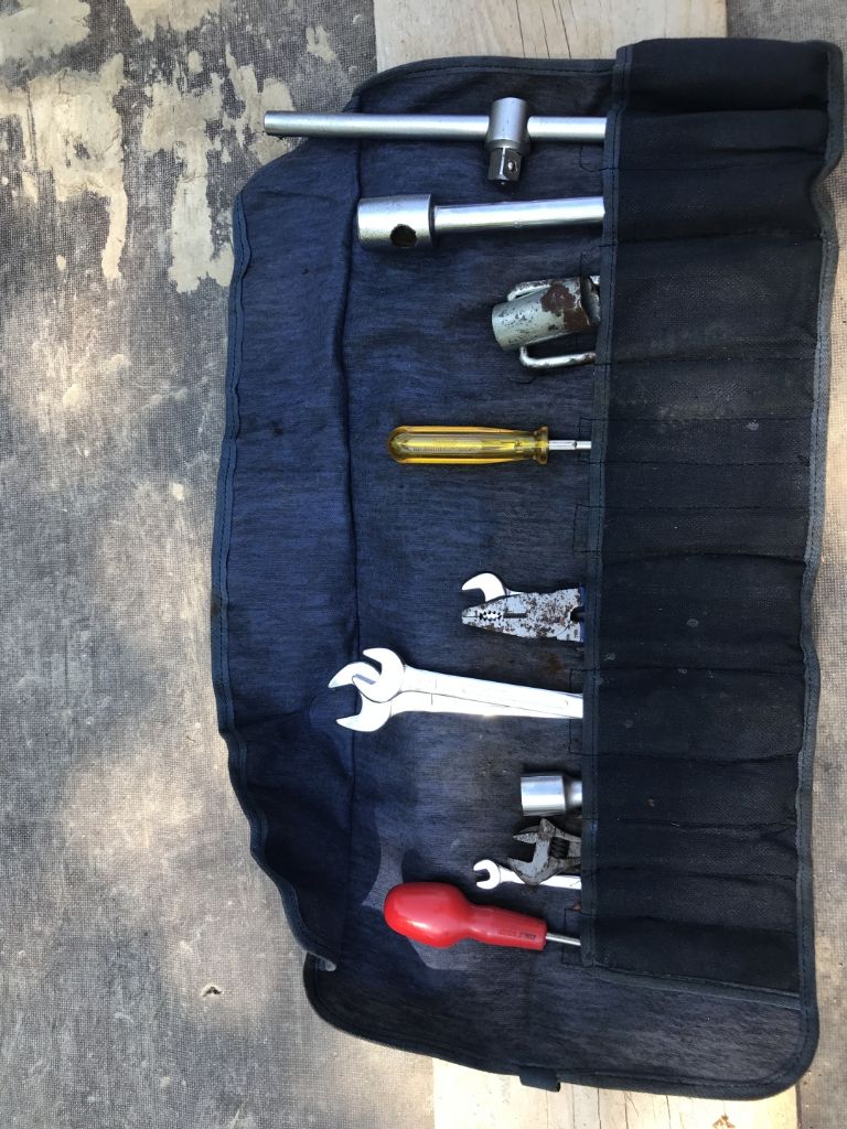

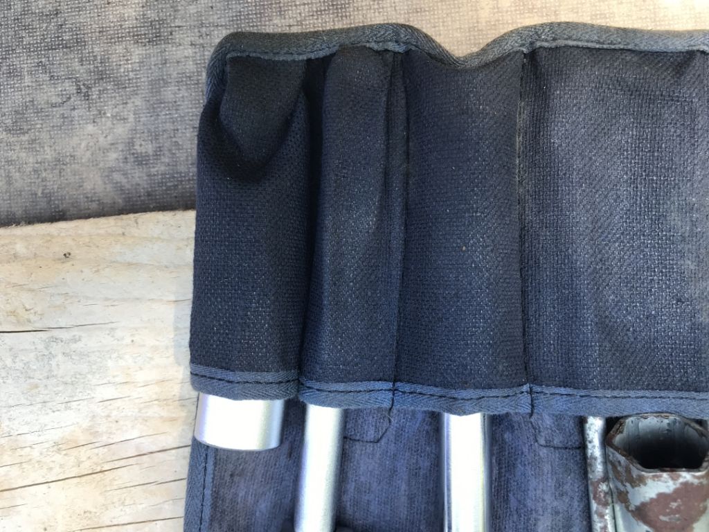

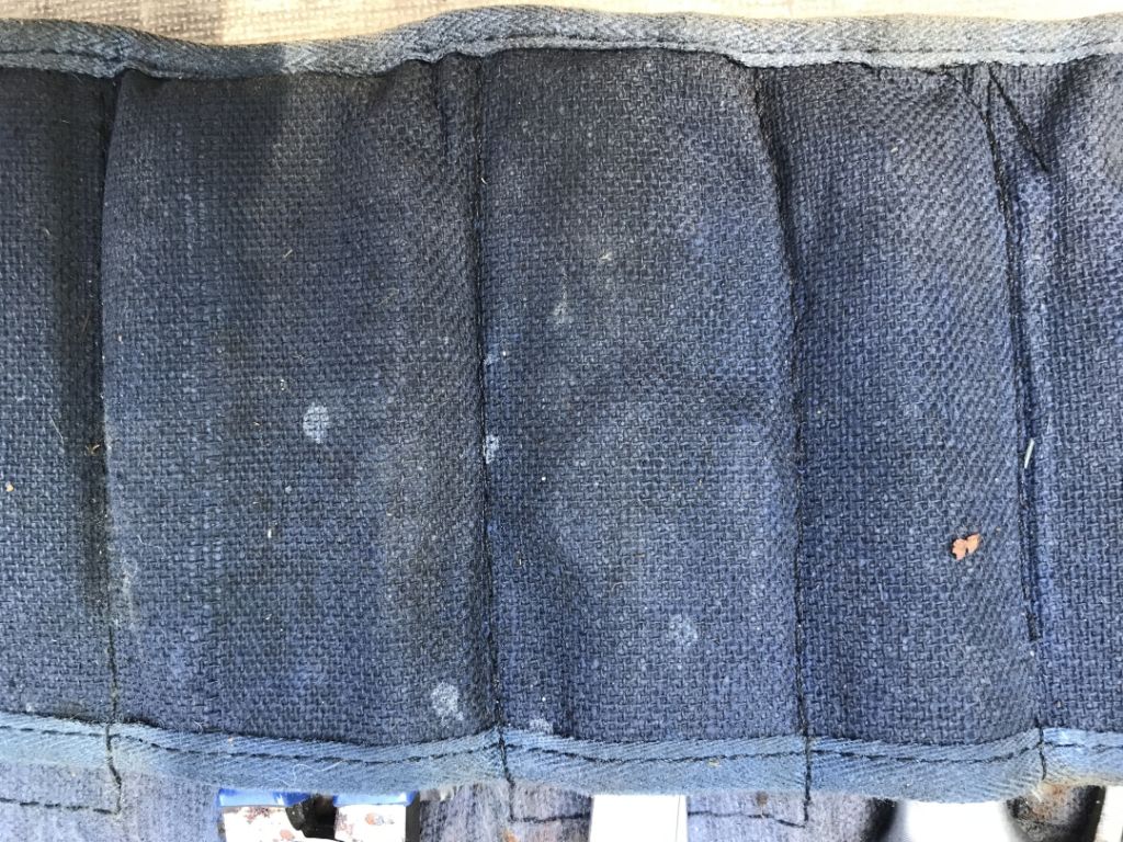

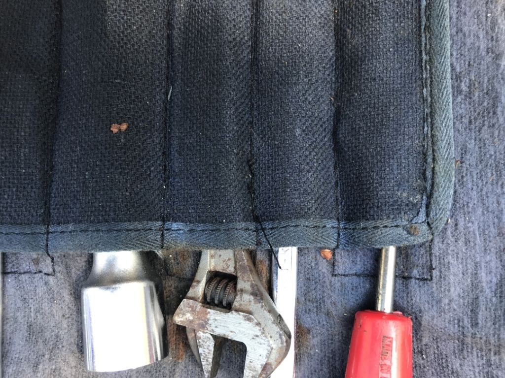

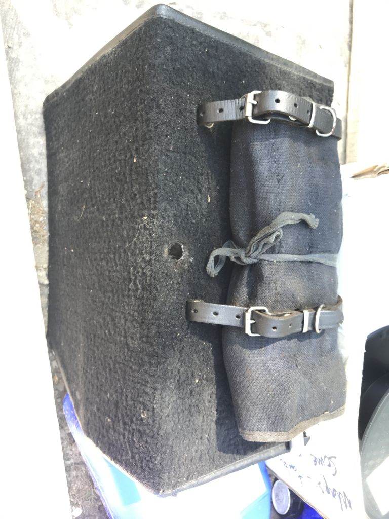

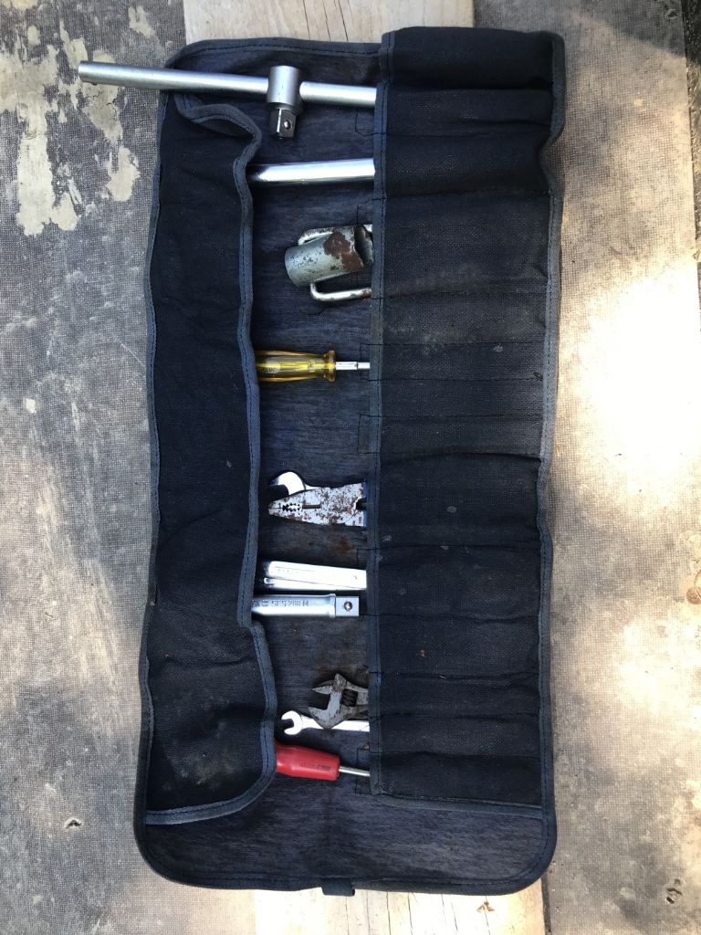

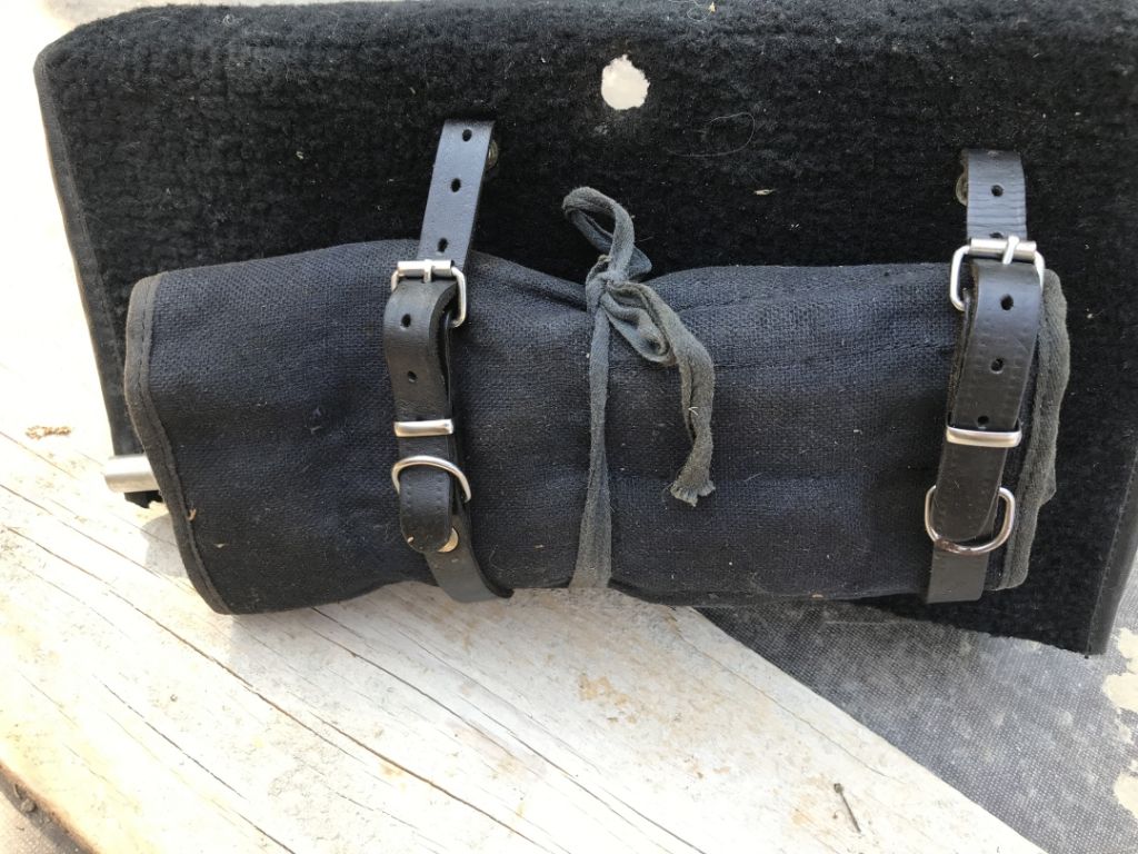

                                          simondavies3
                                            @simondavies3
                                            A bit of a late contribution but the following photos show the toolroll that came with one of my classic cars – as the final photo shows, this one was replaced I assume because someone nicked the original….
                                            Heavy canvas, and as far as I can tell, more or less flat pouches. It sits in the boot strapped to the battery cover with two leather straps (not the original ones, I replaced them with something from the dog supplies shop!).
                                            A fold down panel to stop the tools dropping out when rolled up. Integral cord to tie it up (no velcro here!)
                                            All the tools are high quality Bahco, King Dick and the like – sad thing is that I don't think I have ever used them in 27 years of ownership.Mind, for the selection, 121GBP in 1990 was a pretty good deal I think – and it was a genuine manufacturers supply.
                                            Anyway, hope this may help the design process.
                                            BR
                                            Simon
