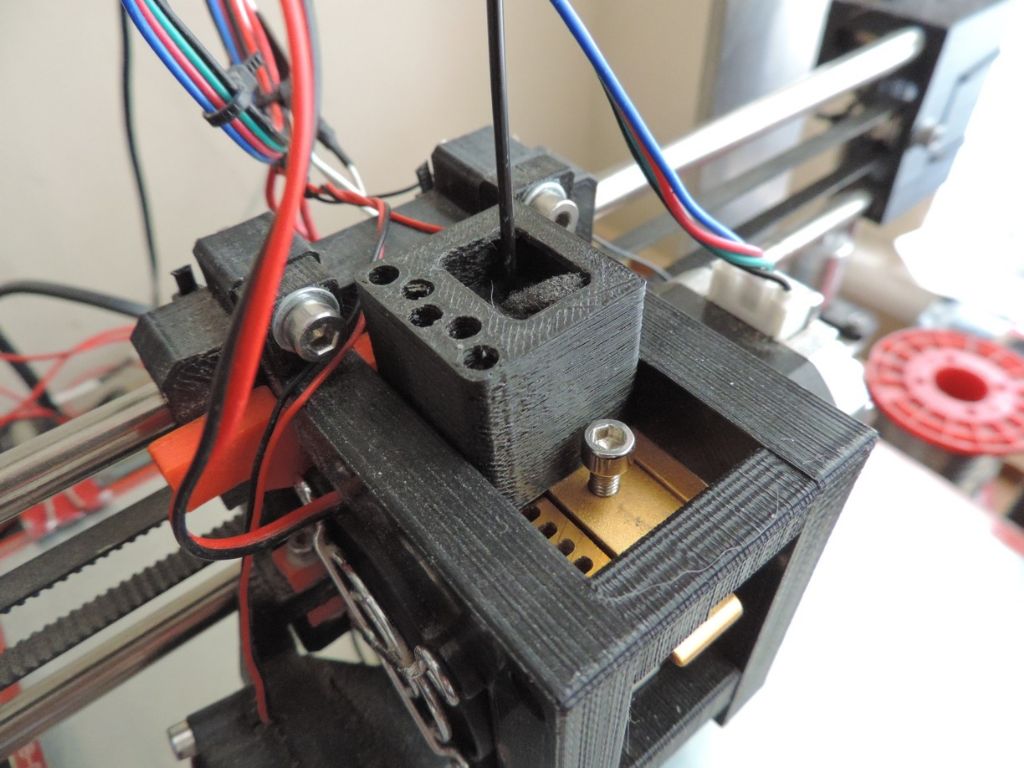

                                #368848
                                  Filament cleaner – it's got some foam inside it. It bobs up and down when the filament retracts. The holes make sure it doesn't block the heatsink fins.
