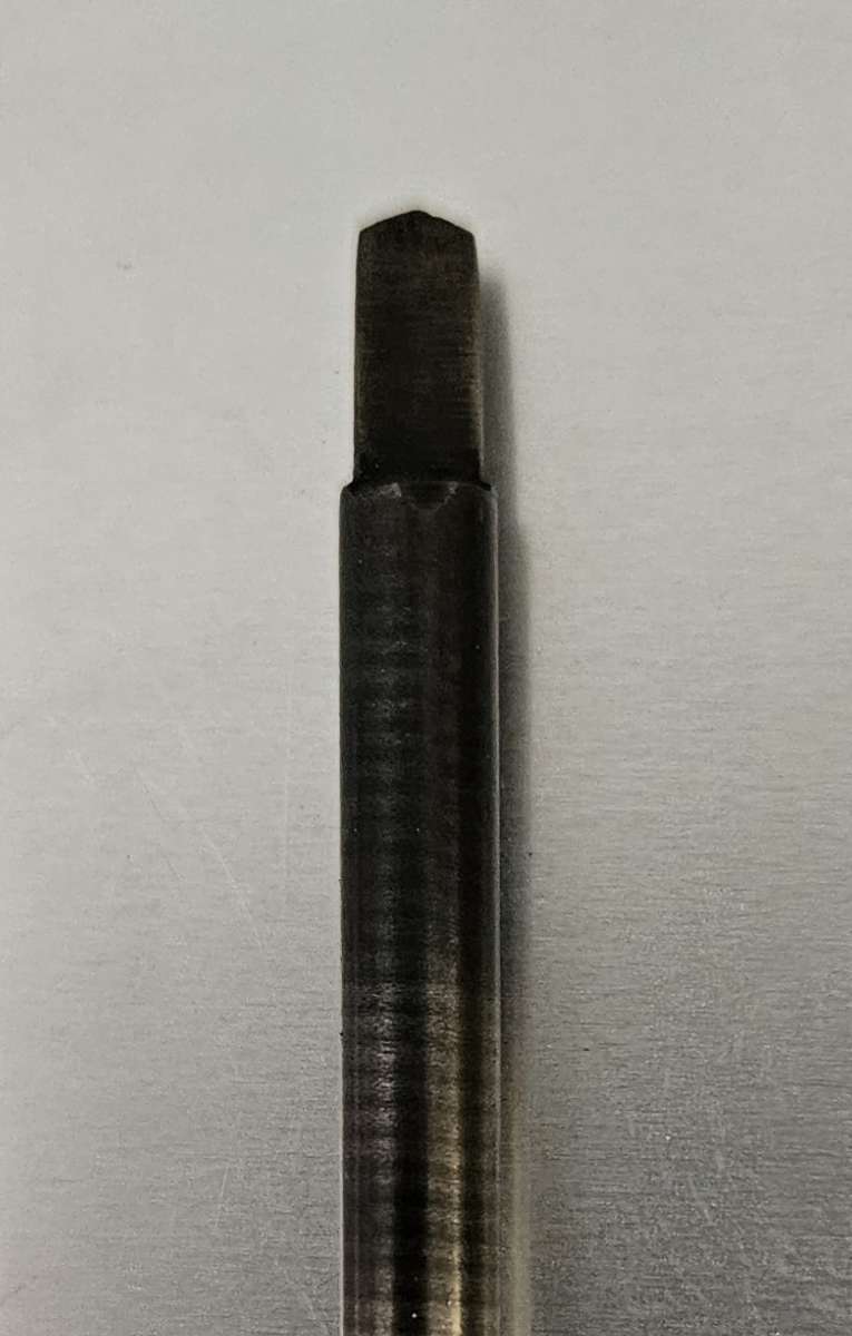

                      So,
                      I made a tapered 4mm drill from silver steel, simple point with a flat on the tapered section to make a fancy D bit.
                      I tried the tool out on some brass the same thickness as the clock plate.

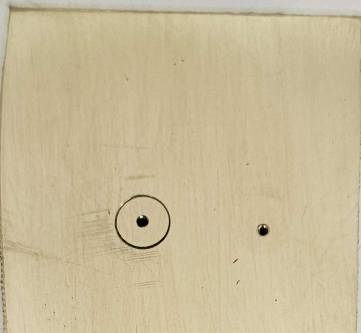

                      I used the centre scope in my jig borer to line up on a 2mm hole in the brass and bored the 4mm tapered hole.
                      Swapping the drill bit for a 5mm silver steel rod I pressed an English bush into the newly bored hole.
                      I tried again with a badly ovalised hole as instructed and again got a perfectly centred hole.
                      The two are shown below, the one with a witness rich around it I countersunk before pressing in the bush. May work as an oil reservoir?
                      I will move on to the actual backplate and see if I can replicate my method with that.
