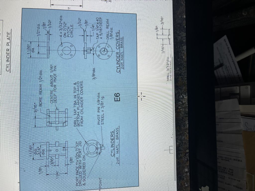

      Can anyone tell me what 7/32 pitch circle means on drawings for a cylinder with 4 holes for the cover, the outside diameter is 1. 1/16, the bore is 1/2,

          It generally means that the 4 holes will have their ctrs placed evenly around a circle of 7/32" diameter but that sounds very small. What engine is it?
          Following your edit something just over 3/4" PCD would be more likely.

                    The drawing has the following information, 4. x 3/32"dia on 7/32 Pitch Circle, I guess that 3/32 is the hole size
                    #550776
                      How to post pictures here
                      Yes 3/32" hole size and I'm with Howard 27/32" sounds likely.

                              The side view drawing shows the holes between 1 1/16" and 3/4" so 7/32 must be an error or they end up in the bore.
                              ME drawings seem to be full of errors and omissions in general. It's wise not to make stuff at random without comparing the fit.

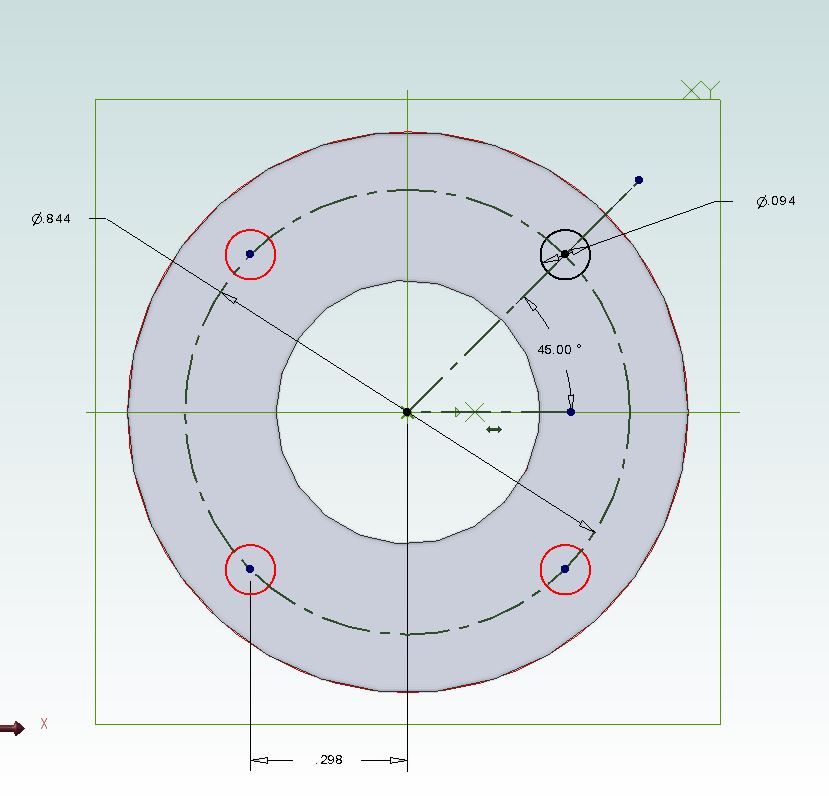

                                  As Duncan says 27/32 (0.844" ) plots Ok and looks like the drawing.
                                  The PCD or Pitch Circle is the diameter of the green dotted circle that should have been 27/32" not 7/32" and that is what the ctr of each of the 3/32" holes sits on.
                                  Edited By JasonB on 21/06/2021 20:01:54
