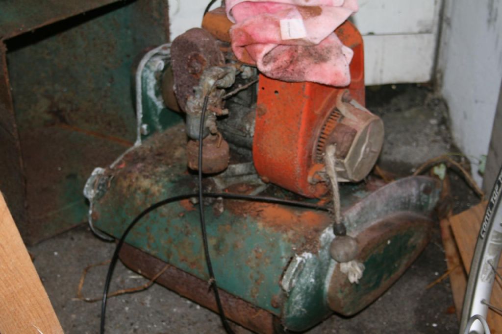

      I'm doing up a Suffolk mower remember? Well the engine wouldn't go , so i swapped it for another i had , and the mower works. But i want the original engine back on it really..
      Been tearing down the original engine , to find out what's wrong with it ,and the inlet valve was rusty .I guess the valve was open and then moisture  got to it .That's now sorted . But , i've got the piston rings off too and without me glasses on they looked the same so i tossed them into the box of parts…

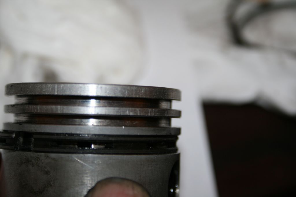

      With me glasses on they're different ! Any idea what is top ring and bottom ring ? And orientation? 3rd ring i didn't remove is an oil control one . 'Scuse rubbish drawing , here's the sections . Ring 1 looks a type of ridge dodger top ring

          The groove for ring 2 will have a shoulder on the inside to suit the step in the ring.

            sad No step. And i cleaned the crud out so there's no tell tale of carbon.. frown There is no ridge on the bore, does it really matter where they go ? It'd only a 1 hp or so ,mower img_5097.jpgengine ..

              Ring 1 is the top ring , therefore ring2 is the middle ring

                Ok , but what way up ? Ring one as a ridge dodger?

                  Not replacing the rings with new? What is the ring gap in an unworn part of the bore? Can you see a line in the ring groove to determine where the inside stepped ring fits? The more worn (on thickness) is likely the top ring.
                  There won't be a ridge dodger if original, so that step is likely bottom side of second ring. You may need a ridge dodger if the bore is worn and you fit new rings.
                  Are they square or tapered rings (if not appreciably worn)?
                  You might need a magnifier as well as your reading specs. If there is metal displaced on the outer edge of the ring (sharp edge) it will be the bottom of the top ring.

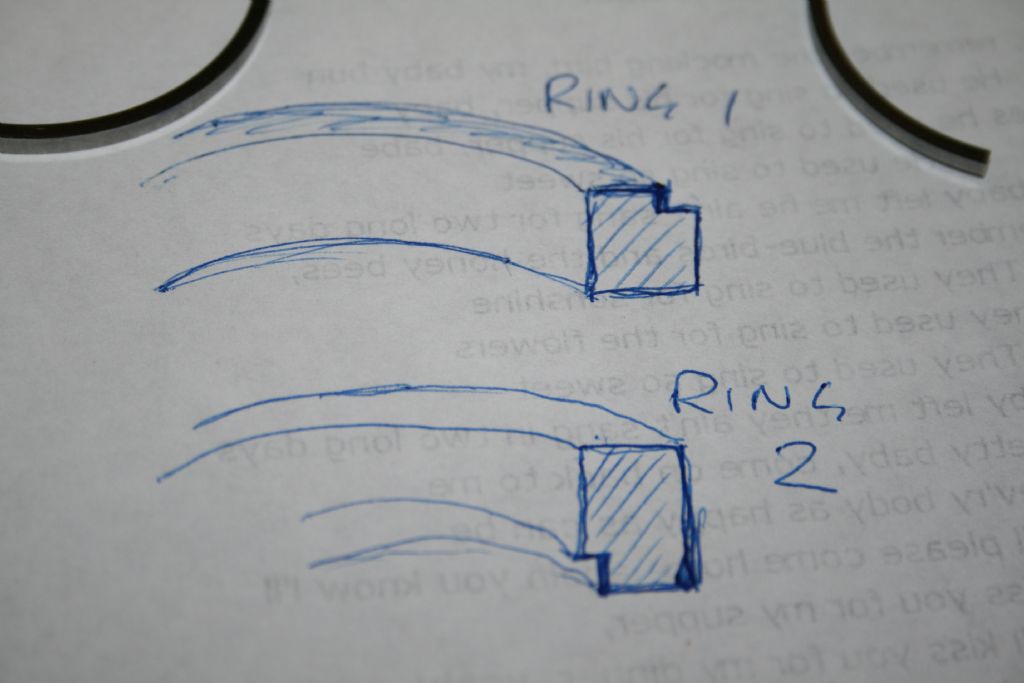

                    Square rings . No ridge at all ,low mileage..The second ring groove is slightly chamfered at the top ,under an eyeglass…

                      It looks to me ring 1 is correct and the second ring is upside down. Not sure on your'e exact engine, but a lot of older engines that were one piece barrels, used a ring design like that on the top ring. Most likely due to the limit of blind honing a cylinder back in the day. The gap at the back of the second ring is for residual pressure to push against the ring to make it seal. The ring gap will be in the 0.2 to 0.25mm range, 0.008 to 0.010 thou, with inch feeler gauges. They can still work even at a smaller gap of 0.006 inches , if teh ring gap is too small, it wears the top of the bore prematurely.

                        Ring 2 is the top ring and the groove faces the top of the piston .
                        Ring 1 is the second ring and the groove faces the oil ring

                          Hi Hacksaw I have a complete piston from one of these and from checking
                          Ring 2 is at top with the step at top
                          Ring 1 is at the bottom with the step at the crank side
                          Vince

                            Thanks chaps , I'll go with that then..

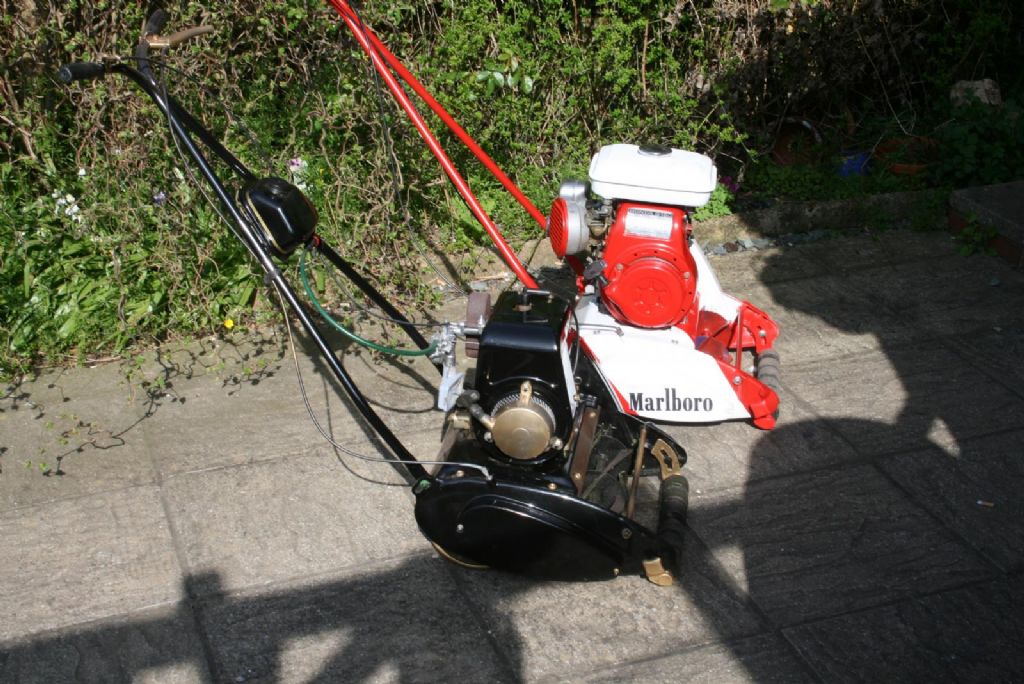

                                    Here's my John Player Suffolk ….and my Marlboro Honda Suffolk conversion….midlife crisis maybe? blush Don't tell anyone…
