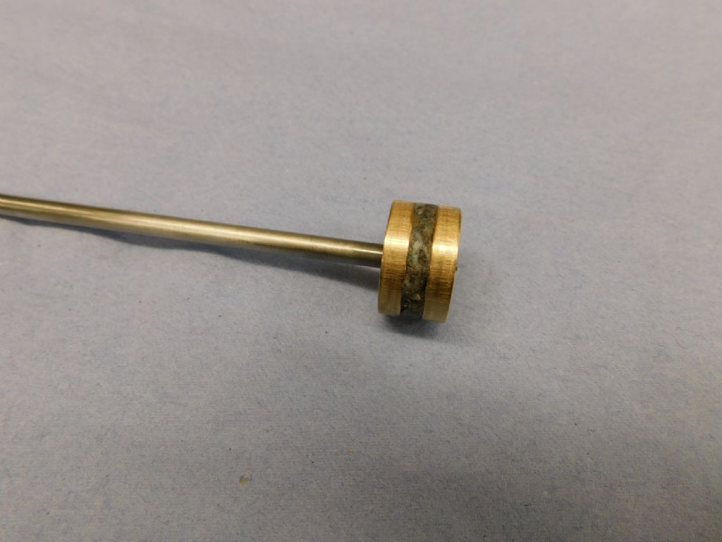

      i am well on with my uss monitor engine and would like your opinions on the best material for rings in bronze cylinders gary

          I have used square section PTFE impregnated yarn packing on all my engines with very successful outcome. Unlike an 'o ring' which needs to be just the right fit to avoid friction or be just too loose the packing can be fitted to a piston with a good two thou annular gap undersize and still provide superb compression.
          If an engine is to be run on steam pure PTFE can swell and grip and sometimes seize but the yarn does not appear to have quite the same result. I ran a twin Victoria on steam for many years as such without any such effect.
          Personally I like it because of the relaxation of tolerances on piston and liner and in the piston groove itself plus the fact that its virtually friction free which makes for a good slow speed on low pressure. Its ability to fit any slight discrepancy in concentricity is a bonus as well.
          Unless I was making something that was going to work hard on steam – and all engines made so far now just run air – I wouldn't use anything else because of these reasons.
          There is some very nice looking pure PTFE braided square yarn – it's not a suitable alternative as it frays easily and does not compress very well. Bought some for the last build but quickly reverted to the impregnated yarn
          Hopes that 's of use to you

            What do you intend to do with the engine? run for display only or make it work, on steam or air?
            I've gone over to Viton O rings for both IC and steam although the later only get run on air for display, with the right sized groove I get minimal stiction and a good seal
            Infact if you just want it to run slowly on air for display or even steam you could get away with no rings, thousands of Stuart 10 V & H engines can't be wrong.

                Your piston ring looks great. Where do you obtain that ptfe impregnated yarn? My search has only come up with what I think is the braided ptfe.

                        Thanks for your post Ron. I was about to suggest ebay or Blackgates but decided to put it in Google and found this. It may be more than you need but for it's length its definitely, I'd go so far as to say extremely, good value over other suppliers – Just ordered some for myself wink
                        If you do go ahead – just make the groove a couple of thou wider than the yarn and a couple of thou shallower, no need for precise dimension, as the material will fill and bed in to give a very friction free but superb seal.
