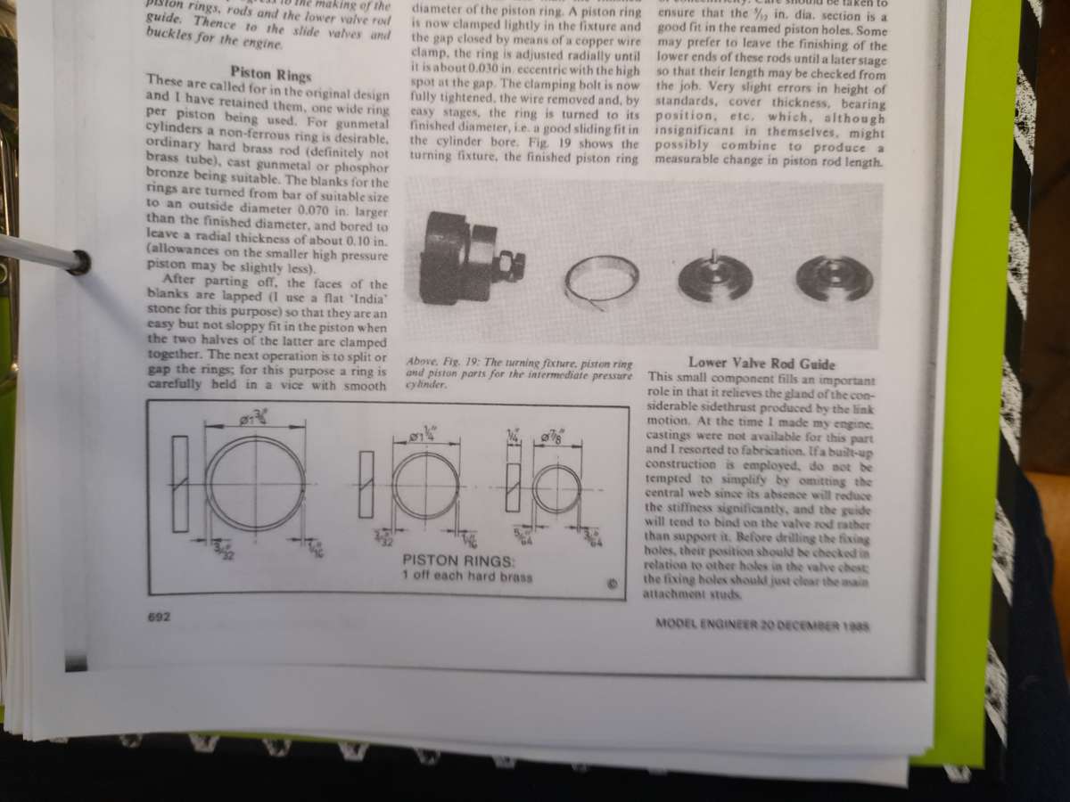

      Looking at plans for a stream triple expansion engine, the piston rings are machined elliptically. Unlike IC engines. anybody know why ?

              Does it actually describe them as being made elliptical or does the drawing simply show a round machined ring in it’s “sprung” shape? As they may not be round when the gap is opened up and heat treated. What is the engine?

                  The piston ring dimensions. There is also a jig shown on how to achieve these dimensionsPiston rings
                  #688094
                    That looks mor eeccentric than elliptical.

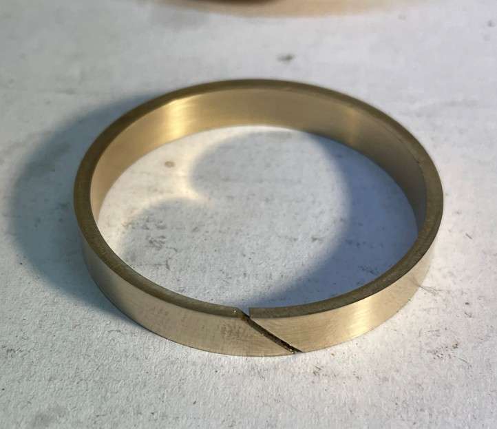

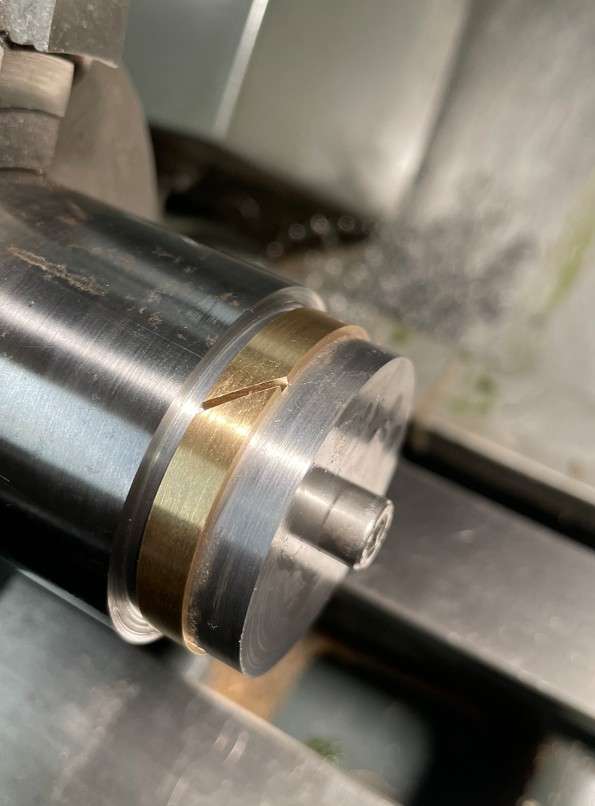

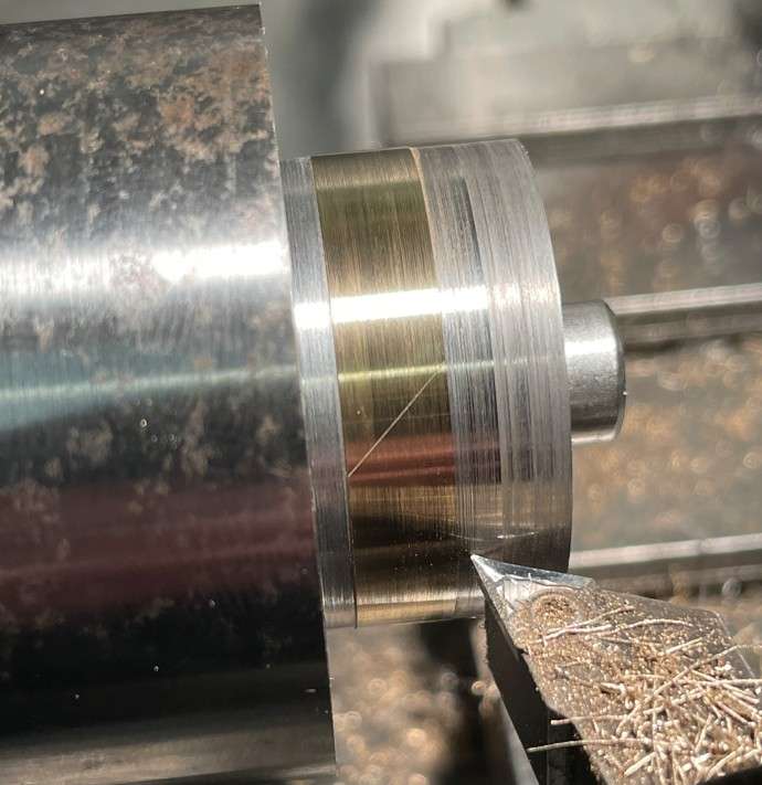

                            That is the Bolton Triple, something I am still making – 3 years so far – the part count is 1,248 including studs and nuts. The piston rings are not fun to make especially the for the HP cylinder which, per the drawing was far too strong. You machine a (brass) concentric ring with the outside diameter larger than the bore size, cut the ring slit at 45 degrees (holding is not easy, I slit mine on the lathe). That slit or ring gap eventually creates the radial ring load. Then starting with the LP ring, turn a finely made mandrel and a 5/16” thick clamp washer you clamp the washer up to hold the ring firmly but not tight then attempt to wrap wire around it to compress until the slit fully closes up (I used stainless wire locking wire). Then you set the ring to give you the required eccentricity as measured with a DTI (where the wire gets in the way) then clamp the washer up fully, check eccentricity again and then machine the outside diameter to match the cylinder bore size (noting the mandrel O.D. has to be say .010” smaller than each cylinder size, so start with the LP ring and work your way down. The eccentricity is now on the inside with regard to the bore but there is clearance in the ring gap of the piston halves.

                              ScreenHunter_7793 Nov. 07 13.58
                              ScreenHunter_7794 Nov. 07 13.59
                              ScreenHunter_7795 Nov. 07 13.59
