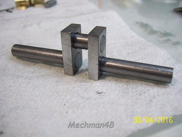

                                  IIRC I assembled my S10V with Loctite & then pinned from both sides, so …
                                  … 'b, Better to use 4 pins that go from side to side rather than two long ones end to end' …
                                  ​you can just see the pin on the right hand web, bottom, where it just didn't blend in enough…
                                  George.
