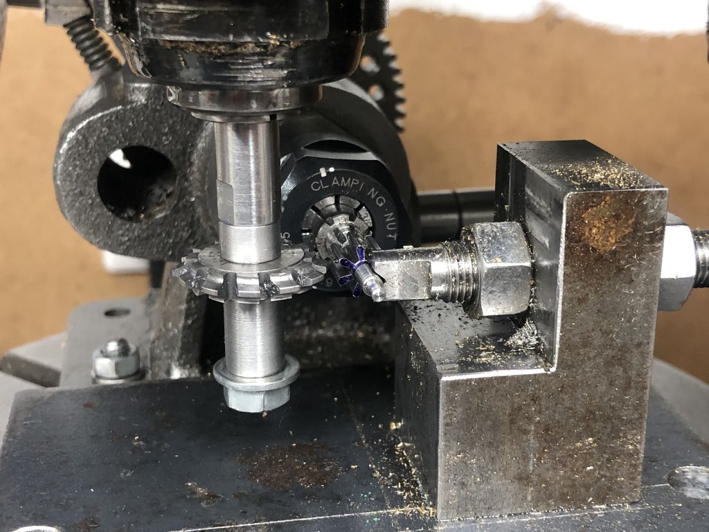

              With some embarrassment I have to report that I have solved my pinion cutting issue.
              After reading all the advice it appeared that pinion blank size and cutter were correct.
              I then realised that the tooth space on the pinion was wider than the cutter teeth. On checking the wheels I had previously cut the cutter fitted perfectly into the tooth space.
              On checking the cutter arbour I found it was bent. This must have happened after I finished cutting the wheels.
              New arbor made and now the pinions look much better
              Once again many thanks to all who replied to my question

                          #634603
                          Andrew Knowles 2
                            @andrewknowles2
                            Hello All
                            I have been meaning to post a picture of my pinion cutting set up for the last few weeks
                            I have now managed to produce some reasonable ( in my opinion ) results with the help of all the comments I have received. Today I have got the going train completed and it runs !!!

                              #634613
                              John Haine
                                @johnhaine32865
                                Andrew, I like that v-groove "tailstock" support.
                                #634617
                                Sam Stones
                                  @samstones42903
                                  And the direction of cut, even if the spindle is running in reverse!
                                  Or are my eyes deceiving me Andrew?
                                  Samsmile d
                                  #634625
                                  Andrew Knowles 2
                                    @andrewknowles2
                                    Sam. Well spotted I run the spindle in reverse so I can have the cutter in front of the work to make it easier to see what is going on.
                                    Easy to do on the BCA just put the belt on the motor the other way around
                                    Andrew

                                      Sam Stones
                                        @samstones42903
                                        It wasn’t so much the running in reverse Andrew, it was more to do with the possibility that the bolt would unscrew, and perhaps why the arbour was bent.
