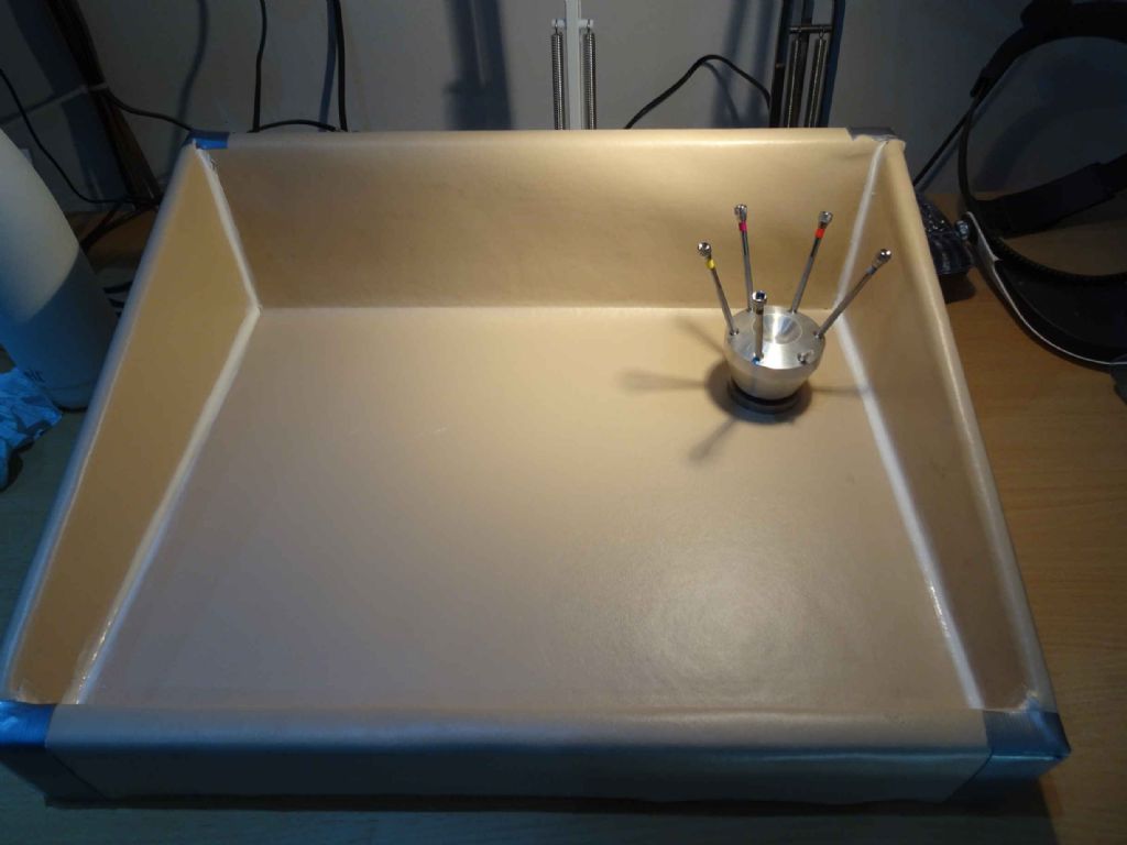

                                        Thank you all for your feedback on this. In the end it was Dunelm to the rescue!
                                        It turned out that there was a Dunelm more or less next to the Ten Pin bowling I took my son to for his birthday.
                                        I found some soft-backed leatherette (some kind of light felt behind the leatherette) and as a bonus there was a 'surface protector' (a chopping board with a raised edge) which I thought would make a good base.
                                        A bit of melamine shelving, some ply and some PVA and here's the result!
                                        Oh and some bathroom sealant to hide the gaps! I've not tried it yet, but I have high hopes!
                                        Iain

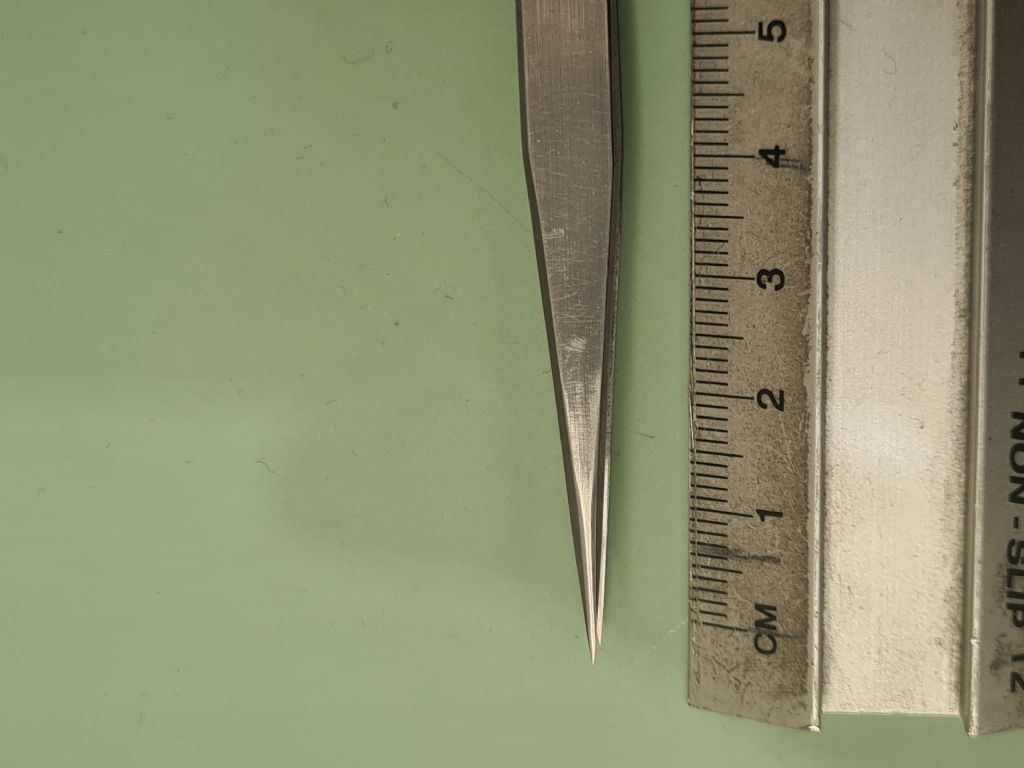

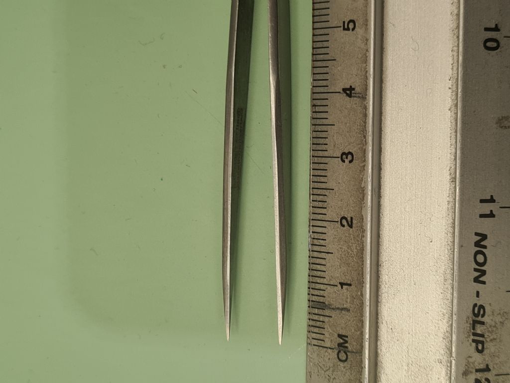

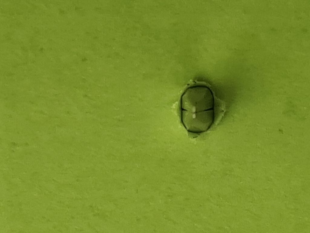

                                            As has been said you do NEED to dress your tweazers regulatoly – preferably just before you start pinging! ( I even dress brand new, out of the box tweazers befofore use)
                                            Carefully examine your tweazers under a good glass.
                                            ALL the edges should be crisp & flat with sharp right angle corners.
                                            The inside flats should meet parralel & you have to learn how little force you need to grip.
                                            When viewed end on the points should be a fine oval cross section, from the top they should come to almost a fine point & edge on, with the tweazers just closed a slightly broader one.
                                            As a test of your dressing it should be easy to pick up a fine hair off a glass plate.

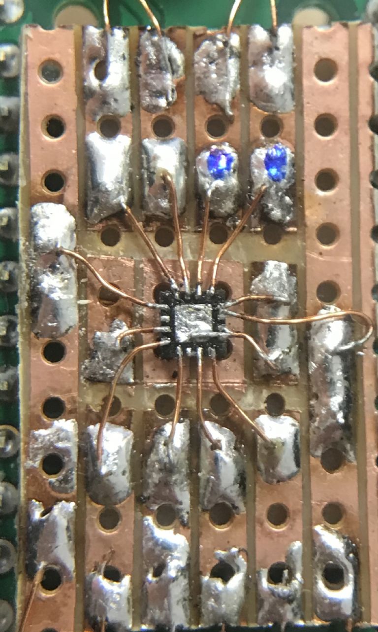

                                                I also do surface mount prototyping and rework with the same tweezers :
                                                That’s on a standard 0.1” piece of veroboard and I had to hand place and solder those connections…
                                                Better magnification is more important than tweezers that cost 30 odd quid each – *provided* the tweezers you use are good enough.

                                                  Hi, Adrian. I don't suppose you have any photos of your ideal tweezers. I think I get it but a picture paints a thousand words…
                                                  Thanks
                                                  Iain
                                                  #596713
                                                  Adrian Downes
                                                    @adriandownes83818
                                                    #596714
                                                    Adrian Downes
                                                      @adriandownes83818
                                                      A few quick ones for you 👍
