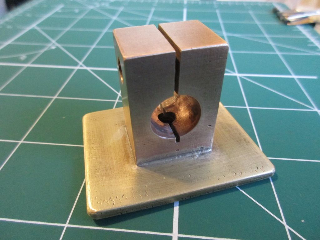

      Hi Adrian, there maybe some truth in what you are saying. When I silver soldered this Ali-Bronze block to a Brass plate at work back in the early 80's, I dunked them (I made two of them) in the companies 70% sulphuric acid storage tank for a little while and when they came out, they were all nice and shiny brass and bronze, the silver solder was nice a clean also and no hint of any pink, however the acid was at best only 18 C. Of course I dunked them into a bucket of clean water before I handled them and had my PPE on.
      Regards Nick.

        But I read it as a study into enhanced de-zincification, that is it shows adding Oxygen in the form of Hydrogen Peroxide, increases the rate and penetration of de-zincification. In other words, adding Hydrogen Peroxide makes an acid pickle even more unsuitable for use on Brass.
        I guessed Hydrogen Peroxide was a bleach, but from this paper it seems adding Hydrogen Peroxide to an acid pickle makes it stronger, so well worth trying Peroxide on Steel or Copper. But definitely not on anything with Zinc in it, like Brass.
        Nicolas mentions success with 70% Sulphuric Acid. Yes, because Zinc, and other metals, don't react with Concentrated Sulphuric Acid. Water is needed to release the ions necessary to the reaction. Counter-intuitively, although concentrated Sulphuric Acid can be stored in a steel drum, dilute Sulphuric Acid attacks it.
        What's needed in a pickle is a mixture that removes oxides and other crud whilst leaving the underlying metal well alone. A tricky balance.
