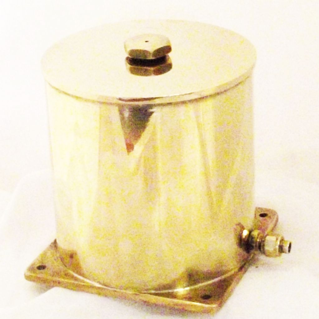

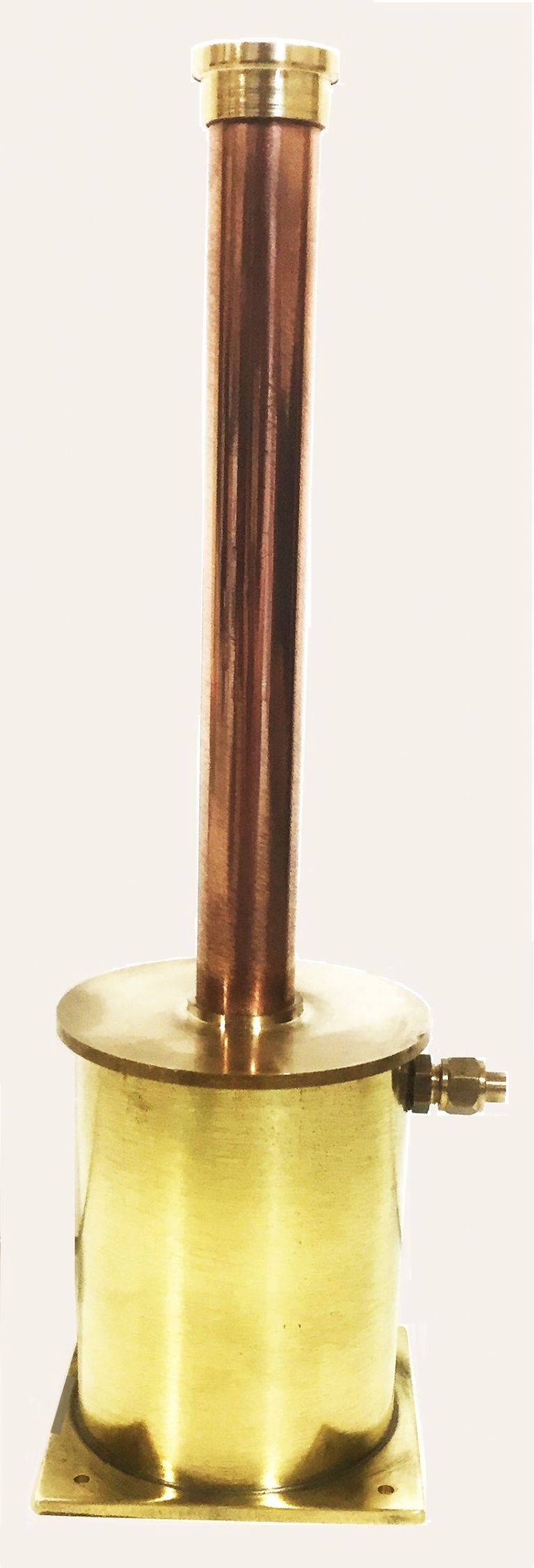

                            I absolutely do not put brass into the pickling tank. The pink 'residue' isnt a residue at all, its the inactive copper left over when the Zinc has been removed. The only way to get it back to colour is to abrade the Copper layer away until you hit the brass underneath. I tried every way to avoid this but found none – citric acid does the same as other acids, it just takes a lot longer. All of our brass products are now de-scaled by hand. If anyone has a genuine proven alternative I will be the first to embrace it as I hate brass dust!
                            #466592
                            nigel jones 5
                              @nigeljones5
                              This is an early example of a tank which had been lightly pickled, never could get rid of the hint of pink
                              #466593
                              nigel jones 5
                                @nigeljones5
