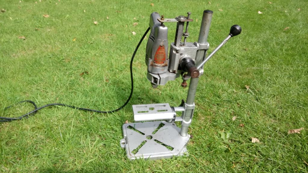

            #313946
            Clive Turnbull
              @cliveturnbull59507
              All done, not exactly state of the art! Working well anyway and earthed! Better than lying around in cobwebs and dust.
              Thanks for input and advice.
              Cheers
              Clive
