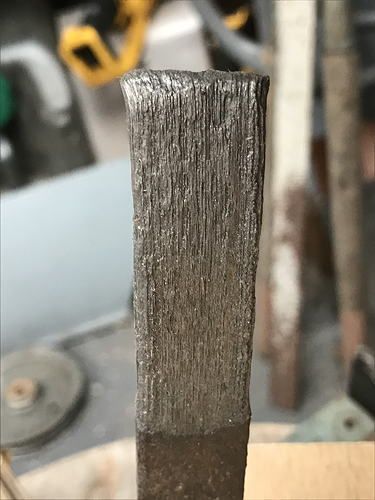

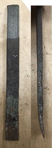

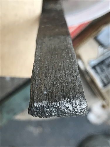

      Ok this is probably of little interest to anyone but nonetheless
      Have this old fragment of (what now appears to be) wrought iron. Been using it for years to open paint tins, lever out nails etc. You know the sort of thing.
      Recently decided to try clearing rust off a section using Phos. Acid. (light grey area in above photo)
      24hour immersed in acid reveals interesting striations in the structure of the metal – once the rust is 'dissolved'.
      (I believe this is consistent with old wrought iron)
      Will probably do some follow up exploration on this. Should it be of interest I may post more photos.
      Regards.
      Frank C.

          I have one of these, though probably of high-carbon steel.
          It might indeed have been simply a small crow-bar, but alternately could have been a "lewis" chisel – a stone-trade tool.
          The "lewis" is an old tool for lifting blocks of stone, consisting of a double-sided wedge placed between two single-sided ones, all linked by a shackle-pin, into a mortice-like socket cut into the block by using a chisel of that shape.
          The curve allows the mason or quarryman to cut the hole with the necessary vertical or inwardly-diverging, sides.
          If wrought-iron it would not held an edge for long used as a chisel, though for centuries that was the only "tool-steel" available; apparently amenable to a degree of very crude hardening. It think it would more likely have been used on soft "freestones", rather than on the very hard, coarsely-crystalline, igneous rocks like Cornish Granite or rough stuff like conglomerate.
          "Freestone" is a trade generic for, those rocks that are easy to cut in all directions when "new", though slowly harden by weathering. Most are species of limestone and sandstone; but the locally-quarried, slightly pumice-like volcanic lava used for the ashlar components of many of Exeter's old buildings may have been similar to work.

              Looks like wrought iron to me. You can often see the same grain structure in old anchors and similar things dredged up from the sea bed. My father had one where you could see the way the grain changed where the smith had fire-welded the shaft.
              My blacksmithing instructor in the 1970s said you can identify wrought iron by the smell, because it's all so old…

                I had the same pattern happen on a small handrail bracket for a 5" gauge tender. The bracket was steel, and I left it in the acid overnight by mistake.
                It came out looking just like that but on a much smaller scale.

                    Different materials have varying reactions in phosphoric acid. I only paint it on not dunking things and sometimes it 'gells' almost immediately and sometimes does nothing, depending on the material, carbon content, presence of rust etc. After half an hour-ish I washi ti off and then get the grey appearance and milky white water. IN damp conditions I can get the grey in advance.
                    The striations in some wrought iron are the result of the old methods in an open hearth furnace which involved mixing in more iron ore. This produced a lot of slag mixed into the bloom which along with the oxide that formed on the surface of red hot iron as it was rolled gets pressed into the material. I think it is a characteristic of the metal being rolled into thin sections rather than the drawing that is now used,

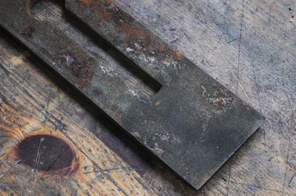

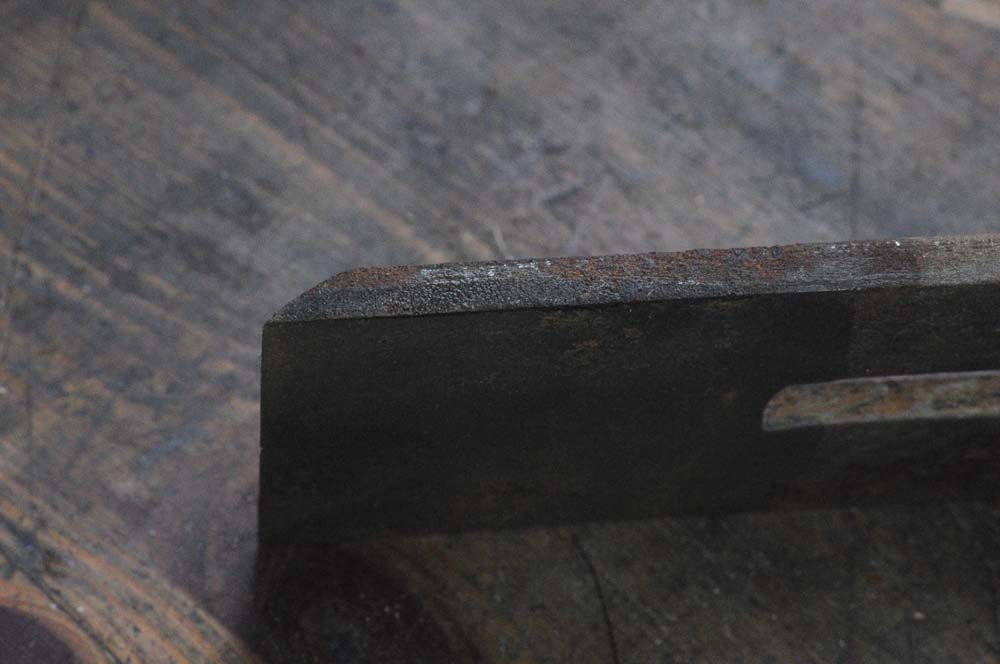

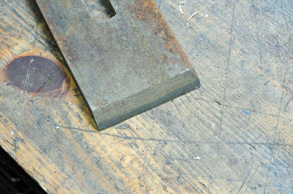

                        This old plane iron had the phosphoric acid treatment a considerable number of years ago;
                        What I find interesting is that you can clearly see where the expensive cast/crucible steel cutting edge has been (presumably) fire welded to the wrought bulk of the iron.

                                      If Frank's object isn't Wrought Iron, I'll eat it!
                                      The structure is due to the way the Iron was purified by repeated hammering.
