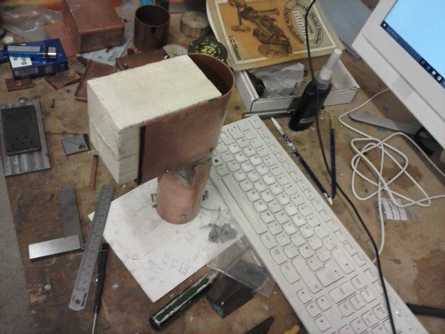

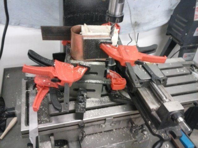

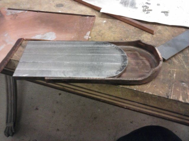

          went with a simple wooden block in the end and glad I did..the free edges so soft. I set it up in the mill in the 'shonkiest' fix imaginable with external edge support too and milled the back parallel with the tube front.
          I had a bit of a disaster with trying to mill the bottom back 90deg to the back edge and to size – again soft edges that I thought were supported enough but they distorted – so that was hand filed but again needed the block for support in the vice. I'll tidy up some of the worst of the x/s silver solder then on to the next stage.
          If I end up making another then it'd be worth a full-length barrel block and a wrapper block just to support without risk of flattening or bowing. it's just the nuisance sawdust making it. I didnl;t have to make the rounded wrapper part as a block since that was on-size to sl undersize with the angle error. Standing it on it's firebox end on a flat surface can just slip 1 thickness of paper under the domed edge of wrapper. the backhead should take care of all that….

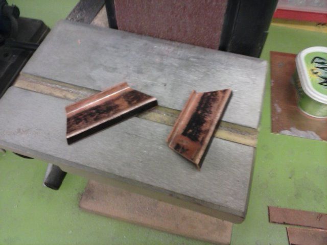

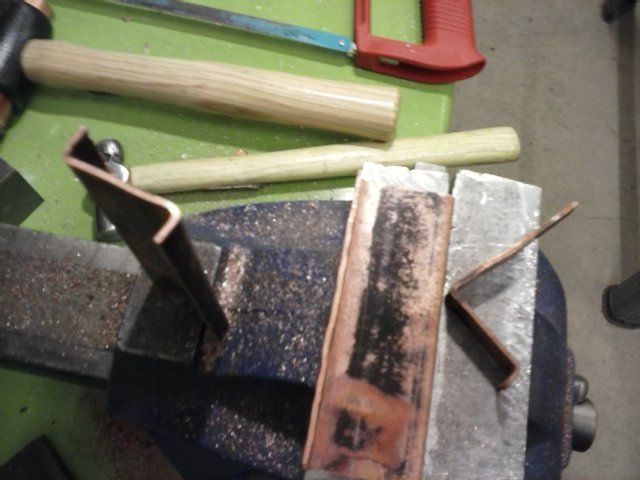

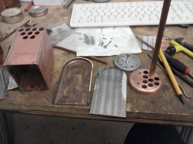

            Next up was the crown stays. Once again i found this hard. mason casually states to clip the firebox to the throatplate with a length of foundation ring as spacer, align and then bend up a thin test piece as template. I think it was some 2 hrs of fiddling and wishing for an extra hand before I achieved a good grip with vicegrips that actually positioned the firebox correctly and another hour of trial and error to bend up my template.
            the actual cutting out, marking and bending of the stay blanks was the next session after letting my brain dwell on how best to do that. At least that went relatively quickly.
            I bogged up a little on cutting the angles back and should have left them slightly sloppy because they won't be seen. Instead i evened them up cosmetically and ended up pretty but slightly shorter than per plan on the top edges. I don't think it matters.
            Marking out and drilling is straightforward though I did decide the place them marginally closer than per plan in case of distortion to make sure there'd be clearance for the long stays.
            but overall a whole evening session just shaping and bolting up. I'm happy enough with the end result and it looks like it sits correctly. There may be a thou discrepancy between the two stays in height. I may run a file over them after soldering if necessary but they may pull down on rivetting anyway.
            This is a slow job in my hands.
            Next I need to make up the smokebox tube plate.
            Turning a 1/4" thick disc from plate would be a pain…without being able to bolt through it'd either be glued to a back piece (always risky) or just jammed by the tailstock =- unless there's better ideas out there??
            Since i have scrap round ally bar I've been using on this project I'll turn a length of that down and part off 1/4 in and see if I can form around that without denting it. The copper will be roughed out and filed to a starting disc…

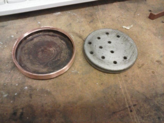

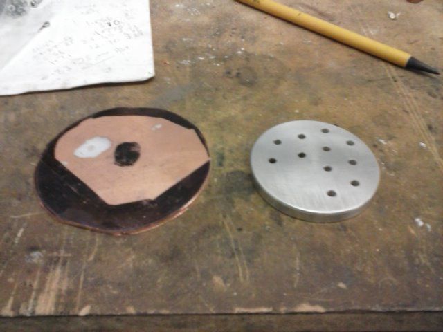

              I started on the smokebox tube plate. For a former I trimmed down a section of my scrap ally bar I've been using and parted off 6mm. Annoyingly i parted down some 3/4" off the radius and then got a dig-in and stalled the lathe. I was able to recover by sawing through and facing.
              Mason suggests drilling the tube hole starts after forming and using the firebox tubeplate former as a guide but i chose to make up the guides in the smokebox tube former… but then Mason didn't have a DRO.
              Then a case of roughing out a circle of the 13g copper and the usual anneal and bash. That went really well..my neatest flanging to date.
              the problem came in trying to remove the former. Mason casually claims to scrape around with a sharp end of file and tap it out. I tried that. I also tried freezing, heating to red, scraping some more, teasing with dental scaler tools and facing back to the ally and then using a tip tool to cut a v-groove into the edges of copper and ally and finally using my predrilled holes and a drift to rotate the former in the disc plus leverage…. about 4hrs of pratting about to get it out.

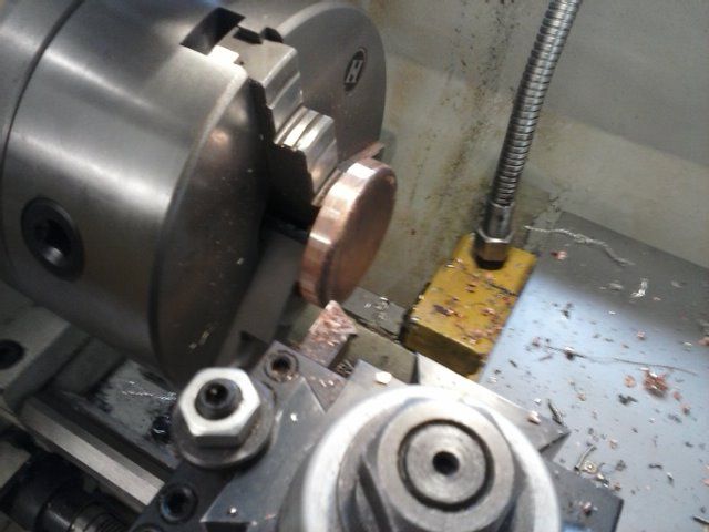

              Turning the outside for a good fit in the boiler tube was also problematic for a novice. i didn't want to over tighten and damage the disc and whenever it got hot from light skimming in the lathe it tended to fall off the chuck. Eventually i got the hang of how tight and when to tighten further as it heated up. Just the holes to drill.
              #266507
              Ian S C
                @iansc
                The last bit about turning the disc to size, make a little plate with a center hole in it, bring up the tail stock with a center in it, put the plate against the disc, it wont fall off now. Ian S C

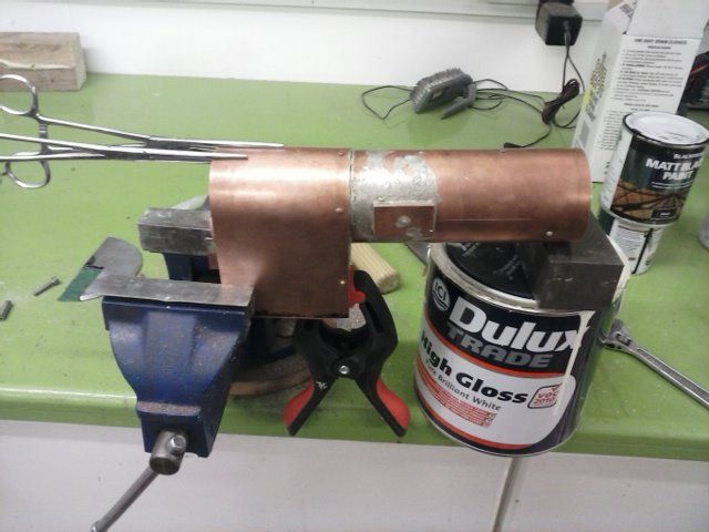

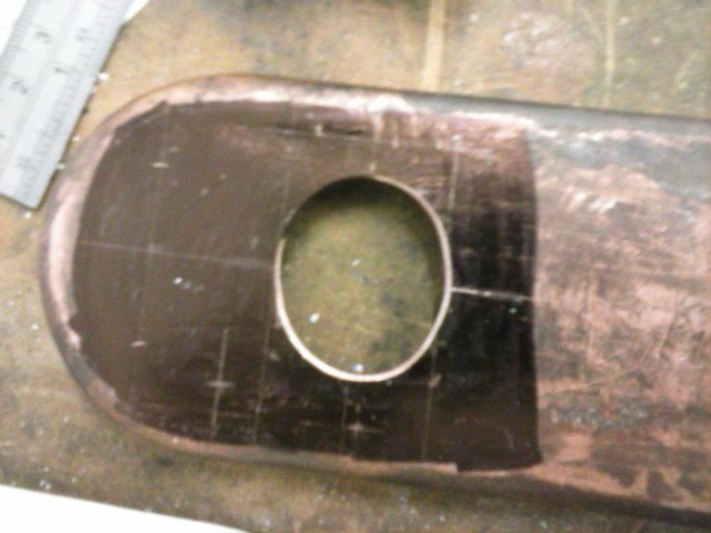

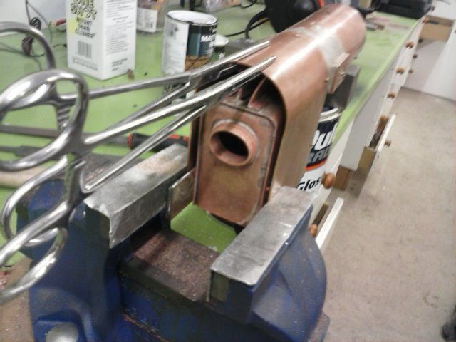

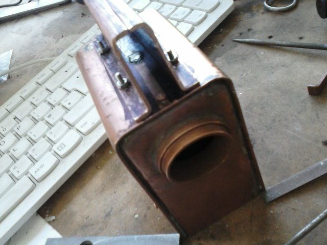

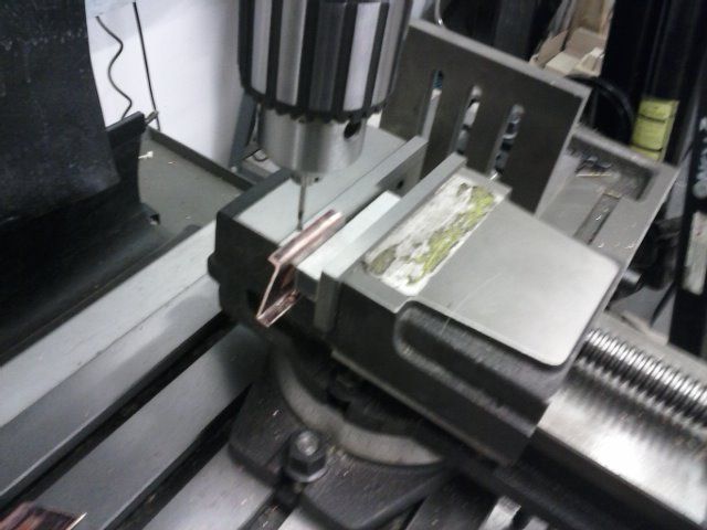

                      Update: Three steps forwards and two back…all part of my slow learning curve.
                      I rivetted the crown stays on and made a bit of a hash of it. I'd used a section of steel leftover from making some tool holders inside the firebox. The large flat end sounded like a good idea at the time but rivetting into countersinks necessarily means hammering more around the rivet. That and lack of clearance at the end I was peening gave less control. I was using a piece of rod between rivet and hammer. End result was that I flattened/dented the top of the firebox a bit more from it's natural bends – if that makes any sense. It is usable and it has increased clearance for the tube stays but is less aesthetic – not so important when hidden under the wrapper except i know. Soldering went OK. Next time I make one of these I'll use a focussed support inside… a piece of rod with a small divot for the rivet head and a DIY thinner rivet tool above.
                      I've also flanged up the backhead piece and also with great care and concern about drilling thinnish copper I've drilled and reamed the firebox tube plate. I didn't want to risk ruining my only 23/64 drill by regrinding for sheet material and messing that up.
                      Then i started opening up the holes in the smokebox tube plate and totally bogged it up – didn't notice it cant on it's supports while reaming and reamed an oval hole – Doh! I've flanged up a new one after making a new former. Again a pain to get the former out.. I had to drill and tap for an M3 screw to give traction for removing it.
                      Hopefully I'll finish that without more errors later today.
                      I've been deliberating what diameter solder to use for rings of solder around the tubes when it comes to brazing. I think I'll order 0.7mm wire for that unless any experienced suggestions otherwise?

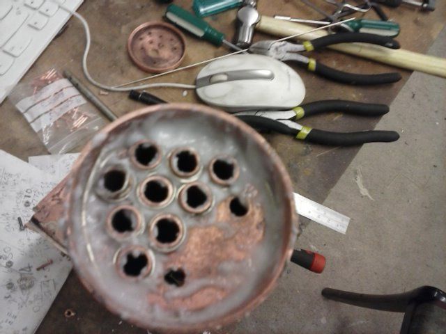

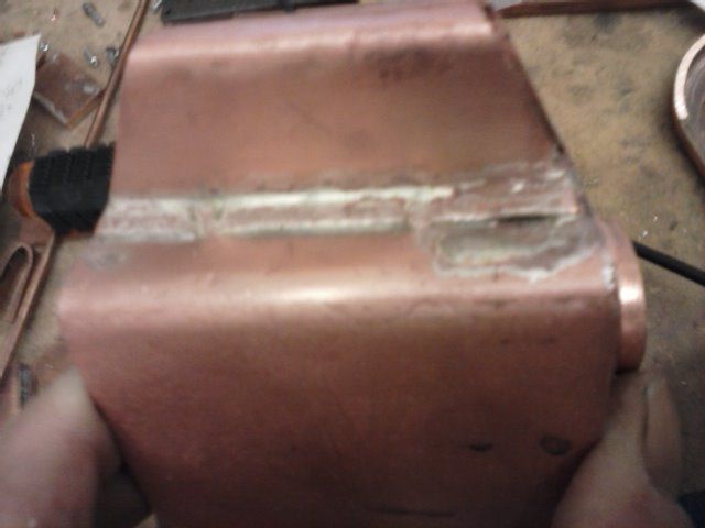

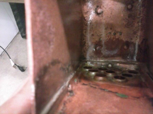

                        Some update pics… second attempt smokebox tubeplate and backhead flanged. Also a pic showing the screwtapped into the smokebox tubeplate former to remove it. And thanks to Ian I used his advice for turning that plate to size.
                        #267608
                        julian atkins
                          @julianatkins58923
                          Hi pgk pgk,
                          It usually takes me 2 attempts to get the crown stays silver soldered to the inner firebox wrapper, in each case without the rear inner firebox flanged plate attached.
                          In your above pics you appear to have attempted this with the rear inner flanged firebox plate in position and silver soldered to the inner wrapper – though this isnt clear. If so, it would not be the recommended proceedure. The pic is not clear but there appears to a want of heat and blobbing of silver solder which hasnt run into the joint.
                          However this is only a guess from the blurred pic.
                          On my my first boiler I used 1.5mm dia rings on the water side ends of the tubes abutting the firebox tubeplate. Excessive, but went ok. (I had nothing smaller in dia of silver solder at the time).
                          Cheers,
                          Julian

                          pgk pgk
                            @pgkpgk17461
                            Julian,
                            All comments,criticism,suggestions welcomed. I was following the book. Indeed in't'book it suggests that experienced builders might solder the firebox and crown stays all in one session. In fact I did the firebox in two sessions ten another for the crown stays.
                            Your are correct that one end of one stay has a section at the end that isn't soldered down well which is why there's an extra blob between the stays where i tried to add more flux and solder during cook-up but it wouldn't run in. The rest of both stays has 'stuck' OK and the thing had a second pickle and cleaned up a lot better since that pic was taken so I was going to let it go? I'd stupidly left sl too much gap with my bad rivetting so to correct it I'd have to pack with fluxed chips of copper if you think i should re solder? I'kk try to get around to posting a cleaned up pic.
                            I was thinking 2 turns of 0.7 wire round the tubes… 1/2 the volume of 1 ring 1.5 and i can (hopefully) wind a length of the wire round a rod springwise and have neat coils packed down.
                            pgk

                            pgk pgk
                              @pgkpgk17461
                              Julian,

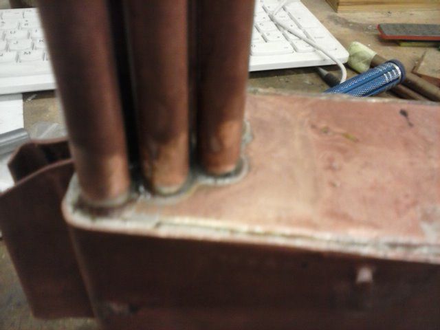

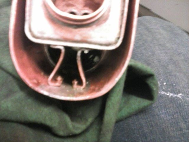

                              This pic is better representative. There is a 1cm void at the end where I'd dented the firebox roof in rivetting and that end rested up on the back plate and unseen under the flux the gap was too great for capillary draw. The rest of the crown stay edges are silver filled.
                              #267814
                              julian atkins
                                @julianatkins58923
                                Hi pgk pgk,
                                That is a much better pic, and I would pass it, especially as my last boiler has webbed feet on the crownstays to the inner wrapper. I also always add large holes through the crown stays to help circulation.
                                My usual practice is to silver solder the inner firebox wrapper to the tubeplate, then silver solder the tubes in position, then do the crownstays to inner wrapper, then silver solder the firebox doorplate to the rear of the inner wrapper.
                                You are going to have fun and games trying to silver solder the tubes applying heat from within the box with the firebox doorplate silver soldered in position. The flame will probably go out continuously, and you risk disturbing all the joints already done.
                                L C Mason didnt have much experience of building miniature boilers, and the usual practice used by LBSC, Don Young, and Martin Evans for loco boilers seems to have been lost on Mason.
                                Cheers,
                                Julian
                                Edited By julian atkins on 21/11/2016 23:48:03

                                  I bow to greater experience. So far all the firebox parts are 38% and the tubes will be 55%. the flame going out has been a problem at times already..mostly getting too close to the work. I hope that directing heat into the enclosed firebox will concentrate it on the tubeplate underside. I'd guess that with the doorplate not there it'd still have to sit on that end on firebrick with tubes vertical???
                                  It's reassuring to hear you accept that unattractive crownstay.
                                  I'm at the stage now where I'll finish this boiler even with faults (if they happen)… just to learn all the remaining wrinkles in case it does come down to a third (and final) attempt.

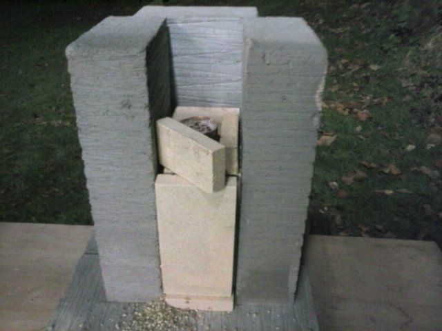

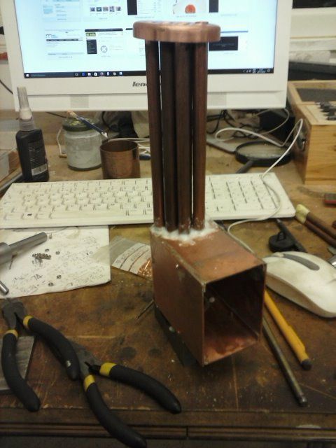

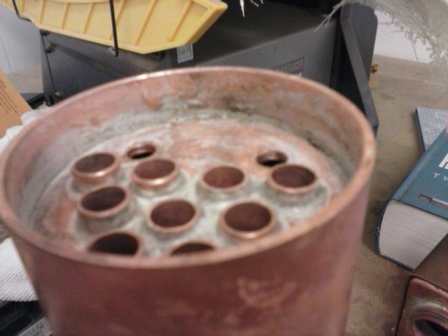

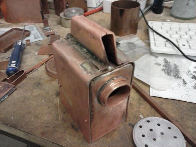

                                    I took a few days out from the boiler build to enjoy some machining and knocked up a simple imperial tailstock die holder and also made myself a (yet to be tested) tap alignment holder: that's simple enough too – it's a length of round bar with a sliding centre hole onto another bar to be held in mill or tailstock chucks. The working end is a cheapo far east small keyless chuck. This one came with a threaded insert 3/8 x24tpi to it's hex shank. Originally I was going to single-point a 3/8×24 new fitting but discovered the shank was soft enough to turn down and thread 6mm. As it happens i wrecked my cheapo die and single-pointed the metric thread anyway.

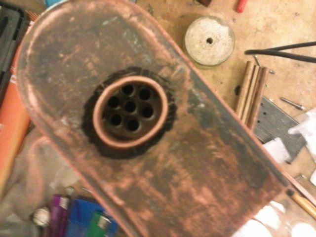

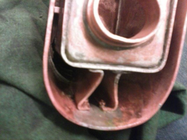

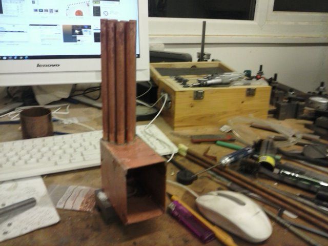

                                    Back to the boiler. Boiler tubes all parted and faced and deburred to length. I'm on a roll so used off-hand ground hss tools at 840 rpm – quick and slick.

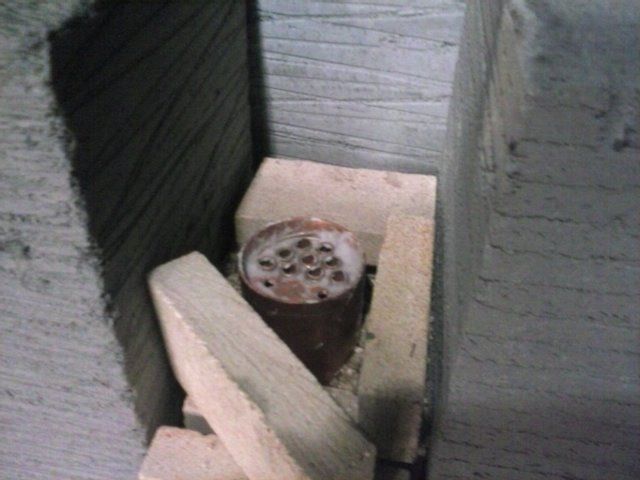

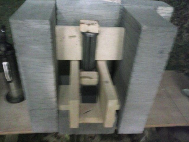

                                    I decided to make my solder rings from 0.7mm wire. It was wound around a handy 7mm rod (to allow for spring-back) and then cut individual rings off that and used 2 per tube. I probably overdid the HT5 flux – but better too much, eh?
                                    The cook-up went well. A pic of the hearth arrangement: Sorry-blurry at night..
                                    And simply blew the heat up the open firebox part and between firebox and firebricks at the side. I could see the colour creep to the tubes until they were bright orange to about 1" up. It was hard to see the solder actually melt within the flux.
                                    Then into the sulphuric acid bucket and abandon my shed until it vented the obnoxious vapour.

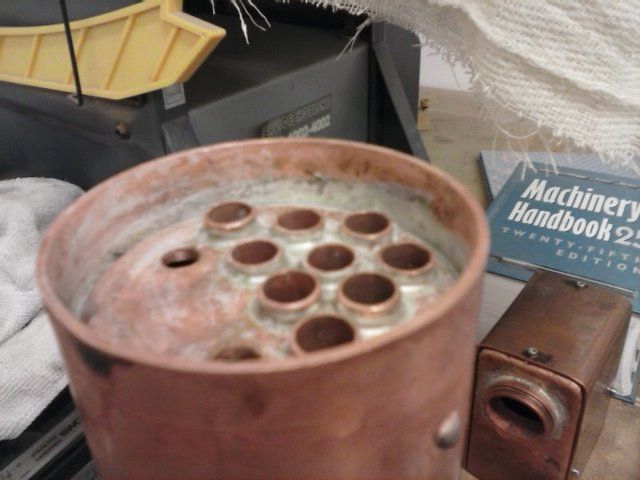

                                    Dodgy phone pics again but the solder has come through to inside the box and rung every tube. their fit was tight enough i had to tap them in with a light hammer. externally a ring around each tube that fills the slight countersink proud. I'm happy with this phase.

                                        Another frustrating session. it started easy with drilling and threading the smokebox tubeplate stay holes. And then … I got the firebox clamped in position and drilled the crown-stay rivet holes. It's difficult to mount it with clamps in place so ended up in the bench vice and a cordless drill… which worked OK…fine punch marks, spot drill and drill to size.
                                        The problem came with trying to rivet the rivets. Mr Mason suggests a short bar in a vice under the crown stays to support the rivet head, Unfortunately I'd had to slightly splay out the crown stays and S them to get clearance on the tube into the barrel. It'd all looked OK on test fit – or so I'd thought. That made it difficult to get a support bar under the rivet heads.. and i spent a few hours fiddling and filing bars to fit etc.. and failed to get a good rivet going. Sometimes an extra hand would be nice….
                                        Eventually i decided that my temporray s/s bolts work so perhaps a copper bolt. I threaded a rivet 7BA and made a PB nut to match. It works except the fine thread strips on the copper. That was enough for today's session but I'm hopeful of success with 7BA PB bolts instead of rivets that i plan to make tomorrow…..
                                        #269779
                                          Your rivits on the boiler don't have to be formed that well, they really only need a tap or two with the hammer to expand the shank enough to stop them comming loose as they really only hold things in place until you solder the joint. Infact too tight a rivited joint can actually stop the solder flowing right in.
                                          Just flux up the rivits on the outside and solder them in at the same time as the stays. If you have the hole lightly CSK on teh outside they can be filed off flush after soldering to just leave a nice ring of solder in the CSK

                                            pgk pgk
                                              @pgkpgk17461

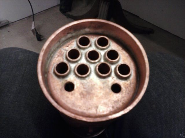

                                              I mentioned earlier that I drilled the crown stay rivet holes with a cordless hand drill. I have some pics of how I set up and marked those holes… basically by eyeballing the relationship inside and out compared to my artery forcep jaws. The holes came out pretty even.
                                              I did end up using my DIY PB nuts/bolts and they held the crown stays OK. Then fitting the smoke-box tube-plate..that was a fiddle – my holes were so tight that it needed progressive tapping down with assorted drifts then fluxed, solder rings – again 2 rounds 0.7mm each tube and a round of 1.5 for the plate itself. I was heavy on the flux again.
                                              For a hearth arrangement as shown.. and the voids filled with vermiculite so just the barrel top is clear
                                              It made cooking up easy except for the bits of vermiculite blowing about …messy and a torn up blanket might have been tidier. I obviously used too much flux.. had a big puddle of the stuff floating in there and had to blow the flame in the top as well to finally dry it and melt the solder.
                                              Insulation was so good that the crown stay flux was unaffected so when things cooled enough to handle (with the cheapo welding gloves) I repositioned and cooked that up too. I think i lost a bit of solder in the move 'cos one side of one crown stay looks bare but there's solder under it. I'll sleep on whether to recook – its debatable.
                                              Dropping that lot hot into the acid was exciting and not for the faint hearted or rash.. you can always wait for it to cool first…
                                              I'm pretty chuffed with the end results – certainly on the tube plate

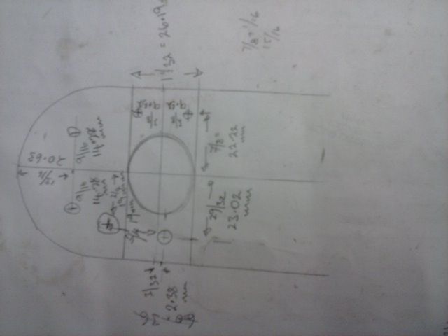

                                                  Tonights session was the drill and file the backhead firehole and test fit. Gratifying to have something go pretty well – perhaps I am learning smiley.
                                                  I'm sure we all work differently. I'm not much for marking out and don't have surface gauges or a decent surface plate (to be organised) and prefer to work off the DRO but this time I did mark it out fairly accurately just as a visual check against dumbo moves 'cos it's not the time to screw up.
                                                  Self evidently the firedoor hinges/catch have to be relative to the firehole centre but I was concerned that the centre as drawn and mine may not be exactly the same place and the long stay bushes should be relative to the firebox roof/stays and the smokebox tubeplate stay bushes. So some simple sums to work out the distance of those bushes to barrel and work that out relative to the crown of the backhead. It was to find that this time I was within 1/32 of the drawn distances so blowdown bush hole can be drilled relative to the firehole centre. A nice suprise.
                                                  I've also done my usual scrawl doodle of all the offsets and converted to the mm I run the DRO in.
                                                  I don't see any way that I'd manage to cook-up backhead, manifold and foundation ring in one session. I've also had some thoughts about the many stays that have to go in later that I need to run past the experts after the backhead is in. That'll be a separate message in a few days when I've mulled it over.
