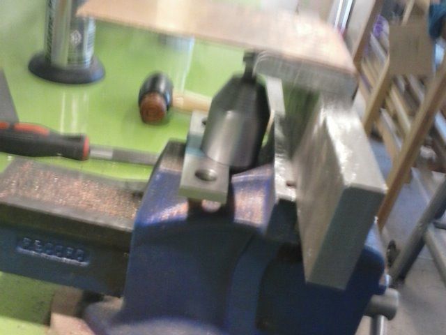

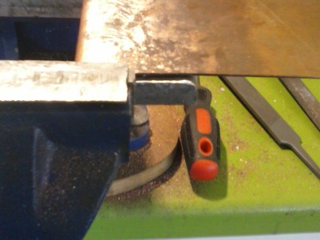

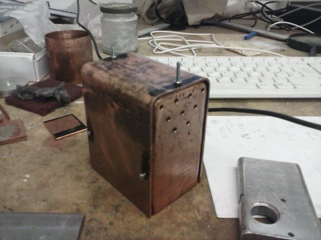

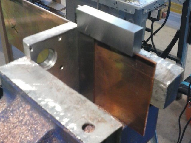

          The former I made was just for the top of the wrapper..flat with two curved corners. With the benefit of hindsight either a longer bar one could grip in vice and have clearance to make the bends or a solid block of timber to form it round. I didn't want to 'waste' a good bar nor start laminating up timber to make the block. I ended up with some shenanigans to use this former:
          Anneal the middle and working out where the bend starts and squaring it in the vice end.
          And getting creative for support to make the start of the second bend
          drilling for temp bolts was just a fiddle and faff and takes a long time while making sure everything stays square.
          It's now ready for an acid wash and scrub and fluxing and rivetting..hopefully tomorrow

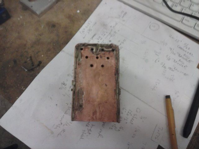

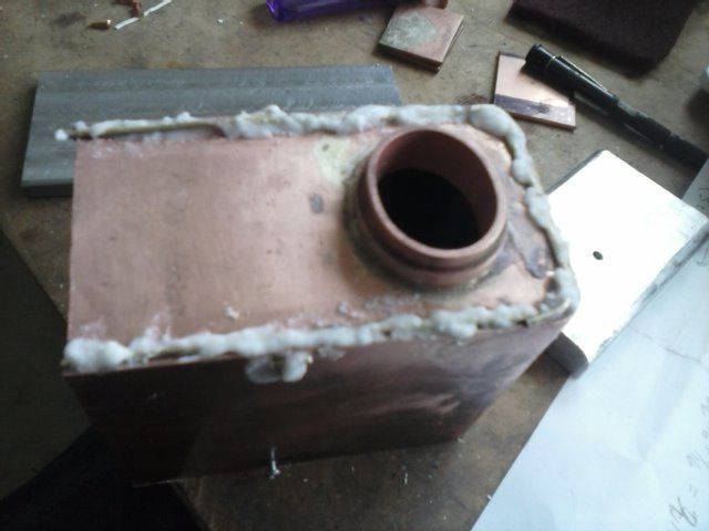

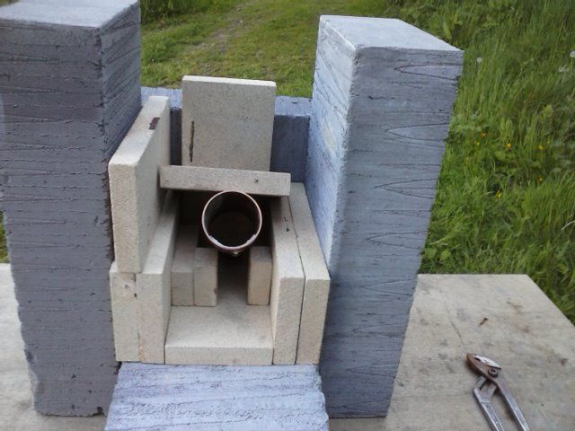

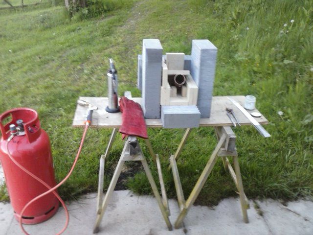

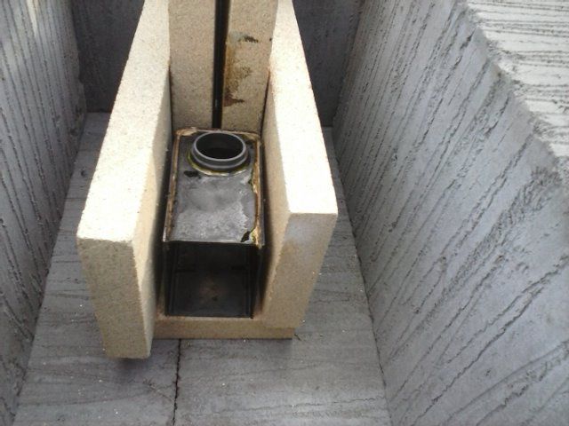

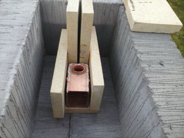

            Today started full of promise.. cleaned and fluxed and rivetted and laid 24% around the seam with a second piece each corner which were my weak points.
            You can see the hearth design for this… surrounded with vermiculite bricks and blasted the heat inside. It was my first daytime cookup and really couldn't see the flame or colour changes on the copper
            But after 3+ mins i could see the rods melting in as they should and being sucked into the seam. While the immediate post pic looks messy it cleaned up nicely.

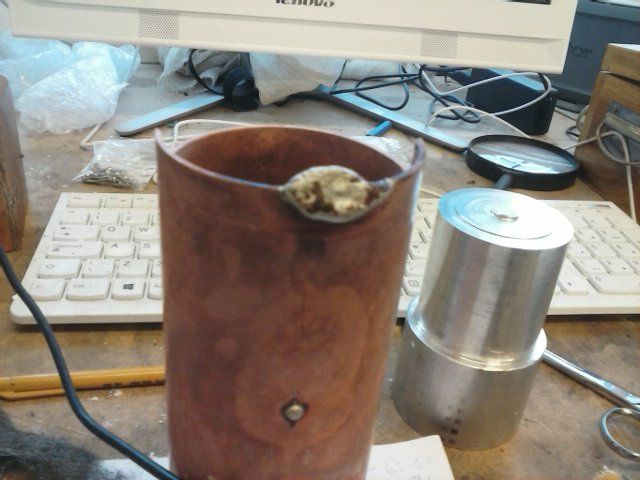

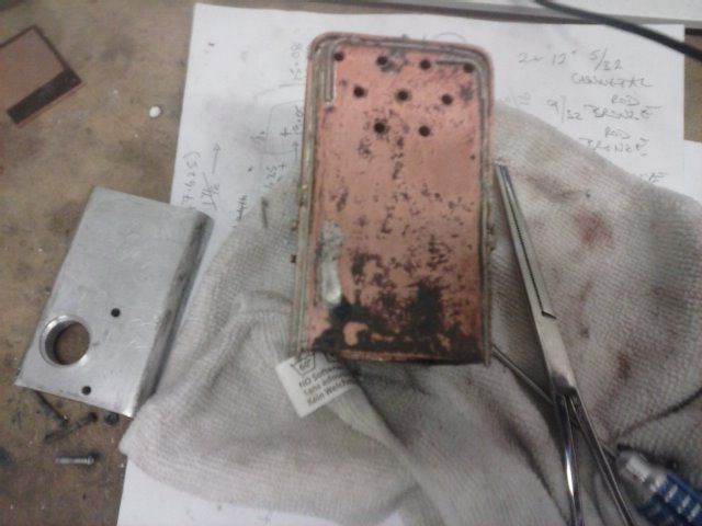

            The process was repeated for the other end as a seperate cook.. and did not go well..the same setup but just didn't want to get hot enough and then flux exhaustion. I did try running a little 55% fluxed rod onto it but it was turning into a mare.
            the pic shows unmelted rod bits stuck all wrong drifted from the corners and the seam rods unmelted as well.

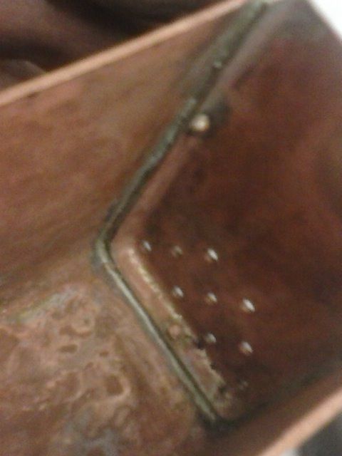

            I cleaned up and scrubbed the seams and went for a second cookup. This time I cut up a vermiculite brick to have a piece inside and another on top and the side bricks closer. Its till took a long time to get to heat and exhausted most of the flux but it did get hot enough to add fluxed rod.
            I haven't got pics handy and it's in the acid bath. I can see solder penetrated to inside but I'll have to scrub up and file off the mess before assessing this..possibly with a lower temp solder additional cook if needed.
            If i ever build another I may well avoid 24% but having started it's a case of being stubborn even if I have to start over. Once again the lesson to take home is insulate the outside as much as access allows

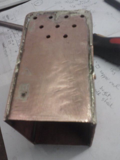

              I managed to clean it up.. filing the proud 24% was a apin ..so I hit it with the belt sander and while not pretty on that second side I've go a pic showing good penetration through the seam.
              The worry with the firebox is access to fix any leaks and no easy way to test at this stage.. so i am still considering running over the seams with 55% just to fill them in fully…..?

                I dont think I have seen anyone silver solder up an inner firebox like that before! It precludes fitting silver soldered firebox stays. However, the silver soldering on the inner firebox doorplate especially looks very good. Soak in a hot sodium hydroxide solution to remove all hardened flux deposits then scrub in hot soapy water then dunk in sulphuric acid then soak in hot soapy water again and scrub, then poke about at all the joints with a dental probe or scriber etc.
                When you do other bits on the firebox you can run Silverflo 55 over all the joints and rivet heads – this will be a piece of cake compared to using Silverflo 24!

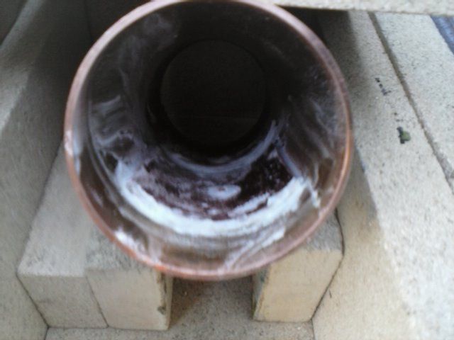

                                I plan to break up the solder jobs into smaller units.. so inside barrel first. Only question i have there is whether anyone has used solder foil for the larger pad to get it properly into the joint?

                                    sweating the pump pad with 24% was easy enough on such a small part.. with 38% it was a real doddle. I then machined it accurately to square dimensions…but brain-farted to the wrong square dimensions and had the pleasure of making a second one – Doh!. The pads were cut/shaped and bent as before and rivetted with plenty of thickish ht5 then left overnight to thoroughly dry… that's a step i was a bit quick over before..fully dry is definitely better. I'd also stuck a length of 55% to one long edge of each pad with flux.
                                    Tonight I scraped away the vast excess and popped it back in the jar then set up my hearth and tools (pics for other novices)..can blowlamp as relight source, welding gloves, something to move hot stuff with, spare rods and flux jar.
                                    The barrel angled for access without the solder pieces able to fall away and lots of insulation.
                                    It's first real use of 55%..very easy to get to temp and the placed solder shows when it's all hot enough. Visibility down the barrel is limited and my experience showed by adding way more solder than needed so it ran through the large pad and the small pad and pooled. Quite apart from wasted expense it was a pain to file off. the outside isn't an issue using a belt sander but the inside had to be done by hand..my dremel sanding drums just kept spinning on their mandrel.
                                    But at least we have a solid first (repeat) step. The pump pad has now been added and I'm waiting on it's flux to dry. With the benefit of hindsight I think I could have soldered that in the same session but I'd rather not be making a third boiler next week (but watch this space!)

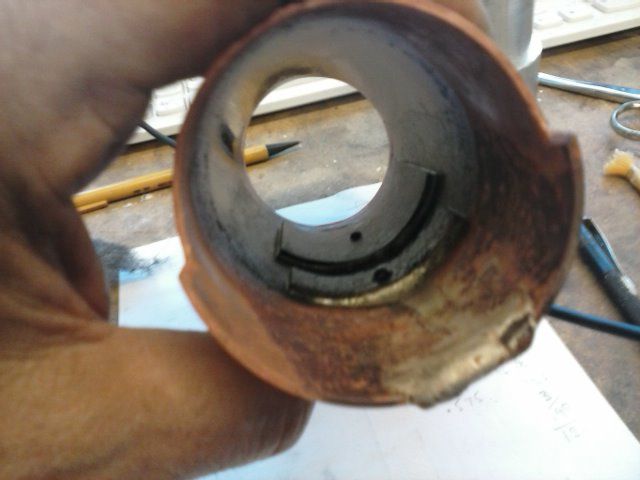

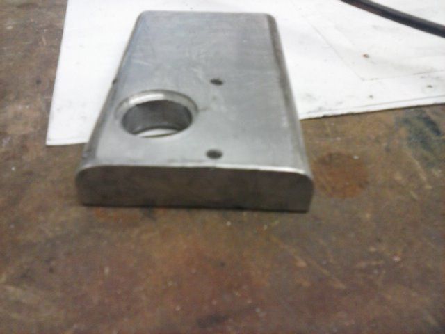

                                                    Help please – I have a problem.
                                                    I cleaned up the brazed tube/throatplate/wrapper and rechecked. Prior to soldering it was all pretty darned square when rivetted (unless I blundered when checking) but now I have the throatplate free edge running away from square to the barrel by 1/16th" over it's 1&15/16th" length and that of course throws my parallel back edges of the wrapper out by the same angle. I'd also left the wrapper sides longer than needed with intention to trim level with the throatplate after soldering.
                                                    Problems therefore are that it's all very annealed and soft after soldering so filing or milling really needs support. Best I've come up with would be to make a timber block to fill the wrapper and then clamp in a vice – unless there's a simpler way? I don't think any of my vices can clamp one side of the wrapper with the edge to be trimmed accessible.
                                                    The other problem is that i need to try and square it all up. I think the throatplate angulation has to be left alone and i don't think that matters? It's the sides and back. The only real reference is the front of the barrel (sit it one a flat surface) and finding a way of scribing a line parallel to that along the back (now top) edge of the wrapper (without a 10" height guage) – which at least runs away so there's 'spare'. Once that is square then the bottom of the throatplate and wrapper can be finished at right angles to the back.
                                                    #265010
                                                    pgk pgk
                                                      @pgkpgk17461
                                                      I think i've figured it out. I have a 6" angle plate. total length to back of wrapper is 9&5/8" so cut a length of bar to 3&5/8, sit it on the angle plate and touch off with a cutter. (my mill has enough throat) then with a wrapper filling wooden block made up i can mill off the back of the wrapper to an accurate 9&5/8" with the barrel vertical in that angle plate. Once i have that new reference and the block i can clamp the wrapper in the mill vice (back edge against the angle plate) and skim off the bottom of the wrapper level with throatplate…?
                                                      messy woodwork needed.
