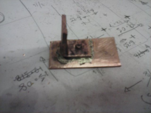

      I had another go at the high temp solder.. with some success. To be sure I cleaned up the failed attempt pieces and then dunked them in dituted sulphuric acid.. rinsed, then scrubbed with wire wool. I made up a larger batch of HT5 flux and soemwhat thicker than before.. coated both surfeaces, sprinkled a few fragments of fine copper 'dust' to space them, left a step between the parts as somewhere to apply the solder rod.. and fired up an 8KW torch.
      It still took longer than i expected to really heat up and I had it all well confined on vermicultie bricks. It got to orange/yellow before the solder would flow.. and having been excessively generous with the fux it was buubling and spilling onto the hearth. Next time I'll wear welding gloves.. It was probably reflection at night ( outside my shed with an eves security light) but it looked like the vermiculite was glowing.. and with just that torch some serious heat affecting my torch hand.. defo need gloves for the 25KW goes in future.
      When the rod flowed it flowed well. I could assess and prove the concept of solder flowing towards the heat source (now directed at one end)
      I suspect that my copper dust had flowed out with the flux.. the solder line between plates is almost invisible after milling the edges but hammering a screwdriver into the gap doesn't penetrate.
      I reckon it's a lot easier to handle on fillets and curved edges.. will have a go at samples like that next and try to asses an optimum on flux which washed onto the bricks and under the part so I had unnecessary solder attached under there too – but I was determined to use too much rather than too little.
      At worst i have a feeling for the colour temp needed for 800C and repetition should get away from the anxious newbie instincts of rushing with the solder and splashing it about.

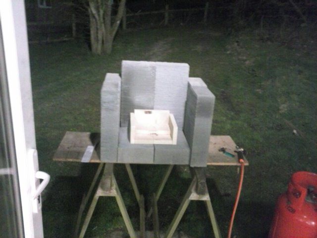

              Flux is HT5 and at the moment this is practice on small pieces rather than plonking the boiler down,
              Hearth setup is a plank across 2 trestles outside my shed.. a layer of low density breeze blocks on the timber and a wind break built around the job from the same .. then vermiculite bricks surrounding the actual soldering job.
              If and when I think I have the hang of doing this stuff then i also have loose vermiculite gravel for packing into spaces

                              This is a pic of my heart..obviously can be shaped for the job:
                              Even this open I've had the torch flame out in use from what I'm sure is O2 starvation.
                              Tonight's practice went a lot better. I used the thicker mix and allowed it to dry properly in the joints before use.. stops the issue I had with the water boiling out and spitting the flux. I also raised some copper in the flat plate joint by making some angled punch marks on the inside of one plate rather than sprinkling a few bits of copper dust in there. Lastly I was more efficient at dipping the rod in flux powder and getting the job to bright orange before bothering to try and apply.
                              It does look like I got thorough silvered joints this time. I'll only really know with the flat plate when machined square on the edges. The practice rivetted angle flowed well from the bend throughout the join though i'm still not calm enough/complacent enough to have remembered to apply solder to the rivet itself. It had flowed out around the head though (underneath)
                              Julian, That's a wonderfully friendly offer to come help.. and you'ld be welcome to come see this part of wales anytime (beers on me) and springtime my bit of valley is very beautiful. rationally I suppose if it comes to it i should do the driving and bring my sievert torch and cannister and copper bits etc. Doesn't stop you coming up without any brazing intent..and for loco lovers we have llynclys station on the Cambrian heritage track only 15 mins away and Bala lake railway about 30/40 mins the other side. Daffs are finishing, primroses at their best and bluebells starting and next month I hope my patch of wild early purple orchids flowers again in far field.
                              I may well end up begging for help when I bog-up on the first attempt and remake all the stage one parts (if not so disheartened I abandon the minnie) but feel the whole point of the hobby is to try and learn.
                              Overall a more positive evening.

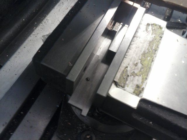

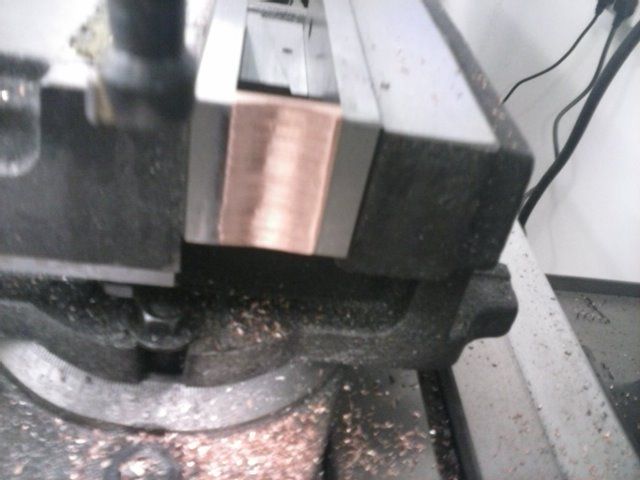

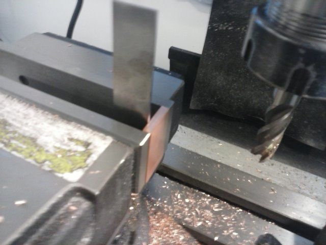

                                Of the three attempts/practices at silver soldering the first pump pad had a tiny void at one corner when squared up. The second go with thinner flux had a big void and the third attempt came out perfectly (I needed practice anyway)
                                To cut the radius I set it up in the mill with the boring head. Set at the edge of the vice i used an adjustable parallel at the other end of the vice and a square to get the part vertical with finger feel and a feeler gauge.
                                It had to be slightly proud of the vice since the setup of this pad isn't central on the boiler tube but 1/32" low of centre. The face of the plate was found and the boring head set boiler-tube radius away and with the face marker pen blacked it was adjusted so the head just touched.
                                The radius is then cut, ideally until the far edge is just affected. I'll admit that I hadn't set it far enough out of the vice so about 1.5-2mm shy of radiusing the far edge but not important.. the tiny void should get filled by solder anyway. And some of that is lost in smoothing off with a file.
                                the the rivet hole is drilled and temporarily located with a screw.
                                It would look better if it was tightened down with a nut.

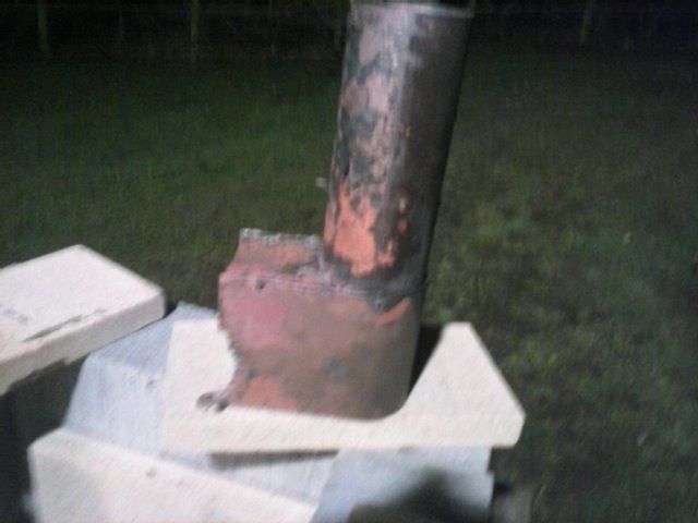

                                      @pgkpgk17461

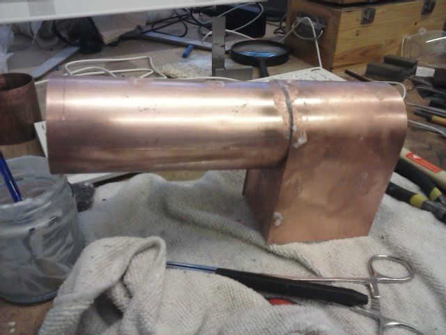

                                      Failure!
                                      I fluxed the components thoroughly.. using a good tapioca mix of HT5 on both surfaces and having it almost dry before rivetting (partly due to my slow plod at doing that). I figured more flux better than less and the thick coating acting to prevent the rivettng beng too tight.
                                      The everything allowed to dry.
                                      I hit te same issues Brian had.. failure to get the first stage boiler bits hot enough quick enough. I had it poitioned siting on the flat firebox end, enclosed on three sides with vermiculite blocks but necessary with space to access the pump plate and the tube end open to acess the inner pads.
                                      I directed the 25KW burner first at the outer surround of thermalite blocks to warm them up, then generally over the whole assembly until it was blackening and then concentrated the heat up from the firebox end with the flame shooting up the tube. The wrapper heated up to dull red and bright orange quite quickly with the flux liquifying but getting it to the yellowish tint I now recognise as necessary for high temp solder proved impossible. Stupidly I still tried to solder. The HT5 exhausted very fast..perhaps helped by the heat air-flow. I did manage to get one seam soldered by dipping a rod in flux powder and laying along the seam but even blowng sraight at the tube from outside of one of the inner pads doesn;t get the inner pad hot/bright enough to solder.
                                      I could see that if I'd laid solder rod along the outer parts' seams I maight have succeeded but accessing the inner pads in the same session that way would prove hard to impossible. There was enough heat blowback that even with my cheap welding gloves my hands were getting hot and I coudn't get closer than 1/3 a rod.
                                      I should have abandoned the session but foolshly plugged away thus destroying any sane chance to reuse any of the bits.
                                      What i did learn: I had always assumed that copper conductivity would get all of it more evenly hot but at one pont I had one end almost at yellow heat but the other end still black – suggesting one could sub-divide this part of the soldering further allowing more insuation of sections.
                                      It also makes me wonder how th author managed with presumably a parrafin blowtorch..unless they actually burn hotter than propane.
                                      Brian Abbot listed his failure even with a larger torch and i can see how that could easily fail by just exhausting the flux quicker.
                                      Even success at this stage doesn't bode well for success at the further stageswith more lump to cook.

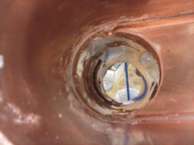

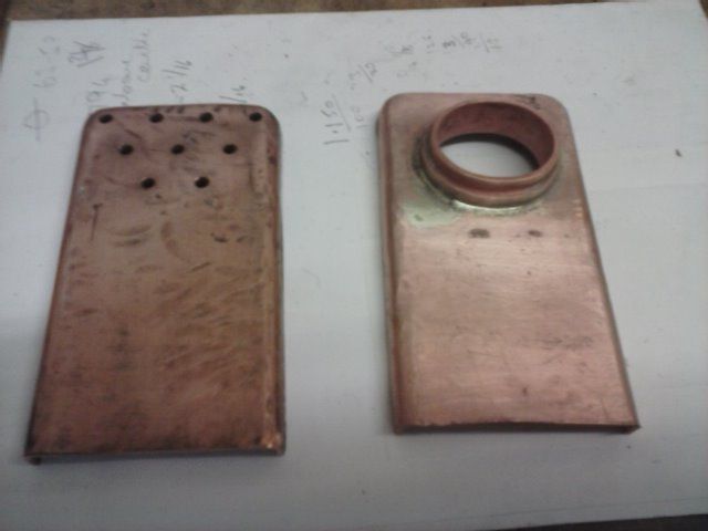

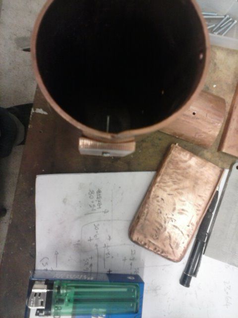

                                            I'd hoped to have more regular progress reports than I've managed of late but it was time to redecorate the sunroom and living room (kitchen next) and there's been rain every free evening so no chance to do test cook-ups. 25L paint later i need a break from that..
                                            Once again i failed to read the book properly.Mason himself talks about using the c4 for the firebox end but easy-flow for the tube pads. doh! Eventually I'll learn.
                                            (wife was planting some Rosemary the other day and telling me it's good for memory. I replied that I don;t care what it's called so long as it has nice legs and can take short-hand)
                                            I've wondered about trying to salvage my work so far but abandoning that idea..I don;t think i could asses how well the solder penetrated after such a disaster and it' be worse to find impossible leaks later. I need another length of tube ordering.
                                            I do have the following pics of the parts pre-solder.. washed in acid, cleaned up and fluxed.
                                            Hopefully some dry days coming.
                                            Meantime I'll press ahead with the firebox components on tonight's session….

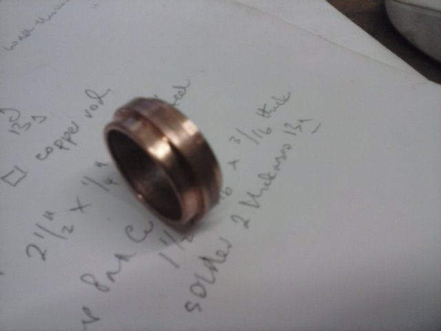

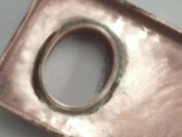

                                              A dry evening at last. I already had the two firebox plates flanged and used the template to drill the 1/8" pilot holes in one. For the other I turned down the firebox ring to specs (allowing for the fact that my piece of tube was 1/8 less od but same gauge), filed out the hole for its seat and had another go at brazing with 24%.
                                              Fluxing and prelaying a ring of solder around the joint and just letting it cook up and flow worked well..specially with vermiculite bricks overlaying the flat part..it easily got to bright orange/yellow.
                                              ..and a very nice solder ring both sides.
                                              As an experiment I cooked up the dud/failed tube and wrapper from before to see how hot I could get it..you can see from the pics below…melted and burned copper..all down to better insulation! (OK so you guys all knew that). I got the base all the way to yellow colour and a pile of oxide slag.
                                              I looked up the melting point of copper at 1085C. No question that propane gets hot enough.
                                              #237275
