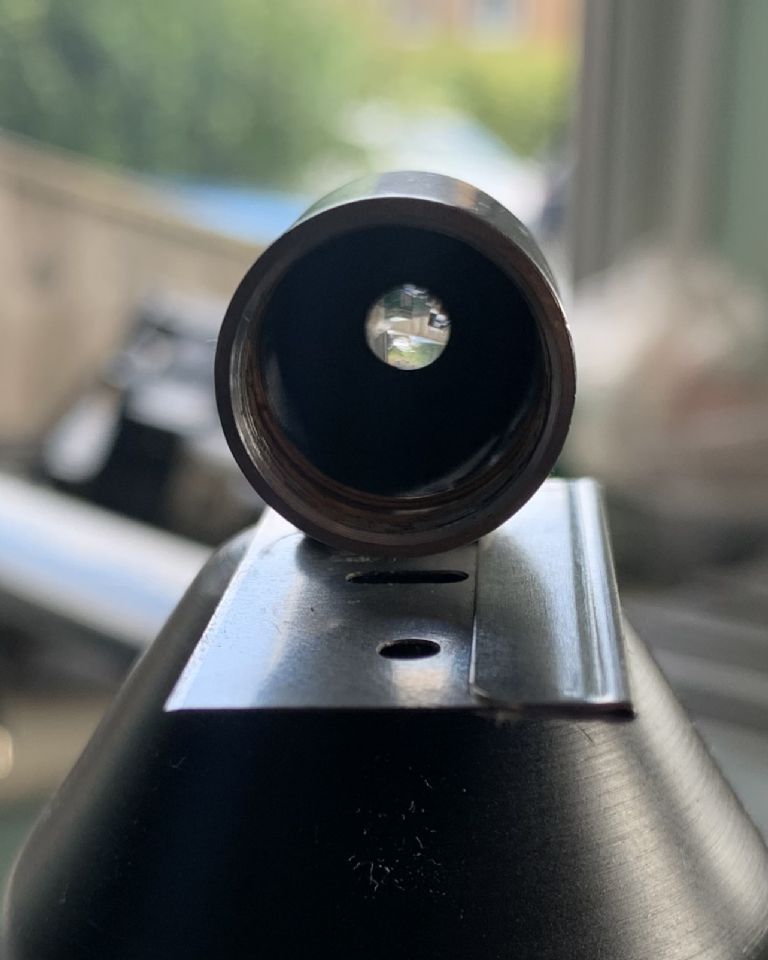

        This is the problimatic lens:
        As can be seen Its not clear like the other 2 lenses(below) the thing I cant work out is how they come out of the brass body, the front looks to be machined to that shape and the back doesn't look to unscrew, what's peoples opinions?
        I hope these pictures explain.

          The fitting behind the lens normally unscrews in microscope objectives like that. It may not be obvious.

            The good news is that it looks like the lens probably has a standard RMS objective mounting thread, so substitution shouldn't be a major problem … although 1/2” x14 is not a common power.
            The group in the Brass cone may well have been located [at the small end] by ‘rubbing’ [a.k.a.burnishing] … like a jeweller mounts a cabochon stone: in which case dis-assembly and re-assembly might be tricky.
            Edit: as Robert mentions, the ‘cup’ at the large end could be threaded [inspect carefully]

                I agree the lenses may well have been burnished in place, hard to get out but not impossible.

                    I am perfectly happy to be wrong … but these two photos appear [to me] to show a burnished edge separate to the conical brass cell.
                    Unfortunately, I have yet to find any detail about Baker’s mid 20th Century assembly techniques.

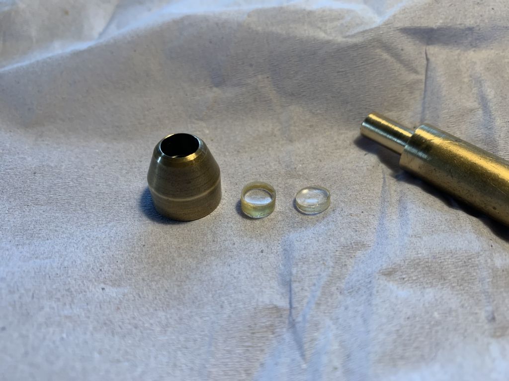

                              Well a stroke of luck following Rogers advice:
                              Well good for the lens not so good for my finger, I decided after pressing the doublet out I would press my finger in to the threaded end of the body, a nice gouge and a flap of skin is what happened!
                              I turned up this plastic holder to support the brass body (it is tapered inside!) the brass body was a good fit.
                              This was the set up in the lathe, using the lever operated tailstock to gently press the doublet out, It might of just been glued in as it was rather sudden when it broke free. Also I can't see any evidence on the brass body inside of it ever being burnished in, although I cant be certain, its probably so small!
                              This is the little brass pusher I lined it with electrical tape, after turning the front face convex so just the very outside was pushing on the glass lens.
                              I am partway though cleaning these 2 up with meths, they are both glass and coming up rather well, I am now looking in to reassembly, how best is it to proceed in your opinions?

                                Great result, William … sorry you had to suffer for your Art crying 2
                                Traditional bond would surely be Canada Balsam [which has the great advantage of being easy to remove if things go wrong] but a modern alternative, which I think Clive mentioned, would be LOCA [as used for mobile ‘phone screens]
                                Big question … are the two elements exactly the same diameter ?
                                Hopefully they are, because otherwise you will need to centralise them in the lathe
                                No, I’ve never done it, and the idea scares me somewhat !

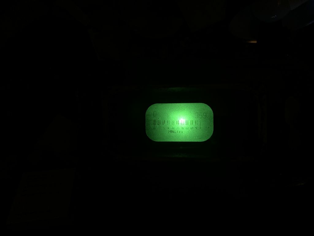

                                          Well:
                                          (quite a difficult thing to photograph)
                                          So in the end I went the LOCA route because I'm a cheapskate!, (it was extremely simple aswell) I also didn't want a huge great quantity left over.
                                          I went with one of the many cheap kits available on eBay, The UV torch was immediately dismantled and jerry rigged to my bench to power supply, the 3 AAA I scrounged only managed to barely illuminate 3 LEDS anyway. This also enabled me to knock up a quick tripod to hold it about 20mm off the bench.
                                          So I experimented with some 1981NOS glass microscope slides(well that's what the boxed wrapped in cellophane said)
                                          The result was a success and gave me confidence to risk the original! It went very well, As can be seen I just used the original brass cell as the line-up ring, the doublet was a relatively good fit anyway (they were the same dia, the lenses Michael) It also meant I didn't have to worry about peening it back it as the glue seems to be holding them in. I cleaned them, a couple of drops of LOCA, place together, wriggled them about to spread the adhesive and dropped it in the cell, lightly pressed it home with my thumb and placed under the UV light. left for about 5 mins, come back to one optically clear doublet.
                                          Reassembly went well, I screwed the brass cell Doublet fully home as it was that way upon the initial dismantle, the glass ring was installed and then the "first" lens was adjusted until the 0.2mm markings were in focus, then the black tube was rotated to get the markings in the right place on the minutes scale, the Baker object mounting thread is off centre to the black tube. The mirrors were not disturbed when I dismantled to preserve the original setting positions, I glad I did this as I would not know where to start to get these back in adjustment!
                                          I then following Clive's advice, "clocked" the glass ring by having it clamped very loosely just pushed it about until the markings all the way around were in the same place on the minutes scale.
                                          Well there we go, I am now going to try and look in to rectifying the minutes scale, Graticules optics is who I will try first, Now that I know it does actually work. And see about a permanent light unit.
