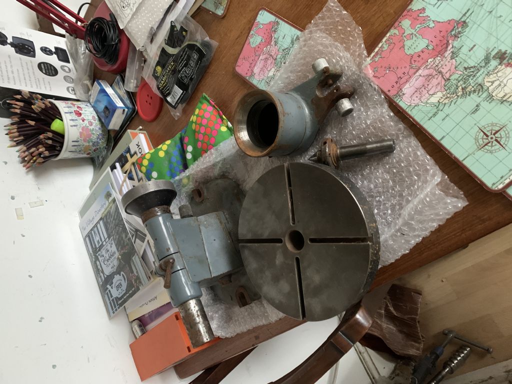

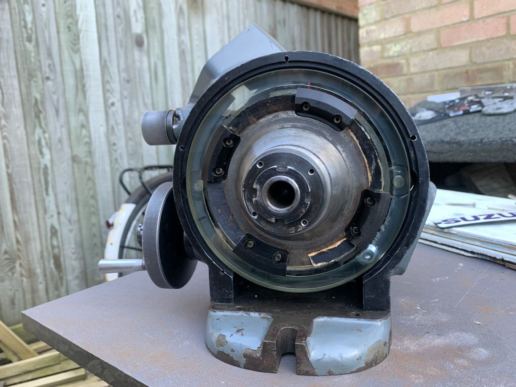

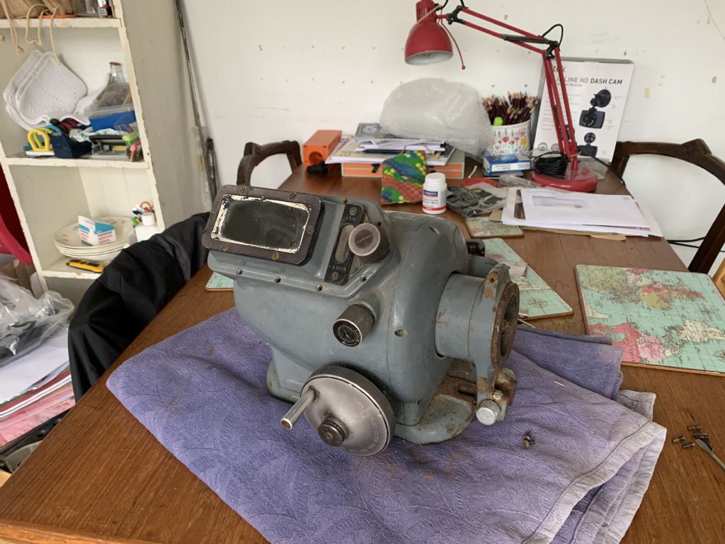

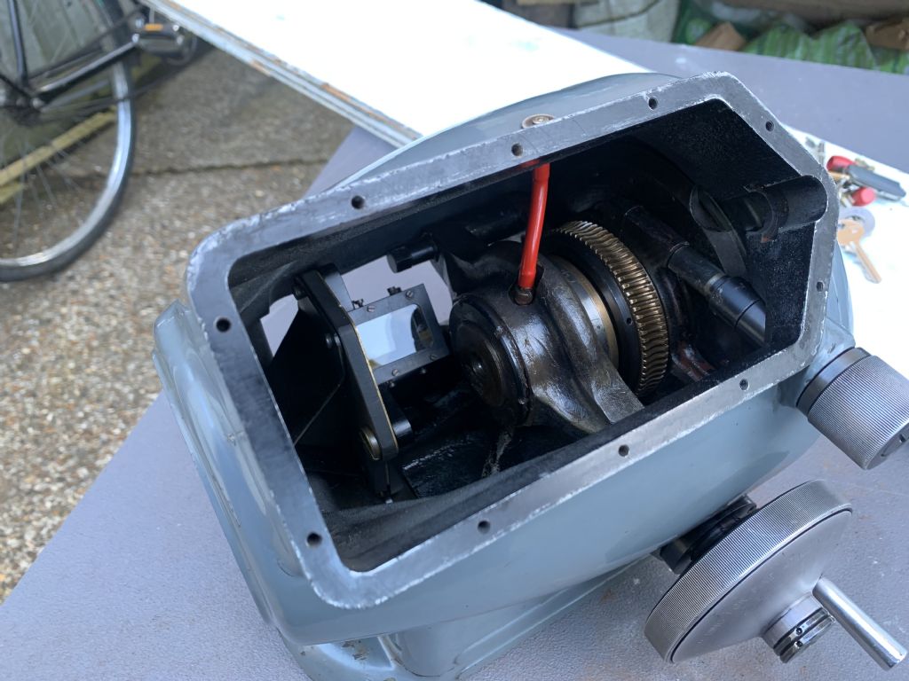

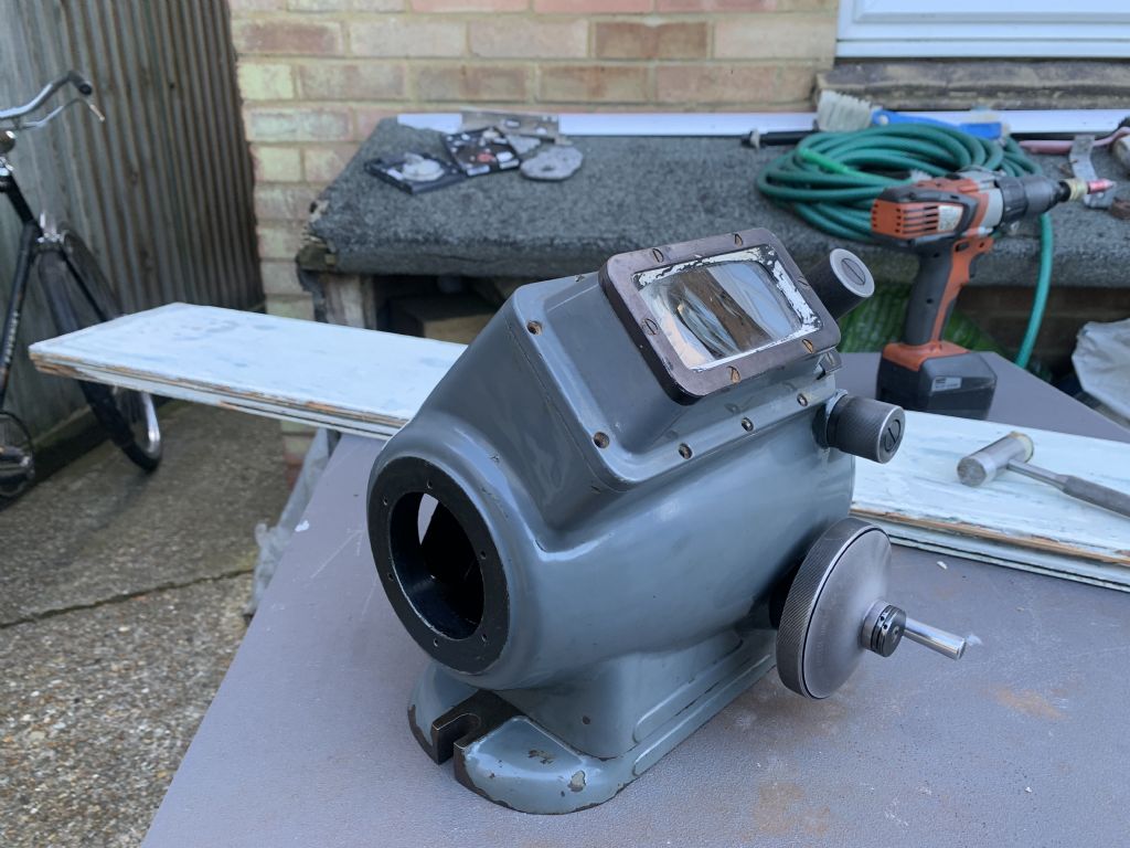

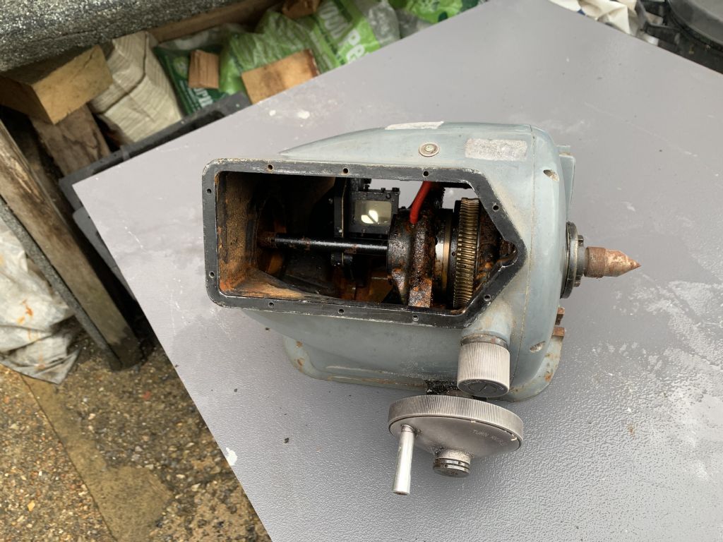

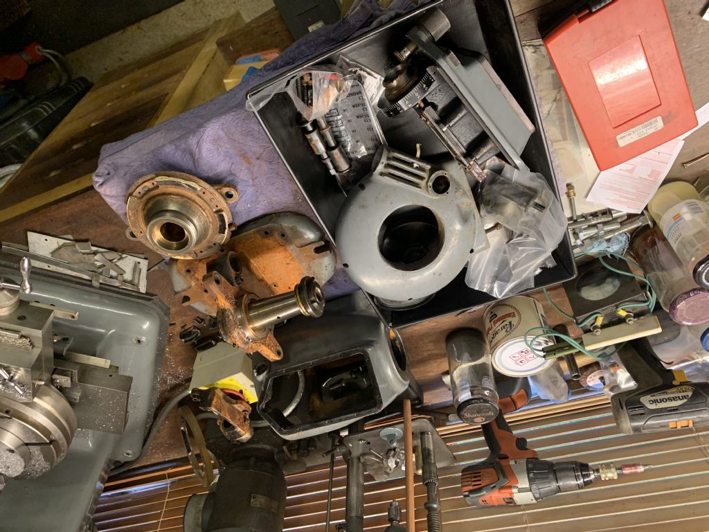

      Hello All
      Just after winning this piece of vintage kit, I said that it is going to be the best £134 or worst £134 I have probably ever spent! I'll let you decide:
      946723b3-c0a6-475a-9f34-af07944d7a68.jpeg (sorry for the orientation of these 2 pictures! The recent thread about picture orientation has taught me how to orientate my phone when taking the pictures!)
      So that what it looked liked inside upon arrival!, it was sold as being sat in a shed for a few years, seemed to be an uninsulated shed! The constant temperature changes and being basically a sealed unit means it has basically sweated inside, and ended up in the mess as seen above.

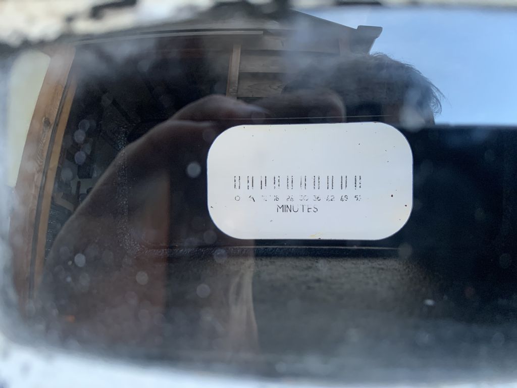

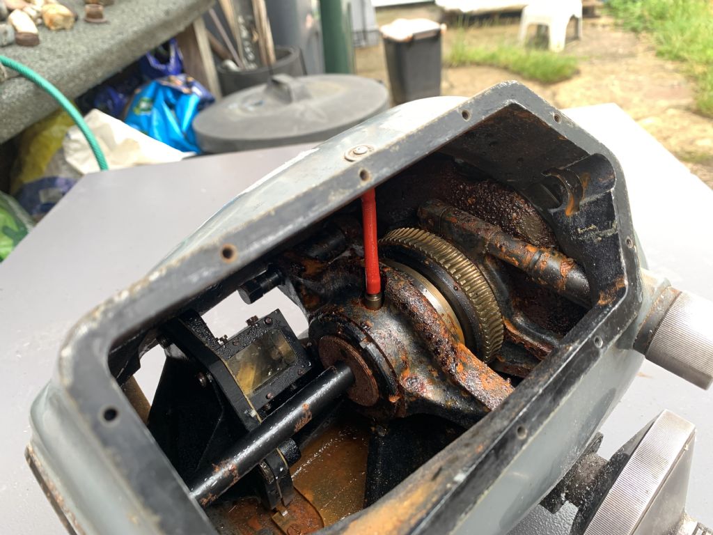

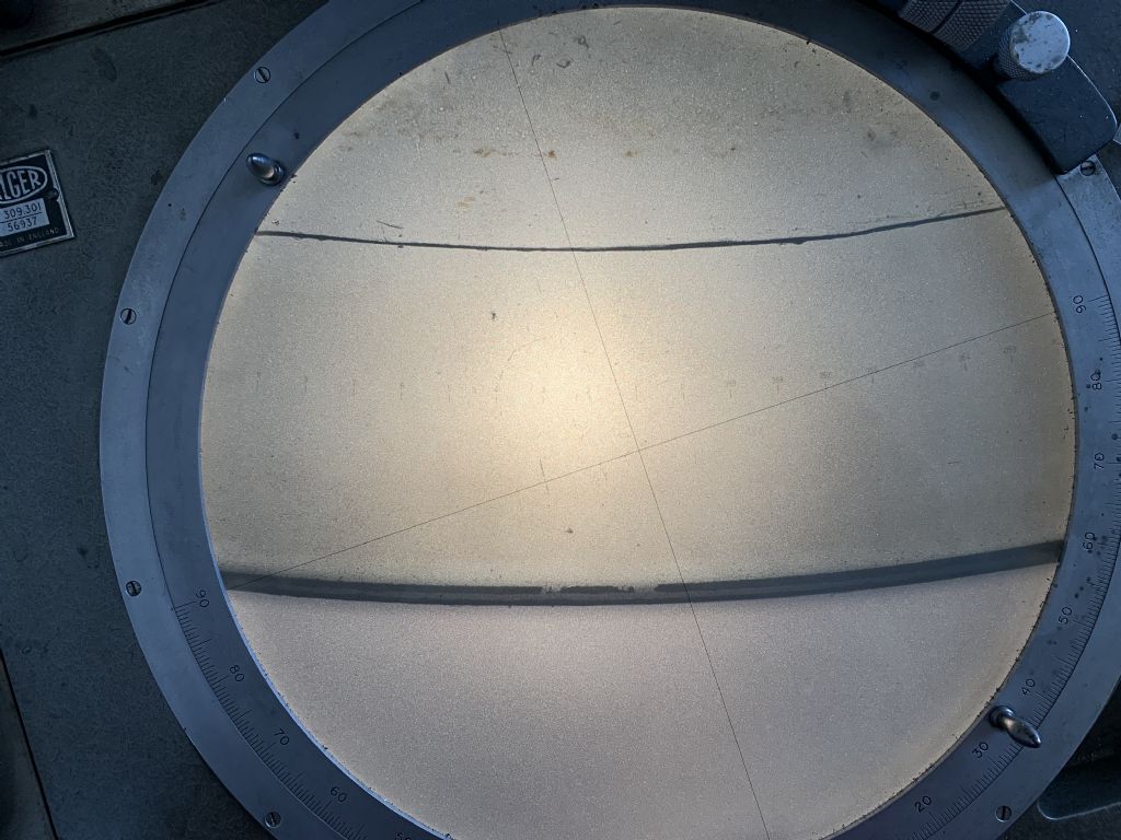

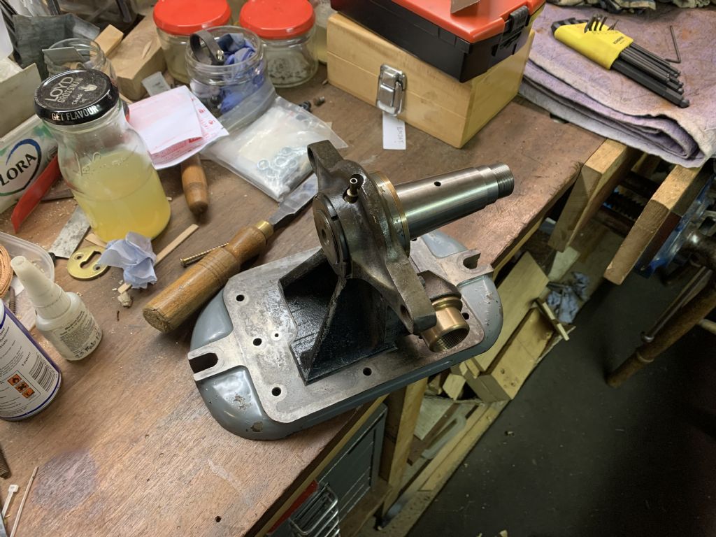

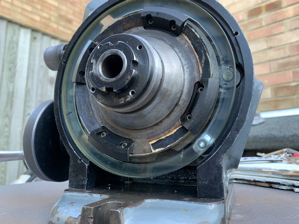

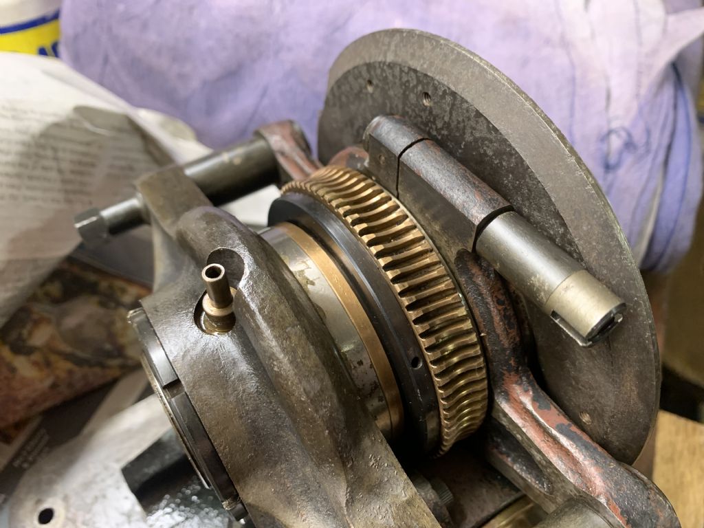

          However a bit of dismantling, WD40 and a razor blade, most rust was scraped off ending up with:
          Not too bad if I say so myself! The only damaged I subjected it to was the cracked casting around the locking knob, this was not my finest hour and I am quite peeved with myself. The rust hasn't eaten in to the base metal really it had almost just furred up like scale in a kettle so was quite easily removed.
          Now mechanically it is in good condition there is very little wear, helped by the rather simple yet clever oiling system.

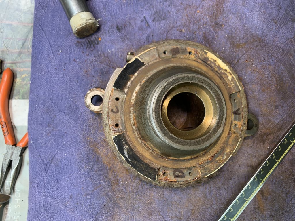

          Optically however it is challenged. Its internal soaking has dissolved what I believe were water slide transfers on the glass(or could they of been something else?), The glass ring around the spindle is totally void of any markings, this was like this on me dismantling it, however the minutes scale on the was in ''good'' condition because it was sandwiched between to pieces of glass however on me separating them to clean the water staining between has meant I have disturbed the very brittle transfer and ended up with:
          So basically it is useless as it stands,
          How do you think it is best saved?
          Could one get water slide transfers made up?
          Could lazer engraving be a contender?- My worry would be precision with this method, I.E., set up in the machine etc. There is a local firm who I am thinking of talking to.
          The glass ring I was thinking about setting it up on the my pantograph on a rotary table with a diamond drag tool in the spindle and scoring the glass. Again though my worry is actually getting it right as it all depends on getting them exactly 1 degree apart! (or does it?)
          Or is it a really specialist task? Would a company who produces microscopes be worth contacting.
          So there we go, please fire away with your thoughts! I look forward to hearing them

              It's probably a long shot, but the markings on the glass glass could have been etched into it, and made visible using a dark material (like the graduations on an old glass thermometer) which may have been washed out during wet storage. It might pay to get some finely powdered graphite, (or filed off pencil lead), and rub it across the surface of the glass where the markings are and see if any new markings appear.
              As I say, a long shot, but worth a try.

                  As Alan says, it is worth a very close look just in case the marks are etched as was common with instruments then.

                      I'm not sure how these things work. Is the optical scale on a glass plate attached to the main spindle, I know should be obvious but just to make sure? If so the accuracy is in that scale, not the worm. Therefore normal dividing unless done on another similar quality device would not be 'up to spec'.
                      I assume the essence of these things is that the scale is produced as a photographic plate. Back 40 years we produced etched microwave circuits by photo reduction from a master made with black tape on a drawing table. In the extreme we could tape it up 6ft square and reduce to 1 in square. I think the same would be done for this. The surface of the glass would not be etched, rather it would be optically very good and flat, able to take a photo sensitive coating. Not in itself all that difficult but needing the right 'know how'.

                        Hello all, thanks for all your thoughts,
                        Yes Micheal, I have come across that, although that one has a resolution of 3 seconds as opposed to mine which is a 6 second resolution. I think they just engraved another line on the dial. That is about the extent of online information!
                        Alan, and old mart, it was worth a try, I had a go today with some graphite it sadly didn’t highlight any etched markings so I don’t think it was previously etched.
                        Making water slide transfers up is something I have contemplated, however accuracy is my biggest worry.
                        Chris, you might be correct, I did a bit of online digging they appear to be under a slightly different name of PGT Ceewrite/Ceewrite engineering Ltd. I will give them a call and find out. Just quickly glancing google for PG hadn’t found much.
                        Bazyle, yes the glass ring shown in the last 3 pictures is what carry’s the degrees markings, so really has to be accurate to within the resolution of 6 seconds.
                        The light is shone through the glass ring which rotates with the spindle, the markings on the glass ring are picked up by the magnifying lense (4th picture, second post) the light then goes through a load of right angle lenses at the end of the end of the black tube, until it reaches the last lense, on the inside of the unit. The assembly in my hand magnifies from the last lense, up through the screen with the minutes readout on it. I hope that explains the basics of it, not the best I know! I’m not exactly certain on how the minutes adjustment is used in practice yet. So you are correct the worm is only used as the positioning device. So I need an optical rotary table to get the same accuracy myself!
                        I like the idea of laying it out on a large scale, that is something worth thinking about. It was doable 40 years ago so it should be possible in this modern day and age!

                          William, having replaced etched circles many times be aware that if you remove the circle, when replacing it will have to be accurately centered.
                          The circles are in fact photo etched and then baked to set the etch permanently, I have never seen the markings
                          come off. as a cost comparison a glass circle from a theodolite cost all but £200. There are optic companies who will make one, but of course cost is the crunch.
                          #552648

                              William, just a quick though occurs to me…. some of the graticles in my OMT microscope optics were almost so fine they were invisible to the naked eye. It might be worth going over the glass with a microscope to see if there is anything there, or at least the remnants of something which may show you where to put new marks if that's what you decide to do.

                                    @williams

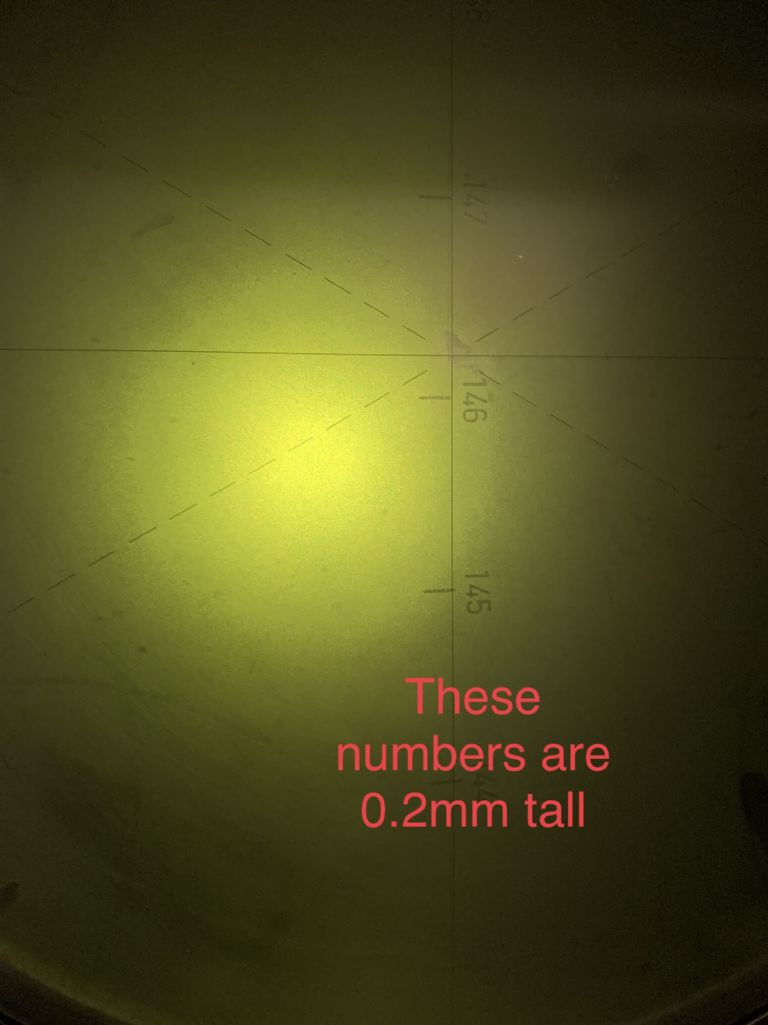

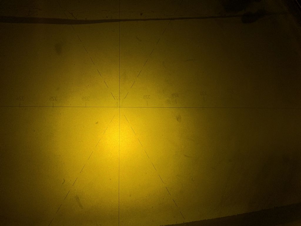

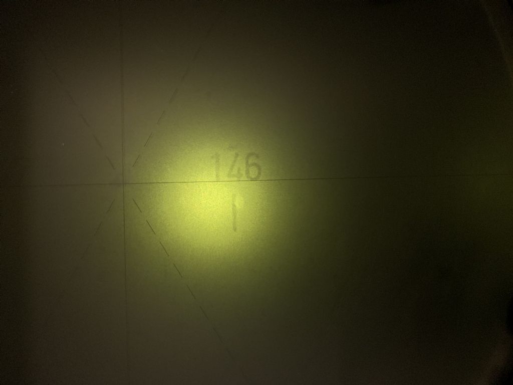

                                    A quick update:
                                    The prize goes to Gerry for suggesting that the markings might be practically invisible to the naked eye, which they almost are! They are absolutely miniscule, how they were done 40 years ago is blowing my mind!
                                    All markings on that ring are present and correct, I'm going to have a look at it tomorrow on the shadowgraph at work, hopefully I can then get some pictures as well.
                                    I found them by playing about with a little led bulb, I was just shining it down the hole and turning the handle when in the corner of the readout I just saw the flash of a very feint line and what looked like numbers above. I then twiddled the handle back and forth and could just see a few lines. You would not belive the relief that was. I then spent all day at work eager to get back as shortly after finding the lines I then subsequently lost them again! When I got home I took the glass ring off and in holding it up to a strong light I could just make out the blobs of the numbers and lines, all the way around the ring.
                                    Under my Prior dissecting microscope I can just about read each number! Although I don't have any of the actual magnifying hoods so I am unsure of the magnification, I will try as I said with the shadowgraph and post my findings.
                                    Many thanks

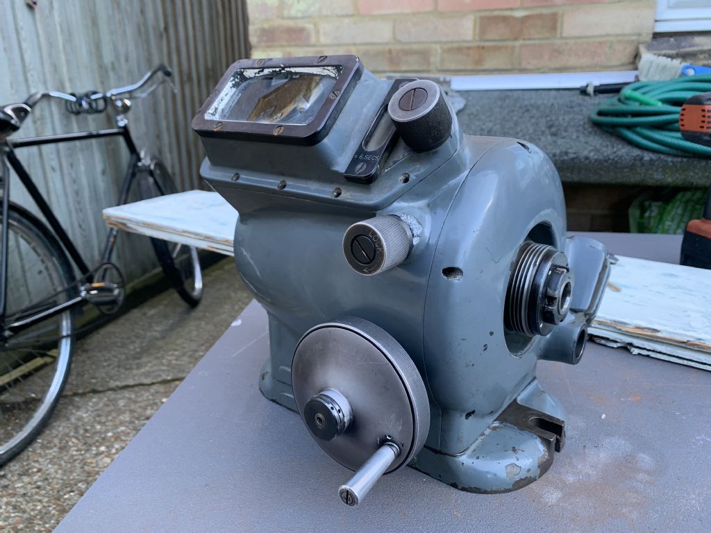

                                            Here’s some pictures of the “non existent” markings!
                                            That was on the old Hilger shadowgraph. Not the best I know
                                            Now on the big Sigmascope, at 10x magnification
                                            still blows me away the size and quality of the markings, I believe as Clive said they must be (photo?) etched. Think about car glass, the triplex etc markings I guess are done in a similar way.

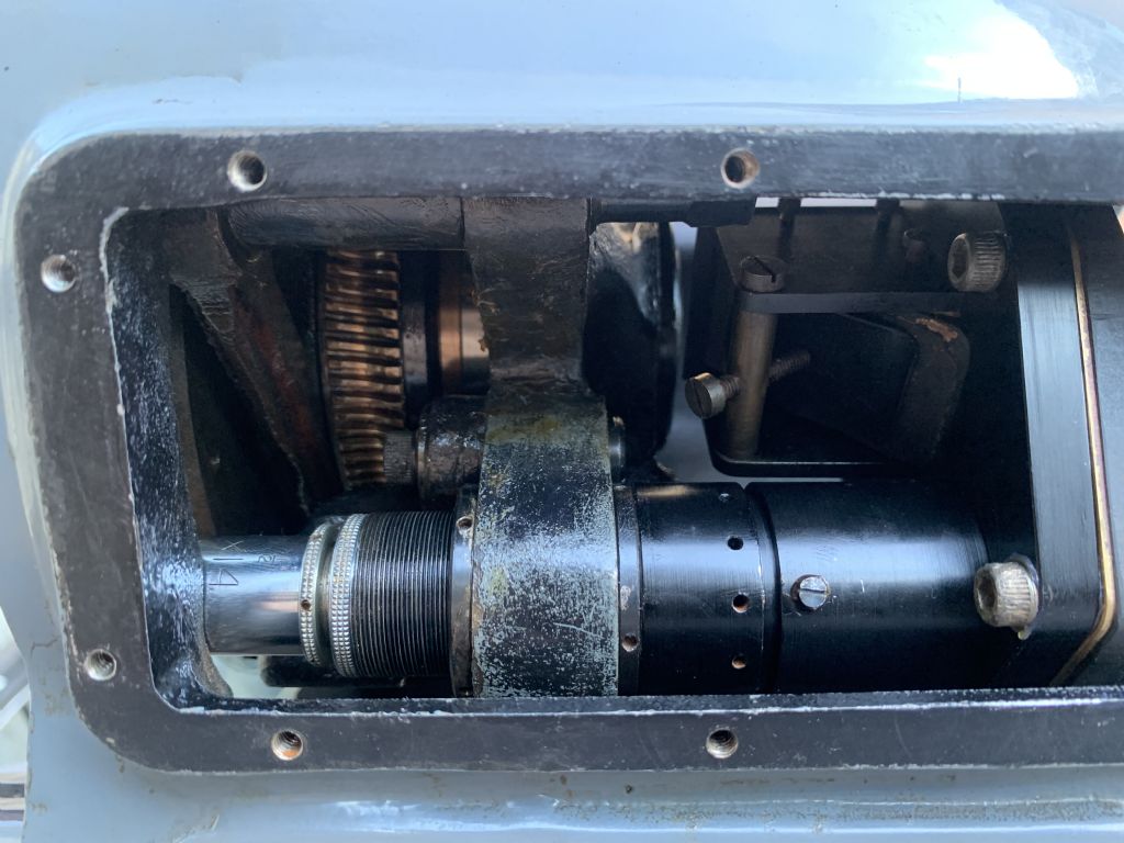

                                            I think now my issue is some staining on the middle lens of the magnifying lens. It’s marked C Baker 1/2” 14x. If any one can suggest how that comes apart, I’ve unscrewed it in to 3 parts but I think there’s 2 glass parts together and moisture is trapped between them making it almost impossible to see through. I’ll get some more pictures it’ll explain better than I can say in words!
                                            I do understand the need to clock the ring Clive, there is putty which was/is acting as a locator, but I may replace this as it’s very delicate, Do you think the markings were done concentrically to the ring o.d/I.d or do I need to be creative? The ring had to come off to disassemble it, there was no way around that, I was very reluctant to remove the ring due to getting it back concentric.
                                              Yes please, William … detail photos of the Baker would be interesting and hopefully ‘diagnostic’
                                              From your brief description it sounds like there is a cemented achromatic doublet in there, and delamination may be the problem.
                                              P.S. __ Impressive as it may be in the context of a large glass ring … 0.2mm high lettering is by no means uncommon on graticules/reticles

                                                I think by looking at the pics. the glass ring is held by those blocks?
                                                In any case, centring needs to be done by rotating the ring mount and viewing through the microscope and nudging the circle at reciprocal degree readings till there is no error. Use a copper nail to move gently with soft tapping on the copper nail.
                                                Secure the circle with dobs of Shellack or thick cellulose, several dobs around the circle, not using too much or it will run.
