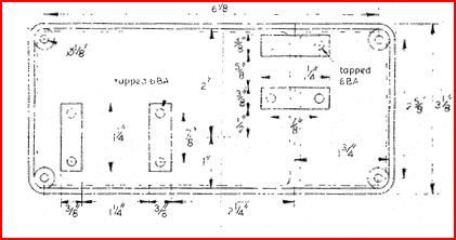

        I have had an enquiry from an M.E. subscriber, Mr Malcolm Cox, who is building Edgar Wesbury's 'Perseus' as a first engine. He finds that there is no indiciation on the drawing of the relationship between the position of the bearing pillars and the trunk guide support and this cannot be calculated because other relative dimensions are not defined (i.e. te connecting rod and eccentric rod lengths).

          The position of the trunk giude support and the bearing pillars as well as the cylinder support are all given on the drawing. This will determine the relative positions of all the parts along the length of the engine. Also the position of the bearing blocks relative to the centreline of the piston is also given which will set them out at right angles.
          I'll e-mail you a poor snip of teh base plate drawing taken from Reeves site, not going to be an easy one to explain over the phone.

                  Neil, I think you did the same as me, it Theseus that was free with ME which is the barstock version. I do have that some dimensions tally with Perseus others dont but it may be due to one using castings the other not.
                  As far as I can see from the reeves drawing which is the M20 all the info is there along the bottom.
