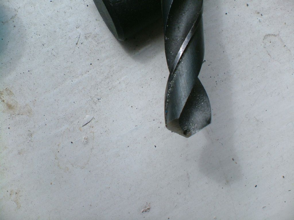

          Here'Clives photoss what you want, no problems apart from a limit on the size of drill being ground.

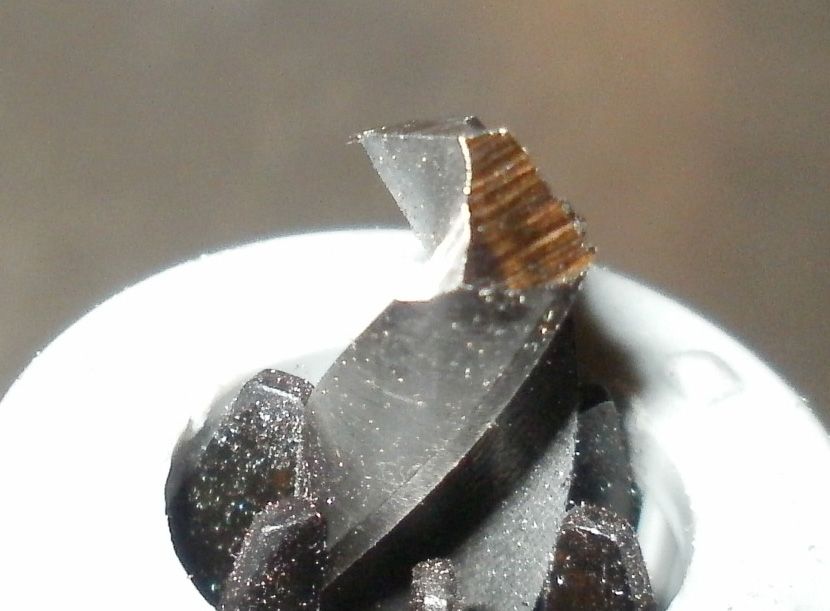

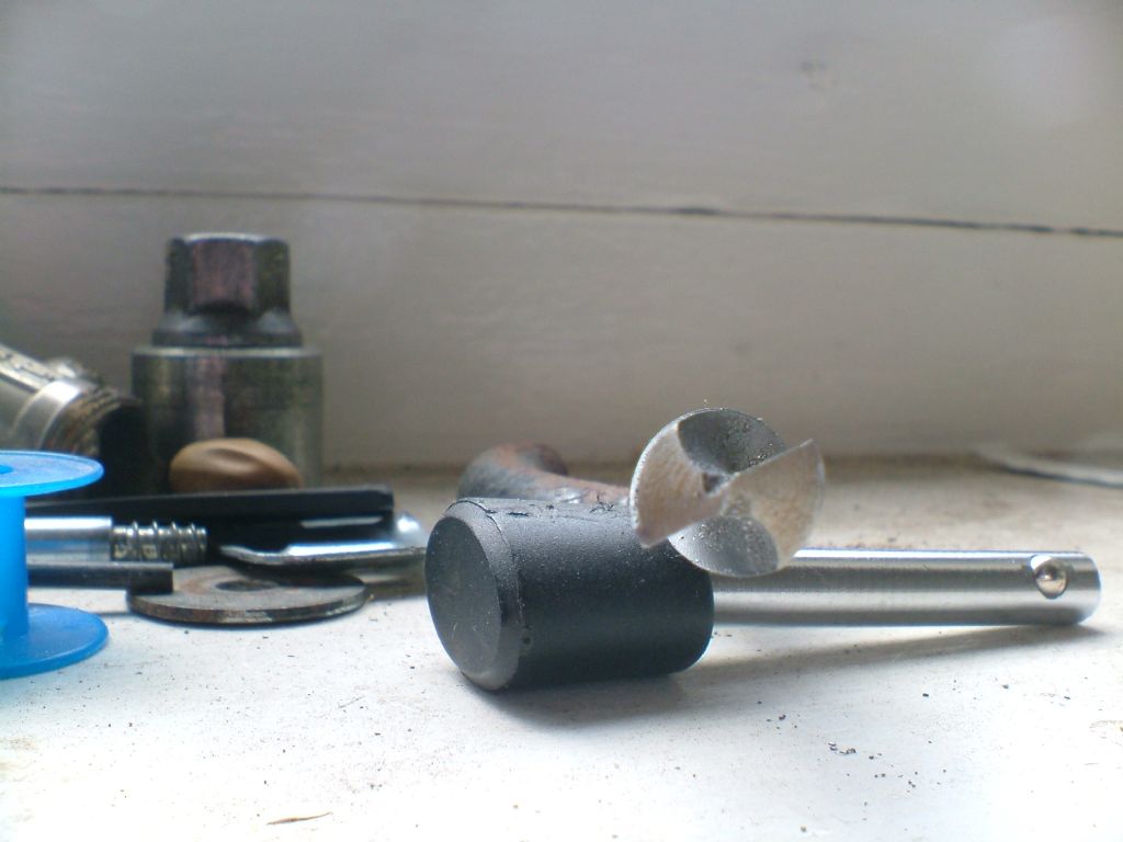

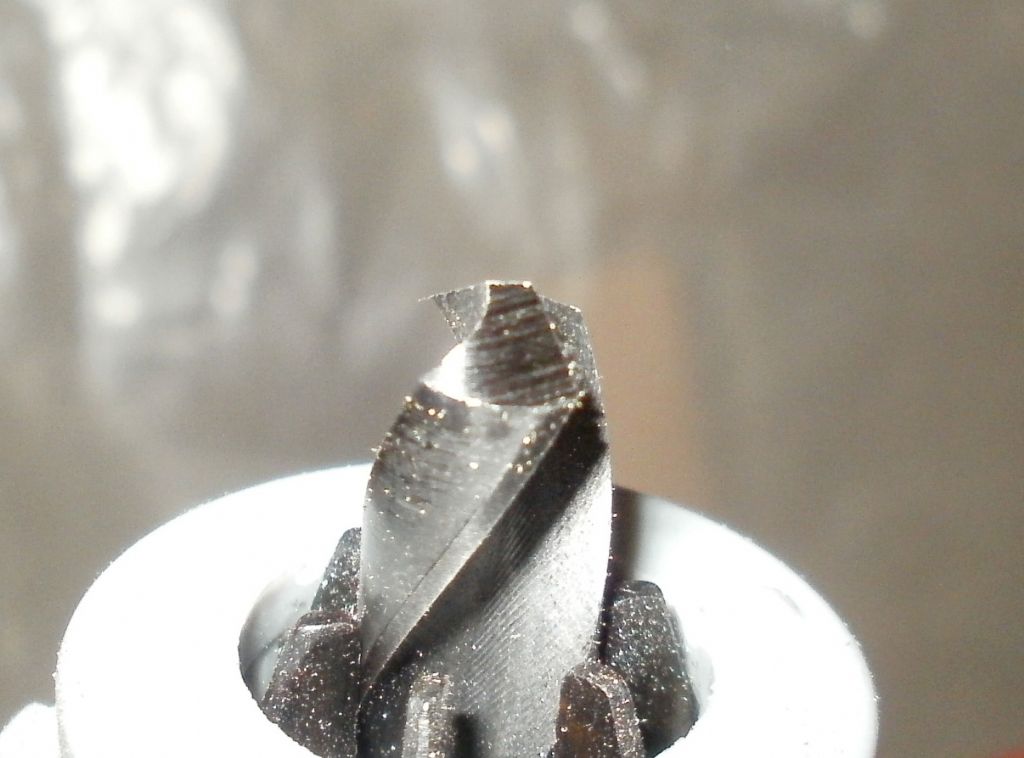

                        I got one of the Holzmann drill bit sharpeners mentioned today and have been playing with it this afternoon. Seems a solidly built unit and the "plastic" bits are thick and hard rather than flimsy. There is a video on the German parent website here .
                        I am not sure about the angles it produces though, the first grind, I'll call it cutting looks too shallow to me and the clearance angle grind which is done second barely touches the back of the cutting edge.
                        First picture shows after the main grind of the cutting edge…
                        And after the clearance angle has been ground
                        Not sure whether to return it or not.

                          Hi Andy,
                          I also bought one in the end, very pleased with it, but before you grind the clearance angle, you need to reset the drill position in the holder again.

                            Hi Chris,
                            That certainly takes more off but neither the instructions or the video mention resetting the bit between grinds, the video clearly shows doing one then the other all in one camera shot. It doesn't look right to me :-

                                    I would have said from the second pic the drill has been thinned too much. The cutting edge looks to have gone in the center.
                                    I've got a Holzmann myself and I've noticed it's quite sensitive to hand feed variation which can give an off center grind effect if you don't take care.
                                    It shouldn't need resetting for the second grind unless the second grinding station is set too high.
                                    All I have done is regrind on the same setting if it looks off and that seems to fix it.

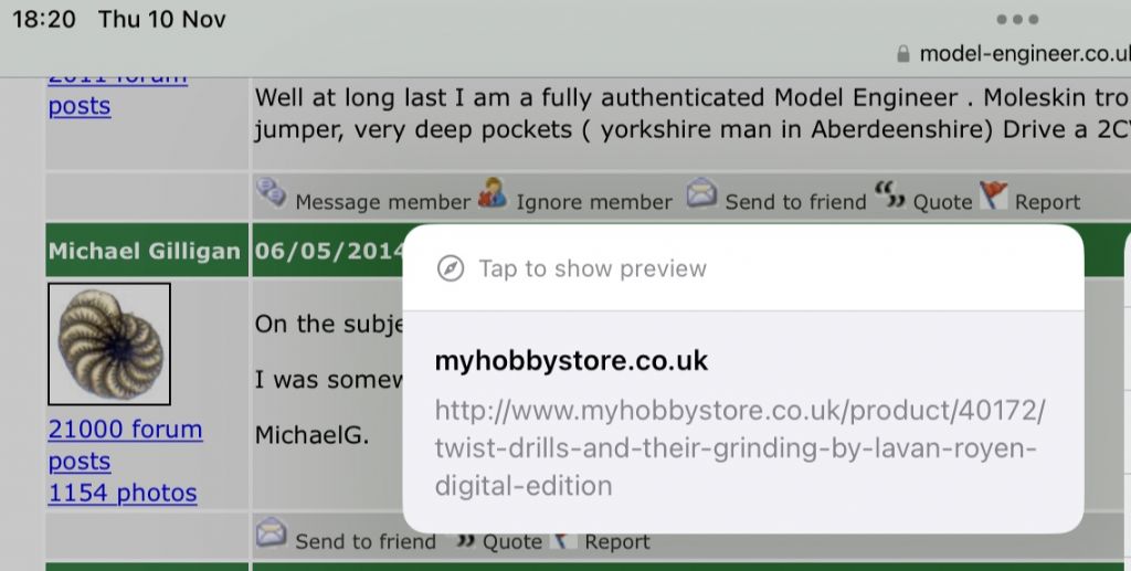

                                      Can someone tell me is the content from the earlier part of this thread [presumably by Graham Meek] that has been redacted without acknowledgement viewable somewhere?
                                      I've read a lot about Spiralux and Picador drill grinding jigs on this forum and have recently acquired one of each [they look about forty years old at least but are BNIB]. I'm getting pleasing results with the jigs, but would like to refine my understanding of drill sharpening further, and then possibly refine my jigs and technique.

                                        #620545
                                          Bill
                                          … not sure if the van Royen document would help … but here is something to point you in the right general direction [the original hyperlink being useless now]
                                          Edit: __ this might be quicker: https://www.model-engineer.co.uk/forums/postings.asp?th=140032

                                            Thanks, Tony, I've Googled this aplenty, but I'm not seeing the "nice work" by Graham referred to by Michael in this thread's opening post, nor the "practical demonstration" referred to by Clive, which presumably illustrates "the improved drill clamp arrangements" summed up by Thor as "advice on improving the jig". I've seen one photo in a later thread on this forum showing Graham Meek's jig set up next to a Clarke grinder, but nothing I could interpret as a practical demonstration.
                                            The following thread too has frustratingly been purged of images and possibly text as well:
                                            https://www.modelenginemaker.com/index.php/topic,3788.0.html
                                            There's clearly some reason for the removal of previously visible material from both forums, but I can only guess what that reason might be.
                                            EtA:
                                            Thanks, Michael, for the Van Royen reference, which has enabled me to find this:
                                            The related Graham Meek content is presumably now pay-per-view only in some form.
