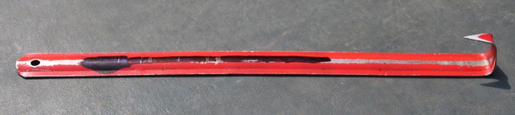

                                Update. Since my spacer / washer mod. I've had chance to have a go at some more different sized drills with this Draper jig. Sadly my mod appears to work only on that size of drill. Inconsistent results seem to be the order of the day for this jig and my patience with it has come to an end so into the bottom draw it goes.
                                I will carry on sharpening drills by hand which I can manage OK down to 4mm. The larger ones I find much easier and the ones with a morse taper are easier still using this:
                                Rik
