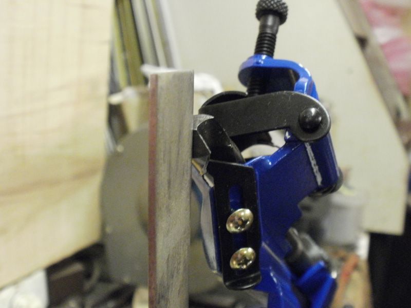

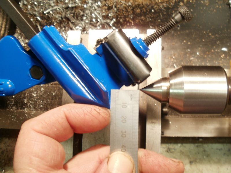

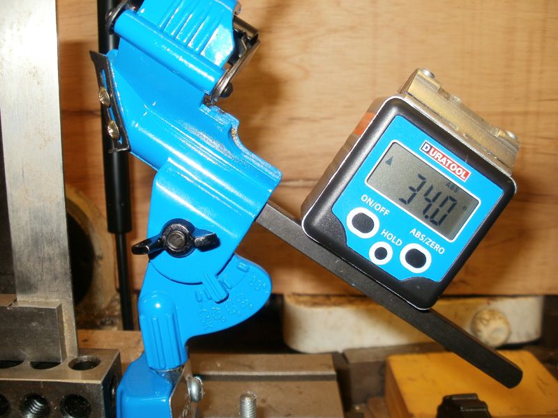

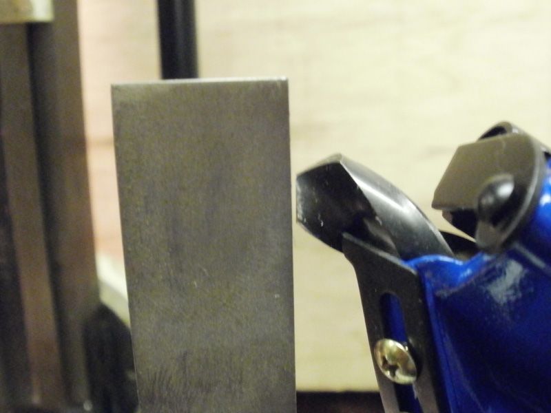

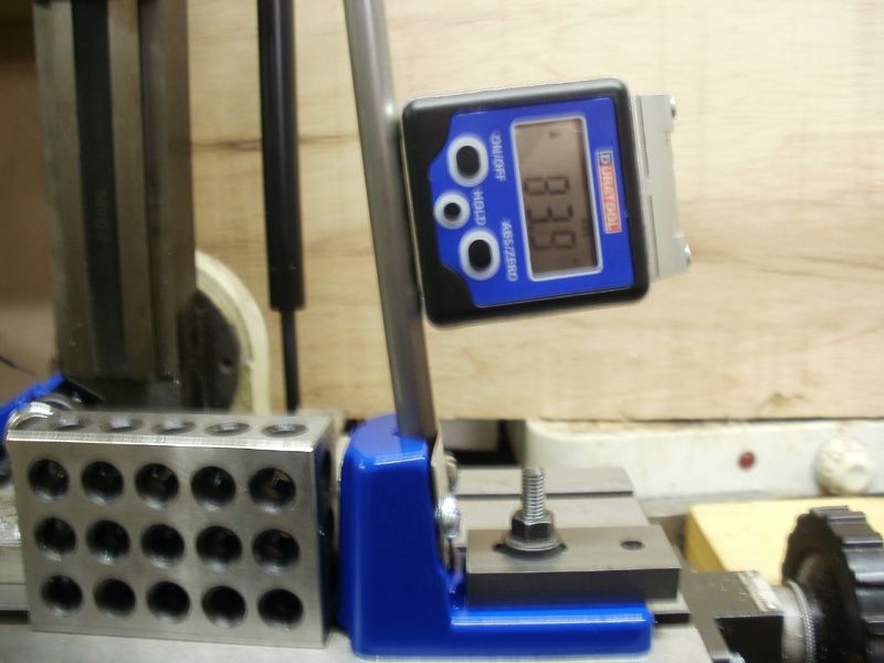

                                            AndyP
                                              @andyp13730
                                              Ok so this thread prompted me to go out and buy one of these jigs to modify because I definitely can not hand sharpen drills and I can't afford to get enough practice.
                                              The Draper jig is significantly different from that which has featured so far.
                                              The angle of the pivot seems to be about 6 deg but not a big issue.
                                              The drill holder sits at 34 deg which I think is going to grind a drill with 112 deg point.
                                              This is where the differences get bigger, the offset between the end of the trough and the centre line of the pivot is around 13mm. The photo has the jig mounted with it's pivot in the lathe chuck and measuring to a tailstock centre.
                                              Setting the jig as per the instructions with the drill protruding by half it's diameter as measured from the tip of the lip stop seems to show a slight mis-match in point angle.
                                              This the jig set up allegedly ready to grind, somehow I expected the cutting edge to be vertical, certainly nothing like the angle shown here.
                                              Some of these differences are easy to fix but the offset difference is huge, any thoughts anybody?
                                              Andy
                                              #152594
                                              ASF
                                                @asf
                                                On my drill sharpener, those two pozi screws (in your last picture) can be slackened off and then the guide can be moved up or down to get the cutting edge vertical.
                                                #152597
                                                AndyP
                                                  @andyp13730
                                                  As I read the instructions that lip stop can only be up against the helix of the drill behind the cutting edge so there would only be one position for any given drill size.
                                                  May be the order of setting the offset and the lip stop is important – I'll go and play.
                                                  Andy
                                                  Ok I have played and it would seem that if I set the drill to protrude by half it's diameter from the end of the trough and then position the lip stop the angle looks a lot better (that is, the cutting edge of the drill when viewed end on is closer to vertical), I could get it closer to vertical by eye but believed the amount by which the drill protruded from the jig was important for the geometry of the thing.
                                                  Edited By AndyP on 15/05/2014 21:35:37
