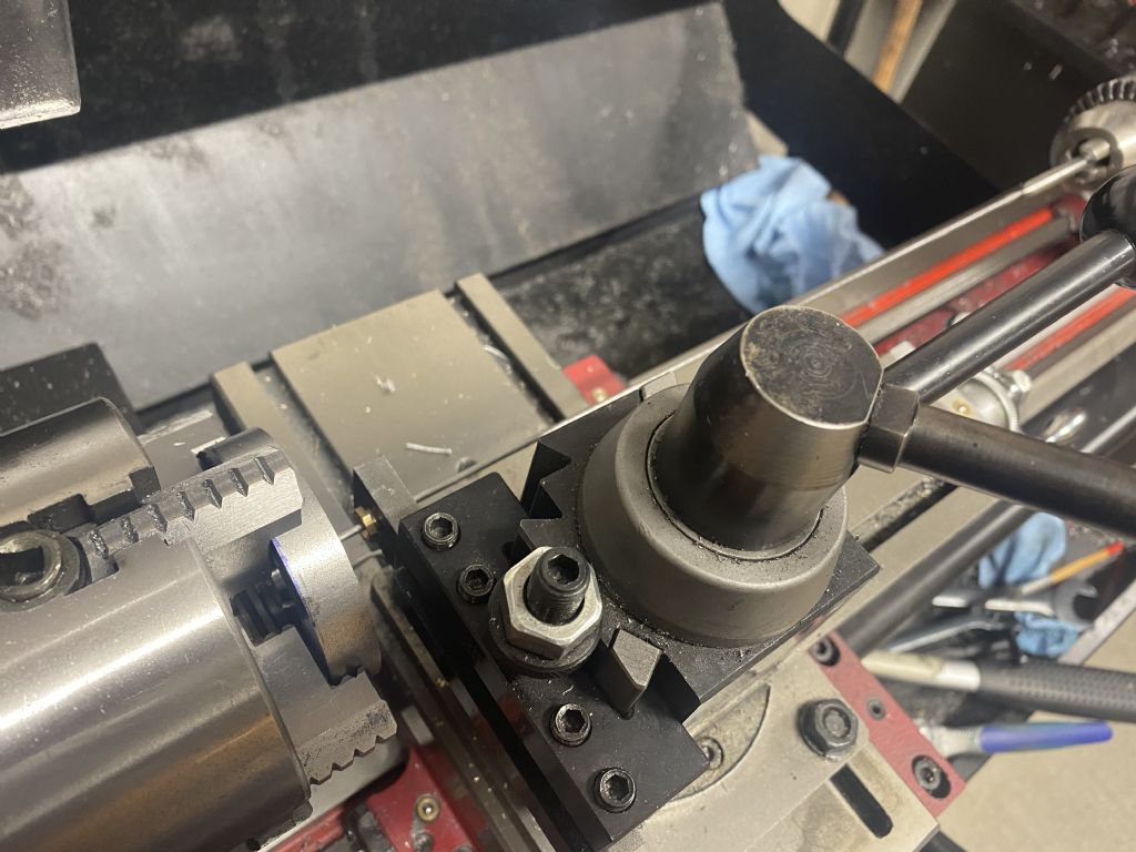

      So, having made the decision to start, I needed to make some tooling. Starting with some small boring bars, I bought the kit from Hemingway and got those made up. Here is the 1/4" bar with a 3/32 cutter bit
      (I had to alter the holders to fit my quick change holder – the cast part is upside down to the drawings)

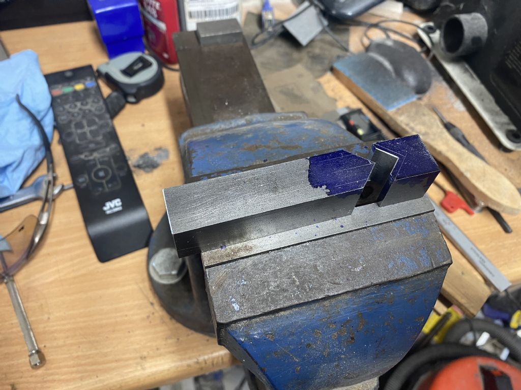

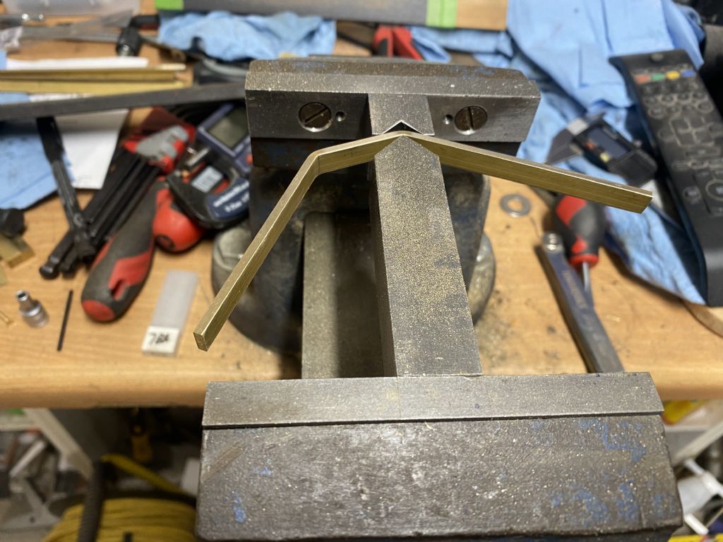

      I also made up the 'vice bending tool' Kozo describes in his book. Here it is sat on the vice the wrong way:

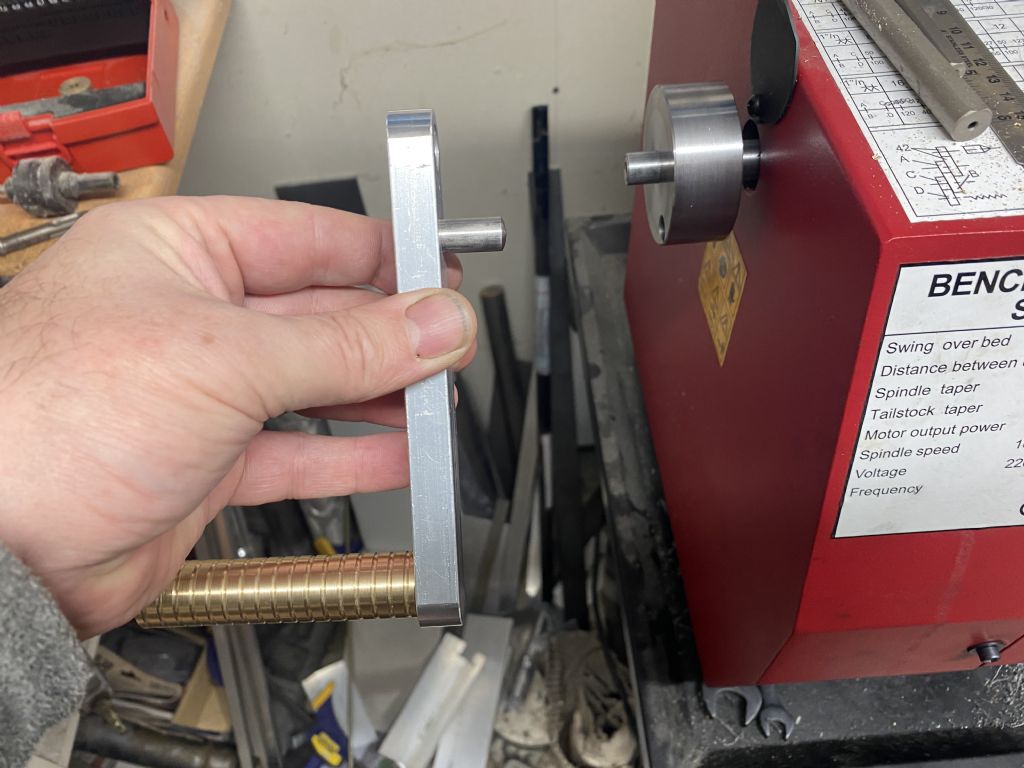

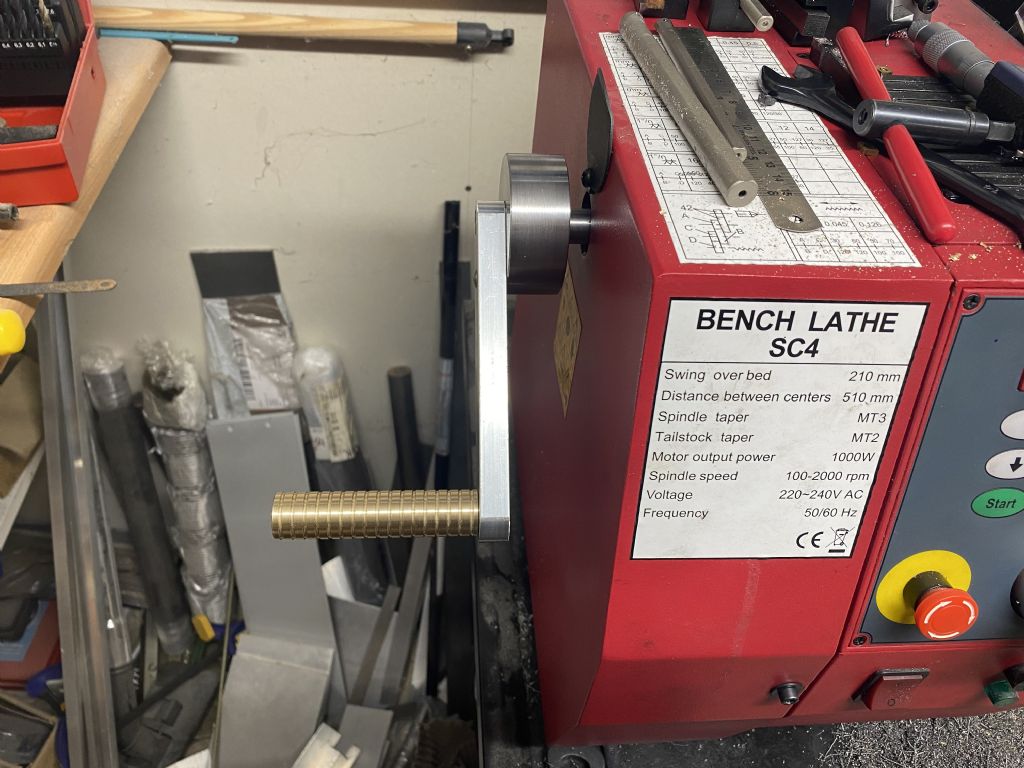

      The other thing I'm soon going to need soon is some way of winding the lathe by hand to make the springs Kozo describes. Apart from being fed up of using the chuck key to hold the chuck when tapping, I have been meaning to make one of these for a while.
      I copied the design from Steve Jordan on Youtube here: Link
      I made it so that it fits without opening the change gear cover, and being quick release, I'm hoping there is less chance of me leaving it in and starting the lathe.

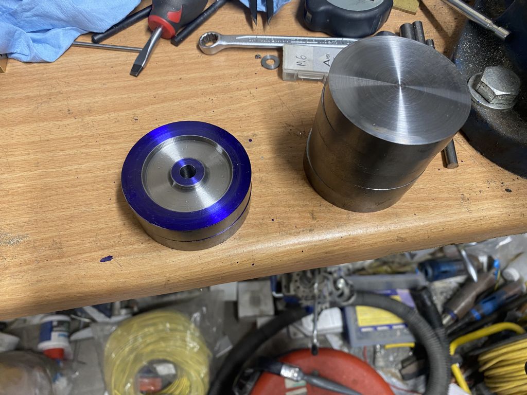

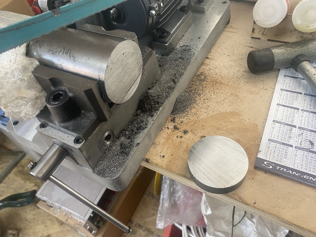

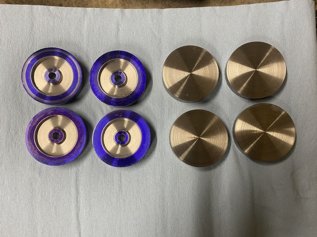

                    Here are a few photos of where I am up to:

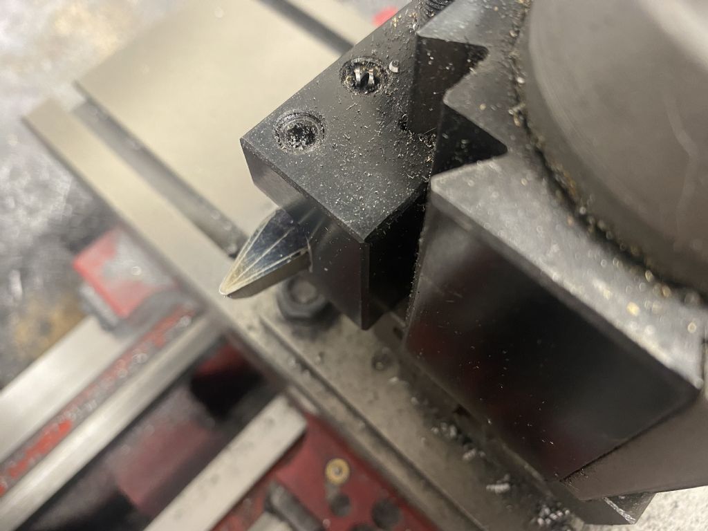

                    My Hacksaw got a bit of work over the last few weeks. As part of the hacksaw build is to remove the fan from the motor, I cut the discs from 2.5" EN1A Leaded bar in about 8 separate sessions per disc – 10 minutes running, then an hour to let the motor cool down. It didn't get really hot, but I didn't want to risk it
                    I gave each a quick skim cut on the lathe then set about grinding up the tool Kozo describes:
                    And with that, work commences:
                    I have gone a little 'off piste' from Kozo's instructions, as my discs didn't cut exactly square, so the plan is to dial in the bore that has been reamed 5/16 in the 4 jaw to dish out the other side. The first one took ages, now I'm getting the hang of it, the last one took about 15 minutes to face, dish, drill, bore and ream.
                    Cheers
                    Mark

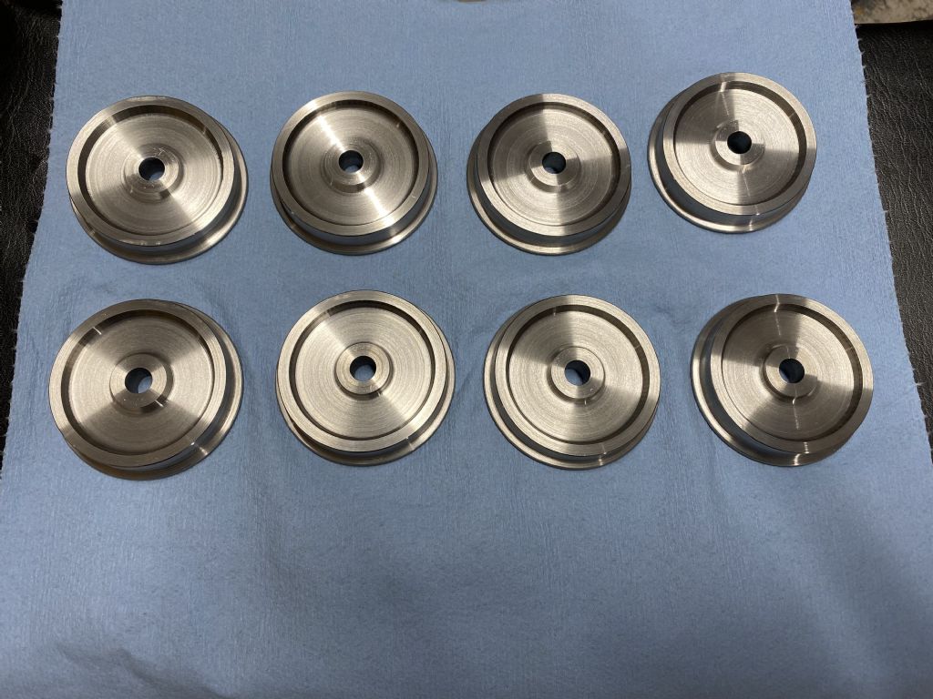

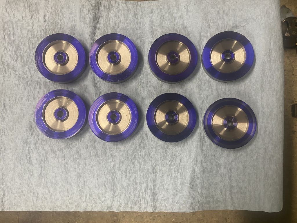

                      I got a bit more done this week on the Switcher.

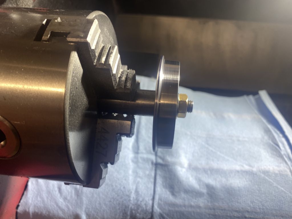

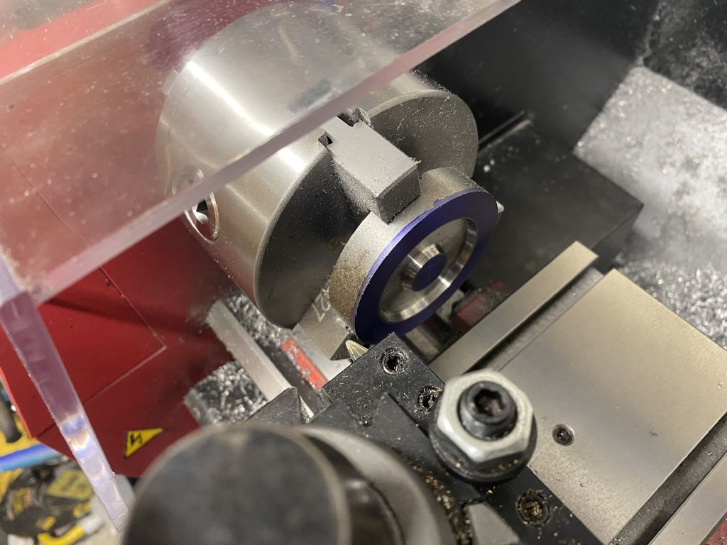

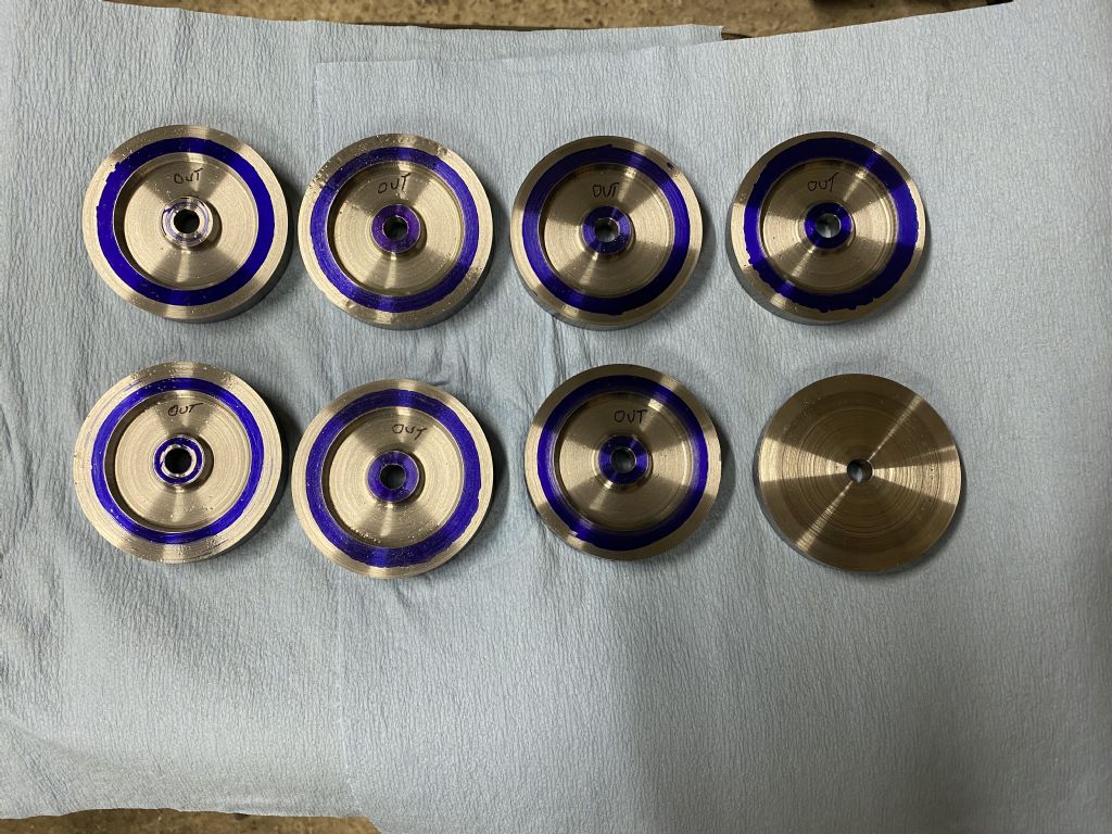

                      All of the backs of the wheels dished out. I did the first side by scribing a circle with a set of dividers onto the blued surface, then taking the cross-slide to the line. They all ended up slightly different sizes.
                      So for the outsides, that will be more noticeable, I came up with a different approach. I noted down the cross-slide measurements at 0, 1mm, 2mm, 3mm and 3.17 then made up a sheet with each cut and where the cross-slide should end up:
                      I made up a little pin to fit inside the axle hole with a small centre spot drilled so that I could mark up the outsides as a 'sanity check' for the outside dish machining:
                      They are all now similar on the outside.

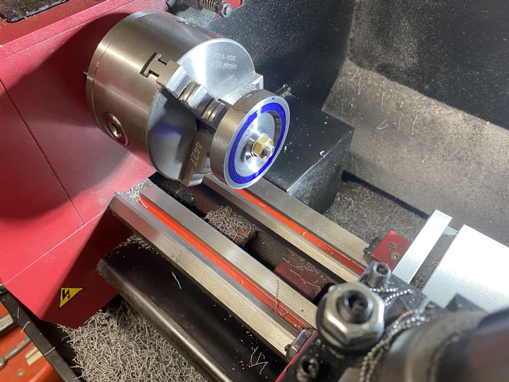

                      Once I got them all finished to this stage, I made up the mandrel and spent a long time getting it to dimension to hold the wheels for the next machining operations:
                      I'm now busy taking them down to finished dimension on the outside, then I can cut the tread and the angles.
                      There is a lot of work in these little wheels.

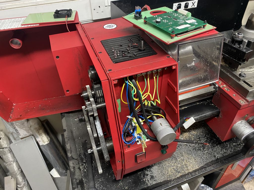

                      I'm having problems with my lathe at the moment. It turns on and the fan runs, but its hit and miss if the speed display turns on and without it, the lathe won't run. I was hoping it would be an easy fix, but it doesn't look like it. Anybody else had a similar fault with an SC4?

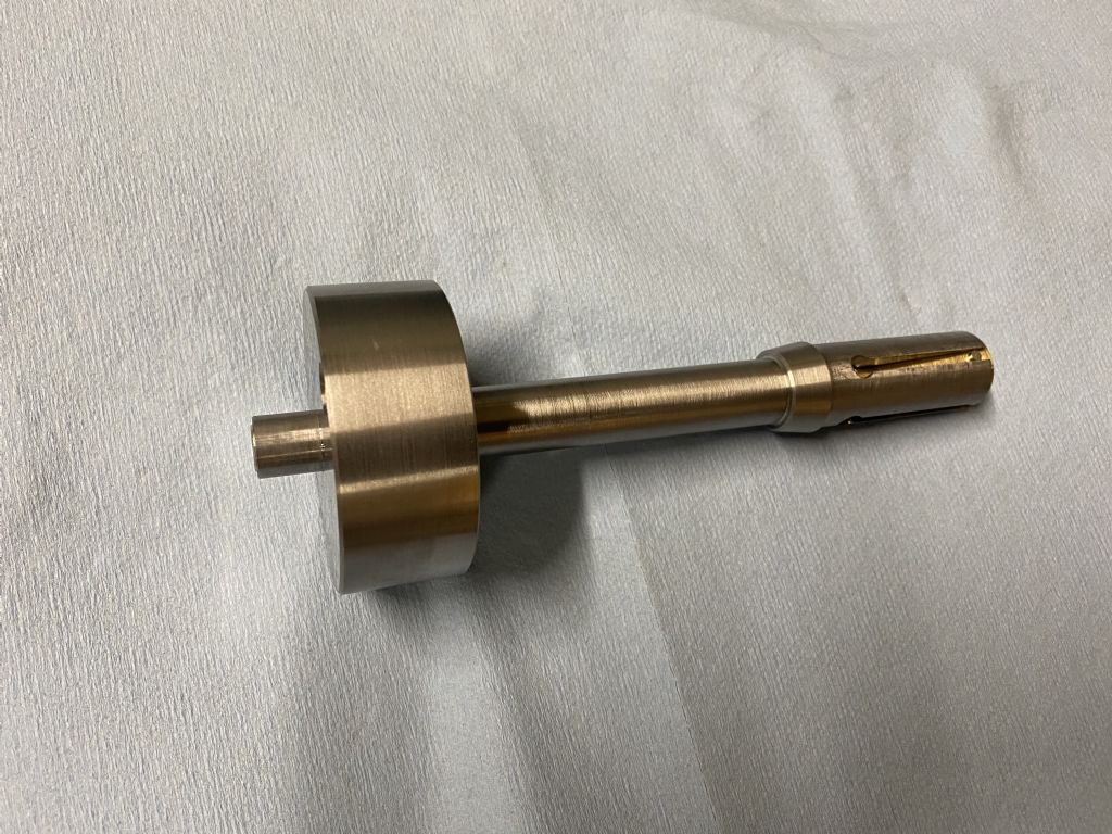

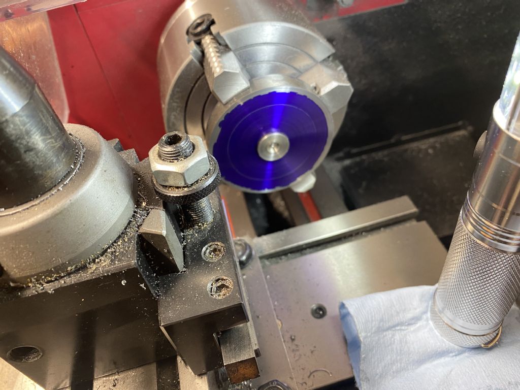

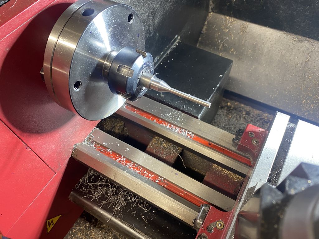

                        One of the tools that I made before I started but forgot to post up was Kozo's centre indicator tool:
                        It is very good. It is quite easy to centre a a centre punched piece in the lathe.

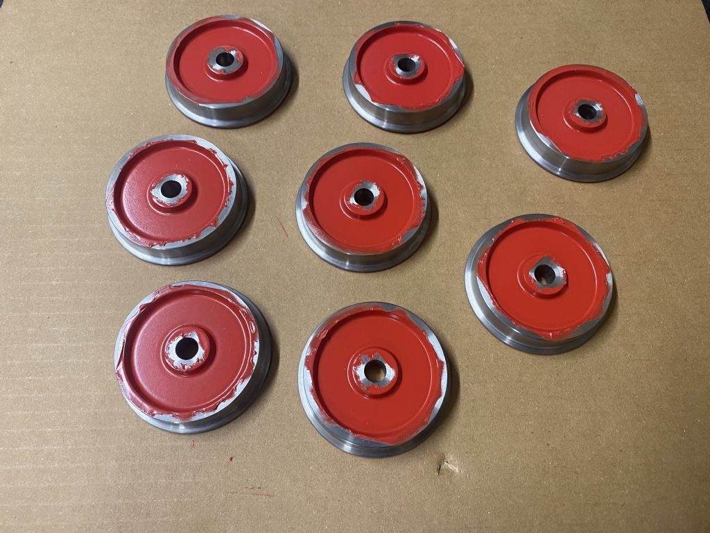

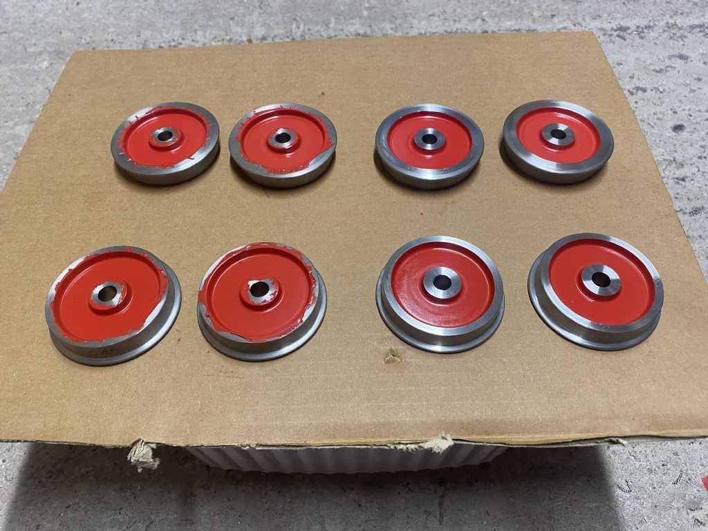

                          I got a bit more done this week.

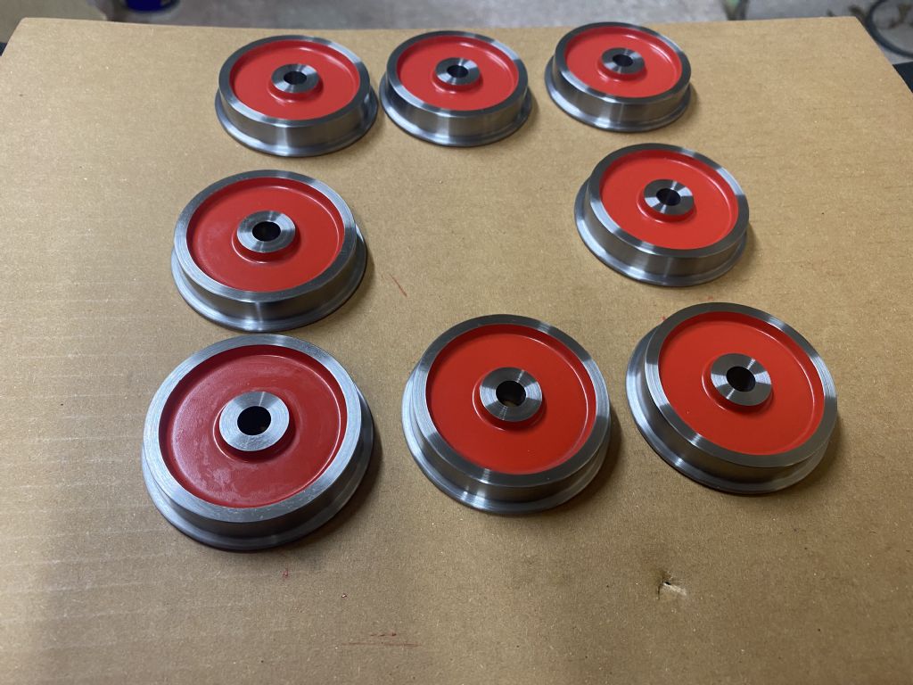

                          I finished off cutting the 3 degree treads and 10 degree angles on the flanges and got them all rounded off:

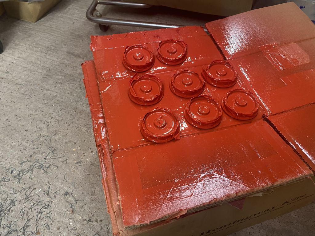

                          I then masked up the treads as best I could and got them sprayed up:
                          I wasn't too worried about overspray on the treads, as it will get sanded off when I finish the wheels. Whilst the paint was going off, I got on and made up the axles:
                          Here are the wheels before sanding:
                          That's as far as I have got.

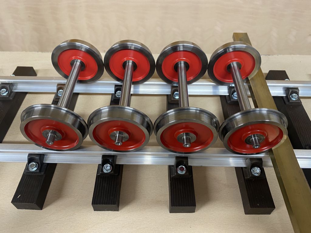

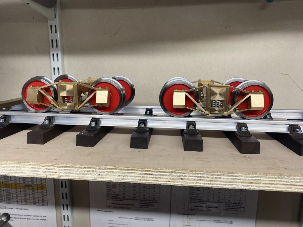

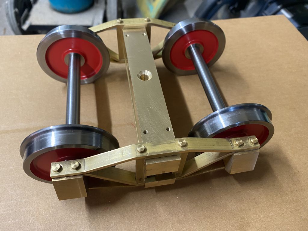

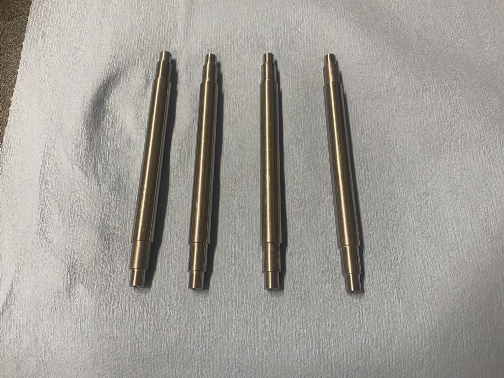

                            The last couple of days I have been sanding the wheels as per Kozo's instructions. As I already have a couple of hand sanding bars that I made up ages ago per Chris's instructions on Clickspring Here I used them, instead of making up another and I didn't like the idea of sanding the tread and flange by hand.
                            Today, the length of track that I ordered, arrived from PNP and I spent a good hour putting it together, just in time to try these out:
                            They have all had a coat of Metalguard Ultra, that leaded EN1a wants to rust by just looking at it.
                            Now they just need to be loctited to the axles and that is the first chapter completed. On to the tender truck frames and journal boxes next.
                            Before I started loctiting the axles to the wheels, I chucked up a piece of Phosphor Bronze, drilled and reamed 1/4" and made sure that each of the ends of the axles will fit to save having to mess about later with the fits.

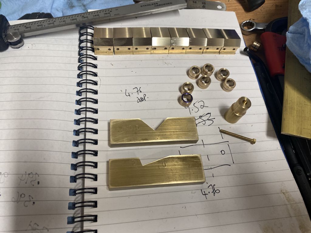

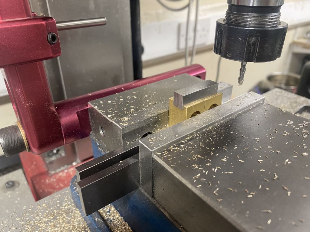

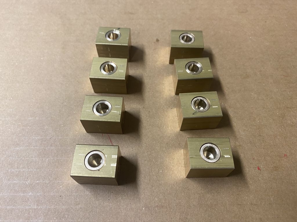

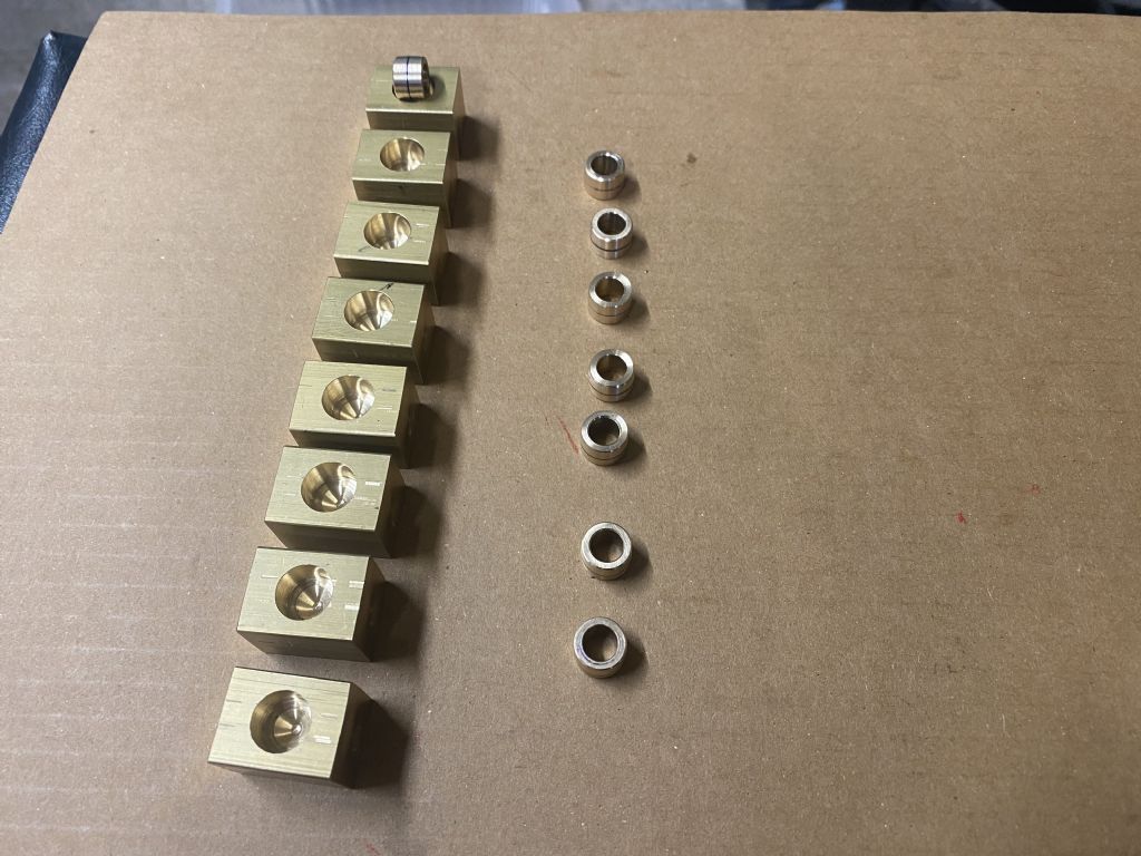

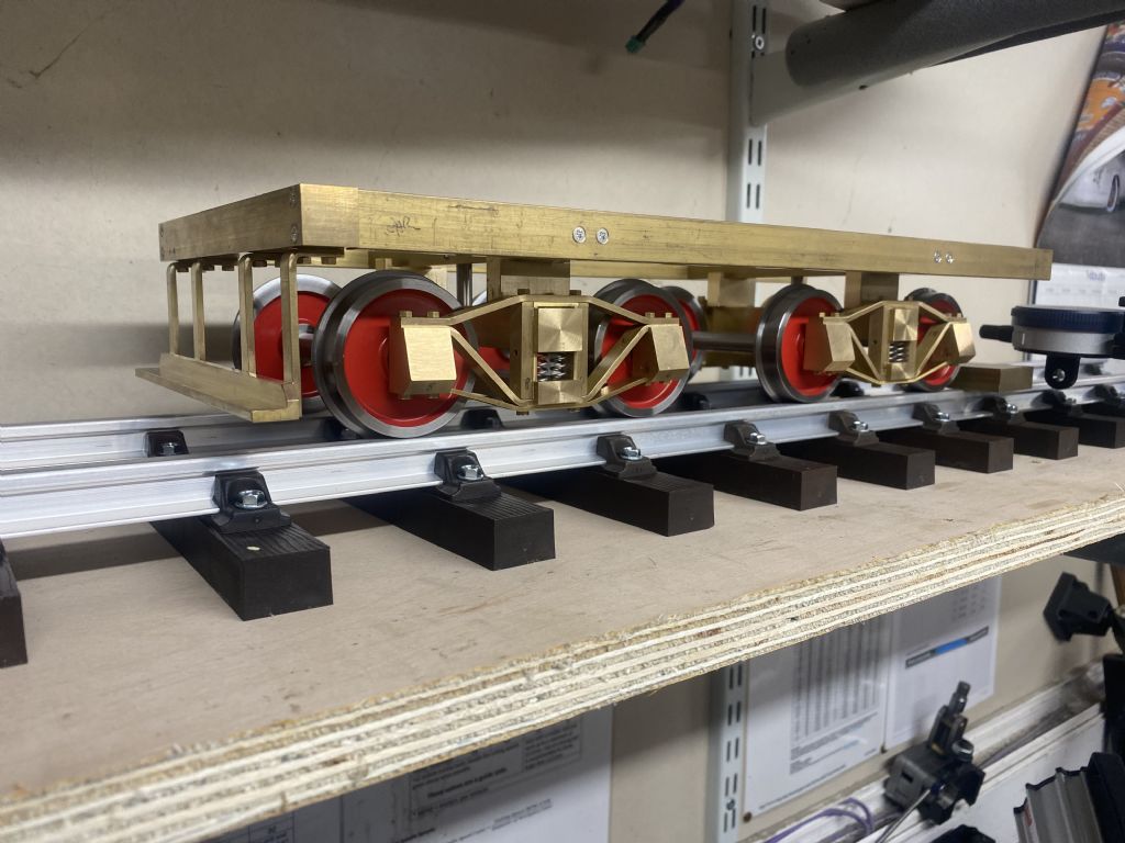

                                I have been busy this week a bit at a time, getting the Journal Boxes and the Bearings made up. First job though was to sort out the Lathe:
                                It got to the point where it wouldn't turn on at all, or if it did, the speed was all over the place, like it had a mind of its own. A couple of weeks ago, I bought a new control board from Arc with the intention of changing it out when it needed it.
                                Unfortunately, because I had the old style board, I needed to change out the emergency stop and the front panel as well. I bought the whole lot from Arc as a bundle and this week, got the whole lot changed over and it has been no problem since. Result.

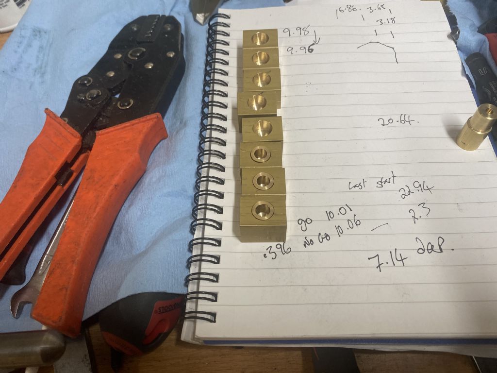

                                With the lathe sorted, I got on and got the Journal boxes to dimensions in the 4 Jaw, then drilled and bored out for the bearings. I made up a go/no go plug gauge at 10.01mm go and 10.06mm no go and got them all done. I only had to throw away 1 where I overshot the 10.06
                                I also got on and made up the barrel shaped bearings:

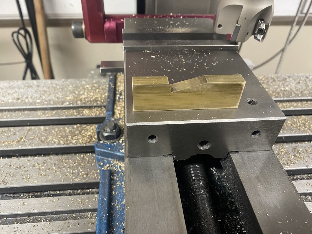

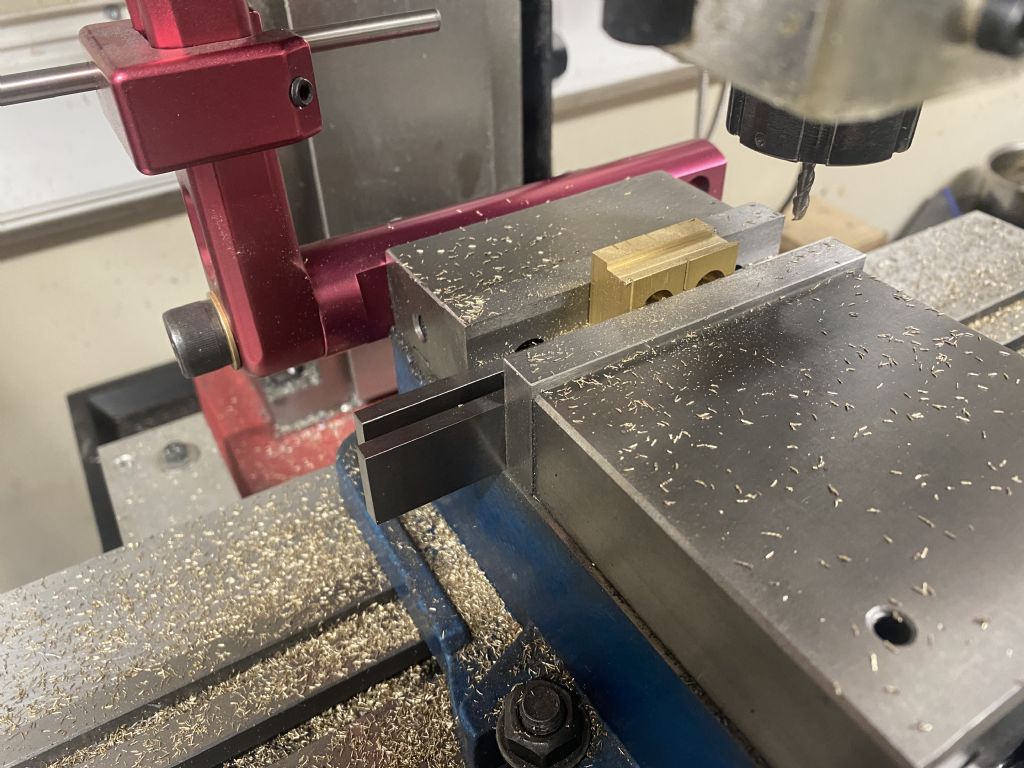

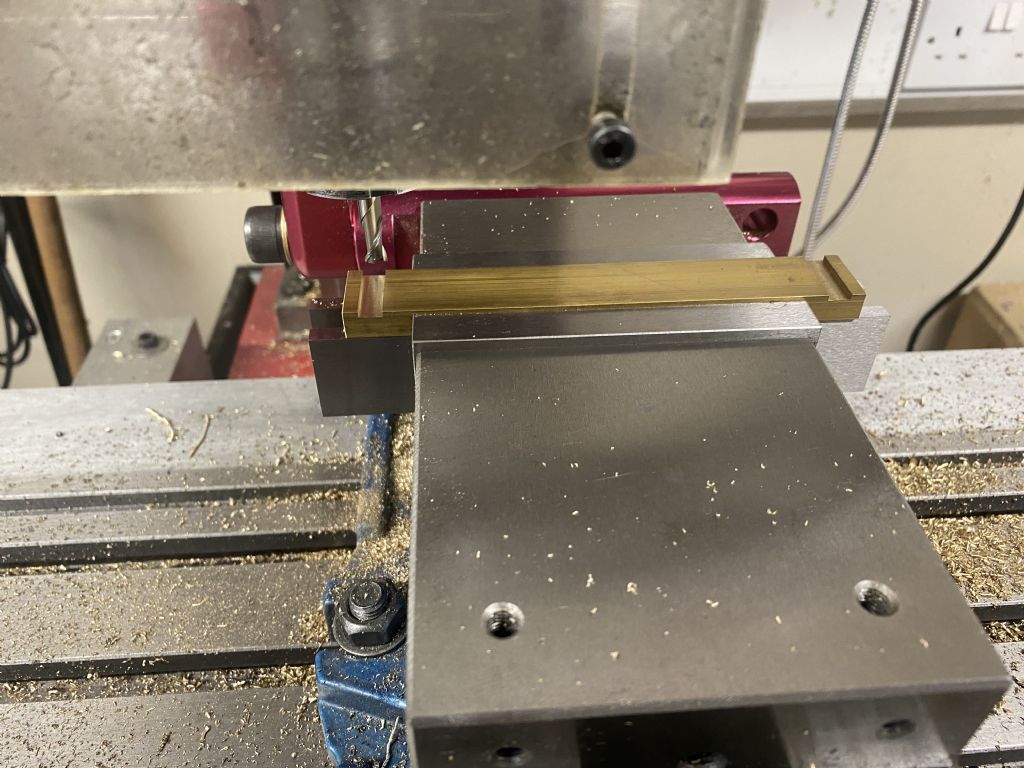

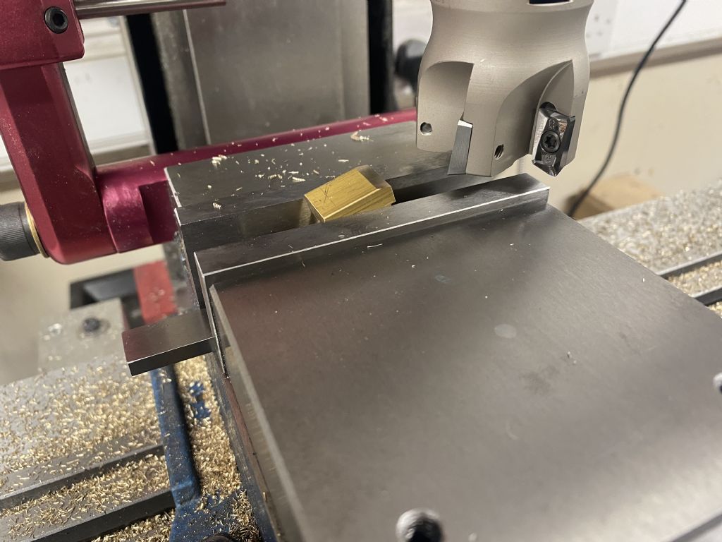

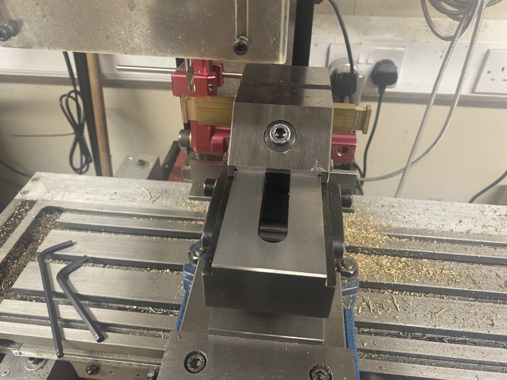

                                I then got the Journal Boxes set up in the mill, 2 at a time and milled out the groove for the arch bars:
                                Using the DRO, I got the first pair done, for a nice sliding fit on my gauge blocks set at 7.92mm (.312) then got all of them done, on both sides, the same.
                                Next up is 32 holes to drill and tap in these – it may take some time. I have decided to substitute the fixings Kozo calls out for these (3-48) with 7BA.

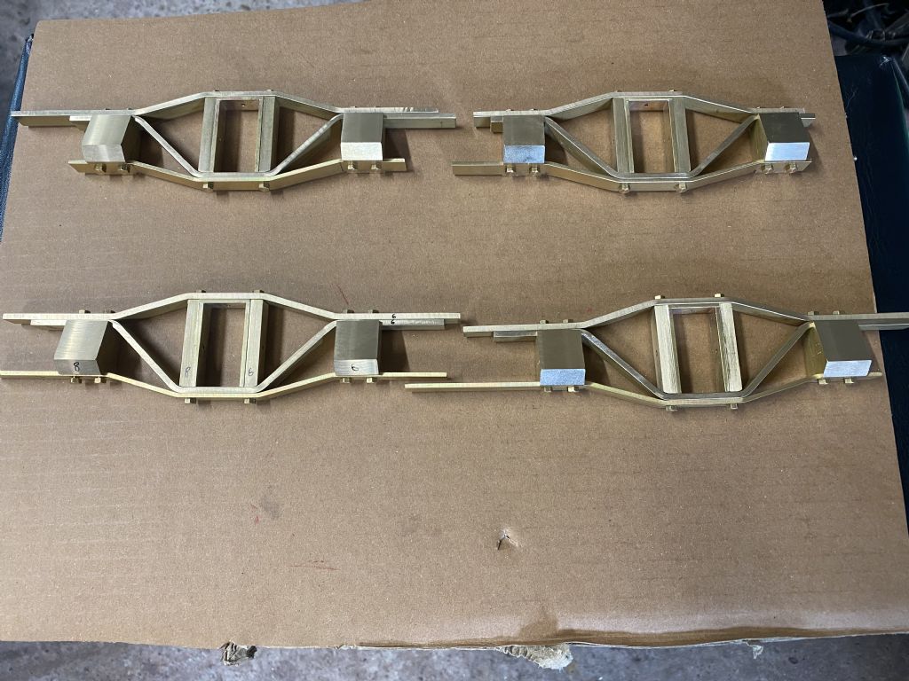

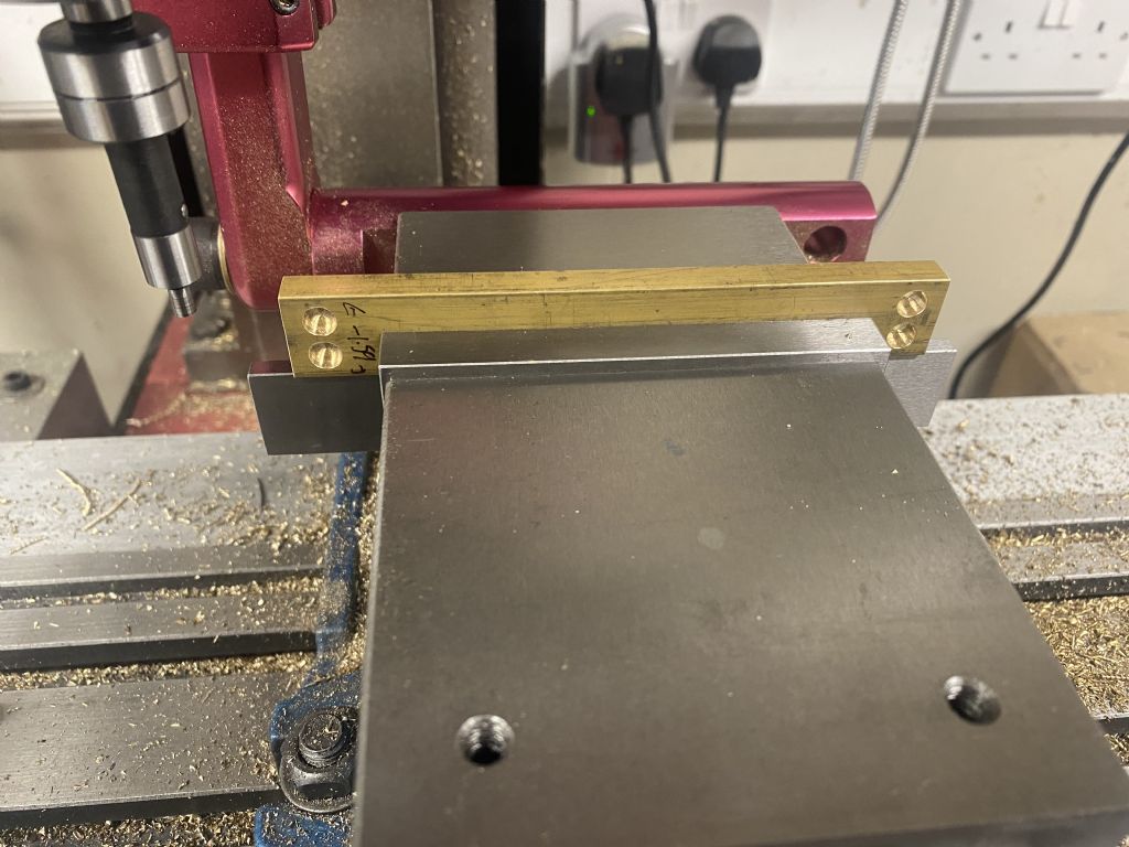

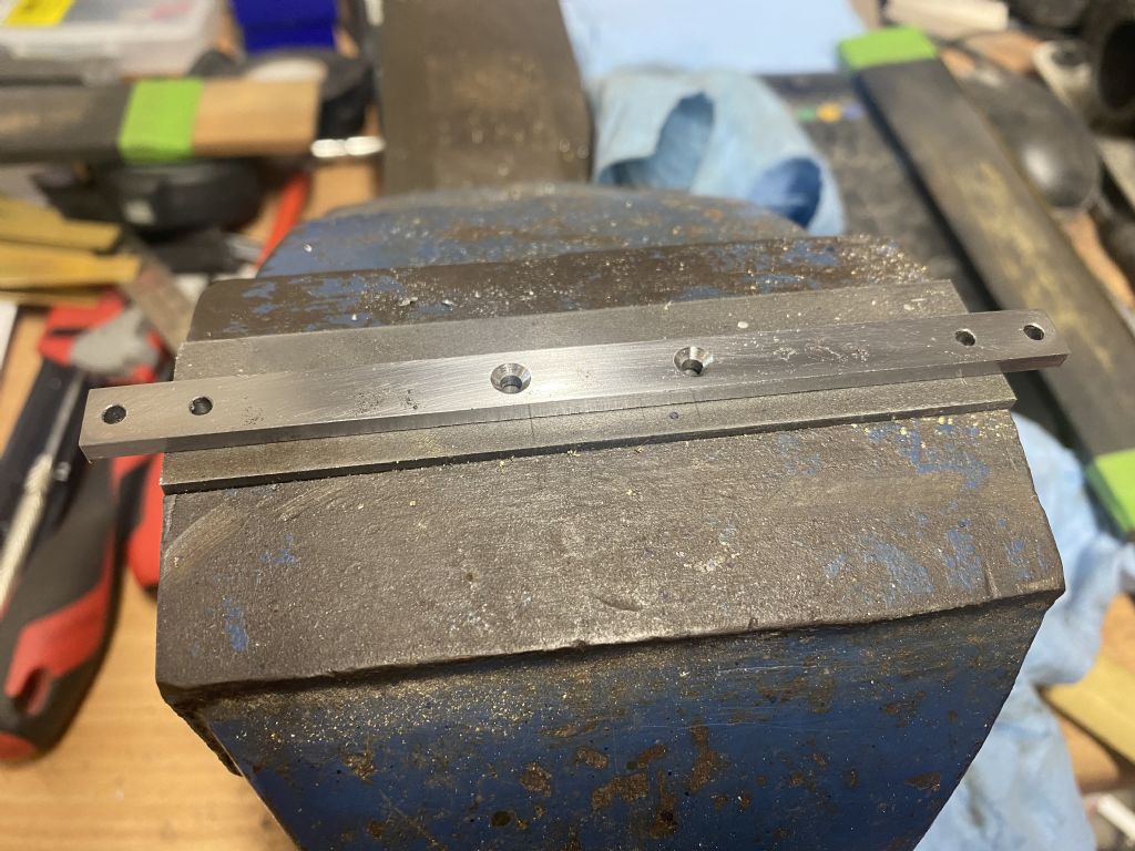

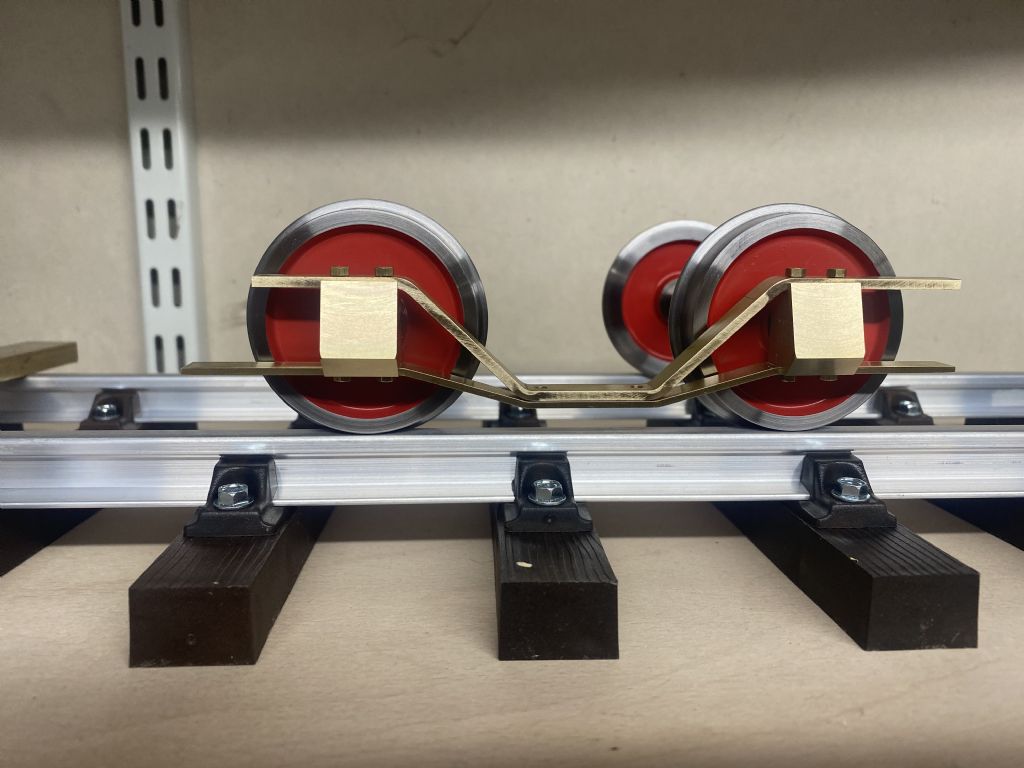

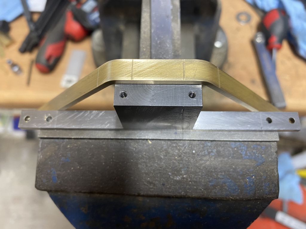

                                  I got a bit more done over the last few days. All of the holes drilled and tapped in the Journal boxes – it didn't take as long as I thought it would, once I got going and into a rhythm with them. I then made up a couple of jigs to mill off the angles:
                                  I'm now in the process of making up the bending/drilling jigs for the arch bars.

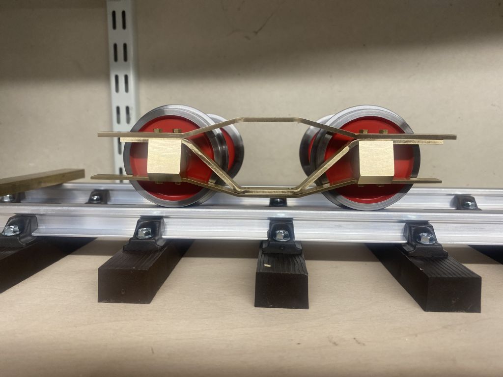

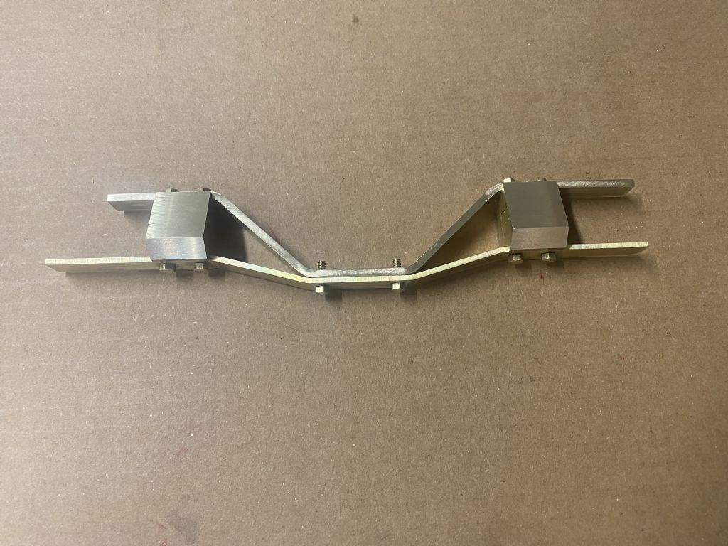

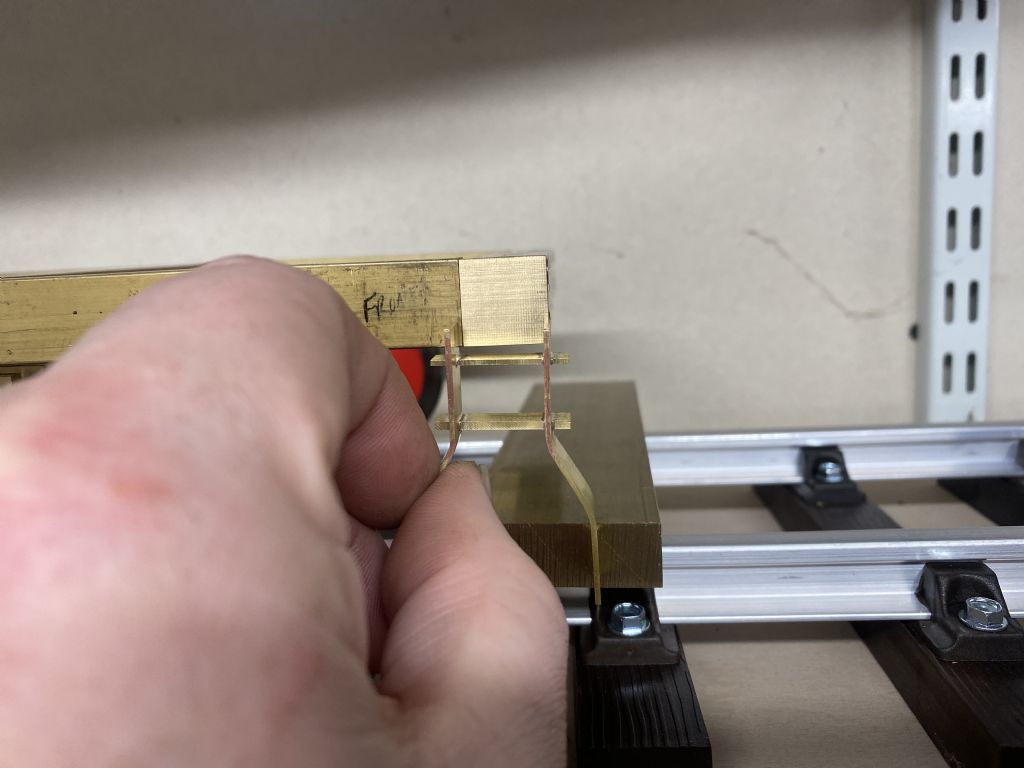

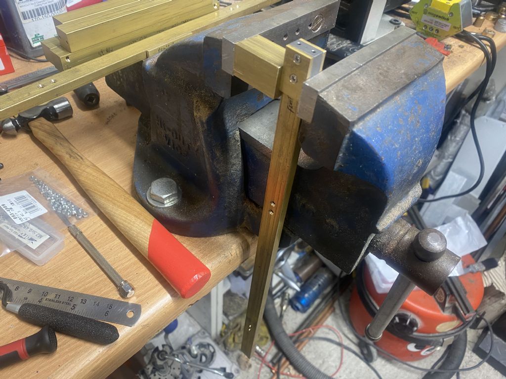

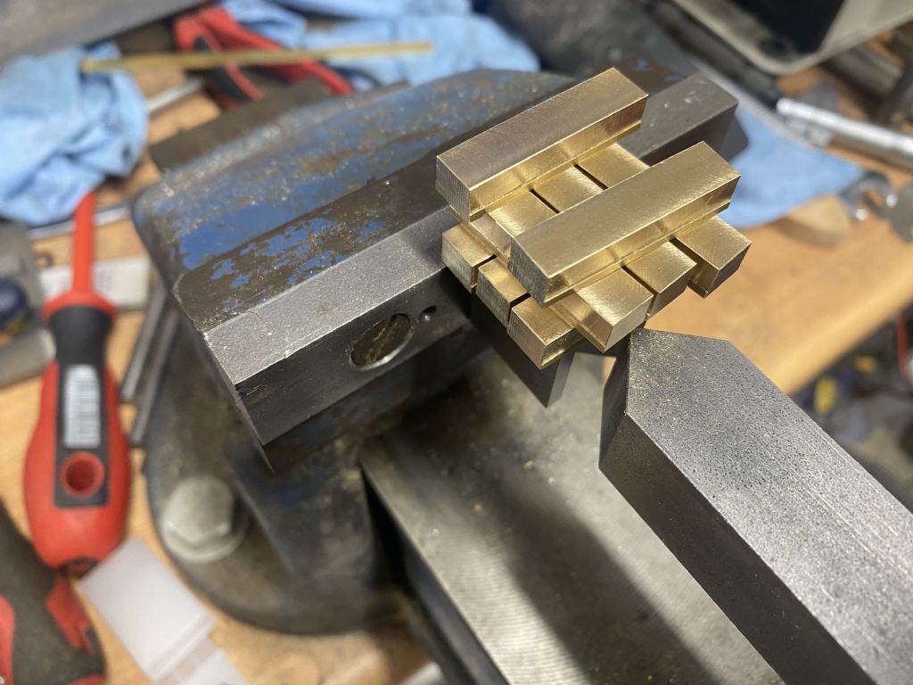

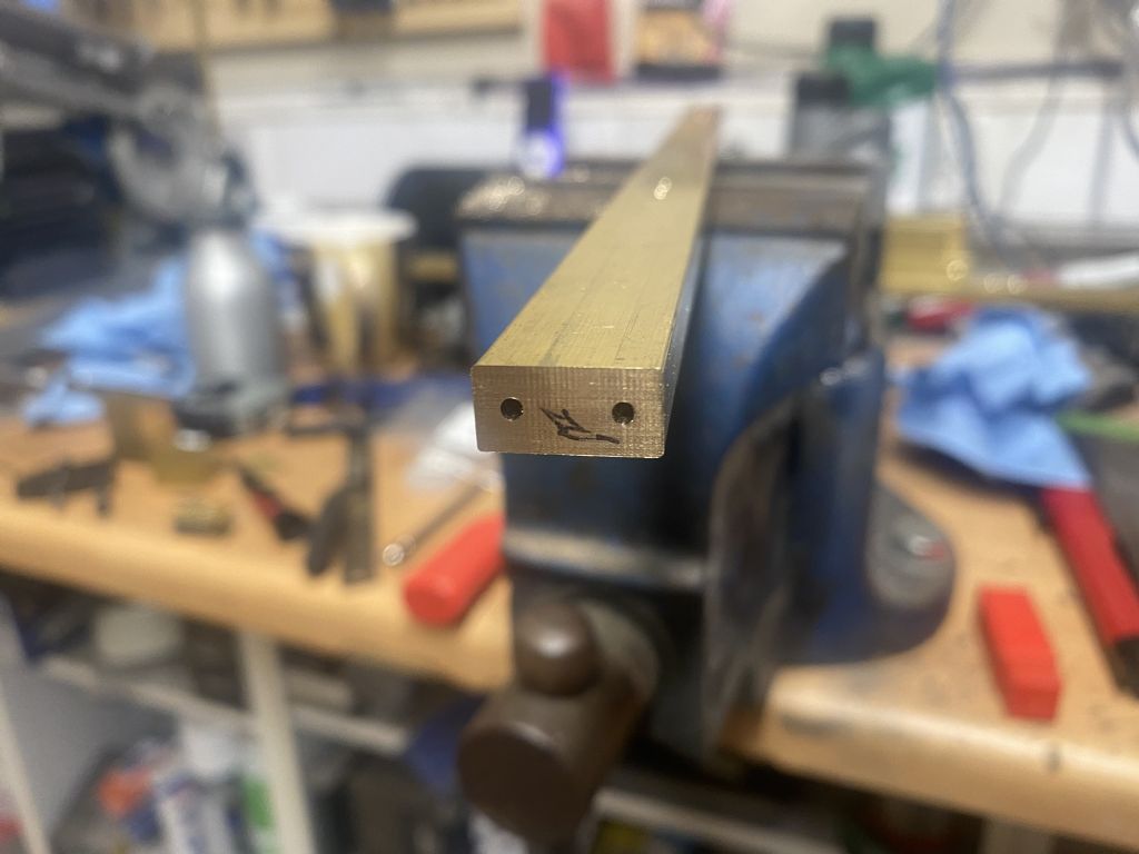

                                    Bit more done this week. I got the Jigs made up, cut up the material for the arch bars and got it brought to dimension then started making up the arch bars. This went amazingly well. Only 1 reject bar that I bent in the wrong place.
                                    The other thing I did was to make up the pieces for the columns. I also had my first go at silver soldering. It didn't quite go to plan to start with. I think I either didn't get the parts clean enough, or I didn't get them hot enough, as the solder ran, but didn't join the parts together at first go.
                                    I did them a second time, pickling them first, then re-read Kozo's instructions and second time went a lot better
                                    I'm pretty happy with them. Kozo's instructions are spot on. They all fitted together beautifully.

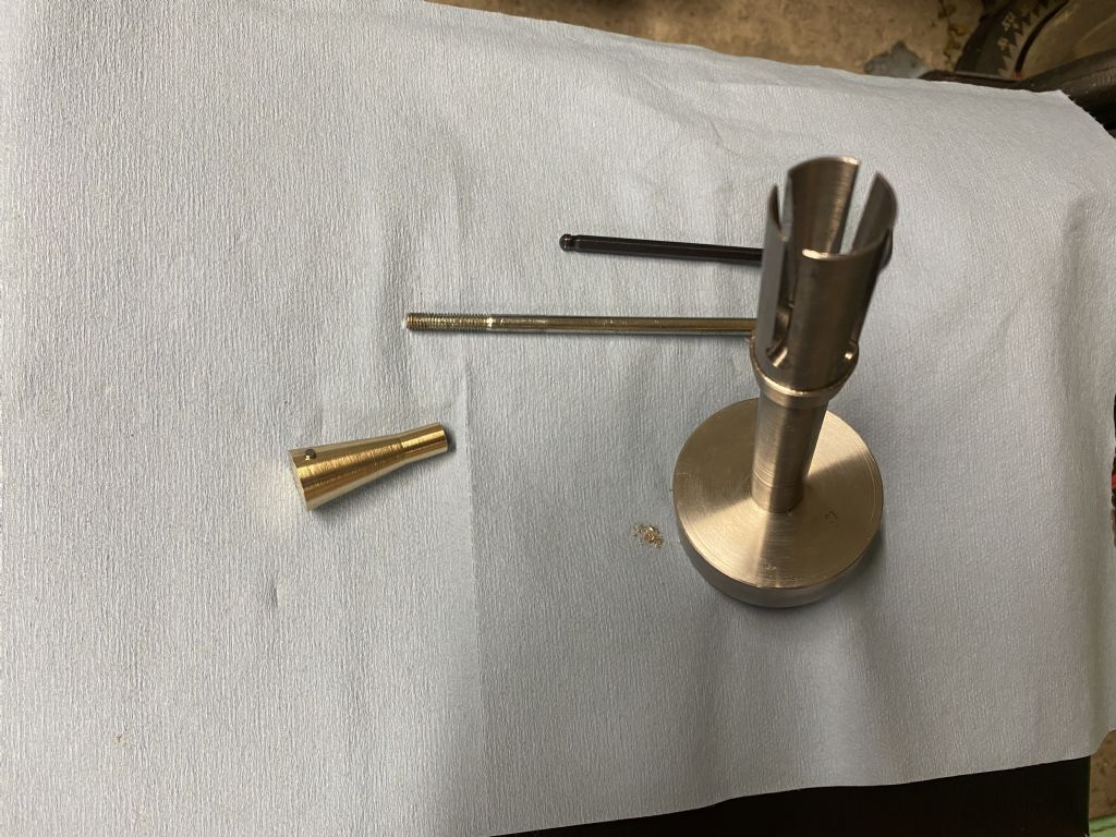

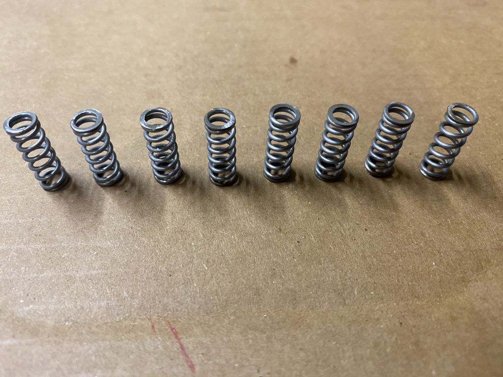

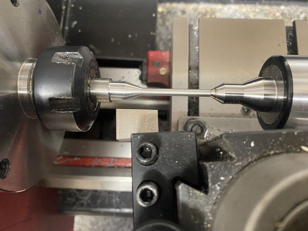

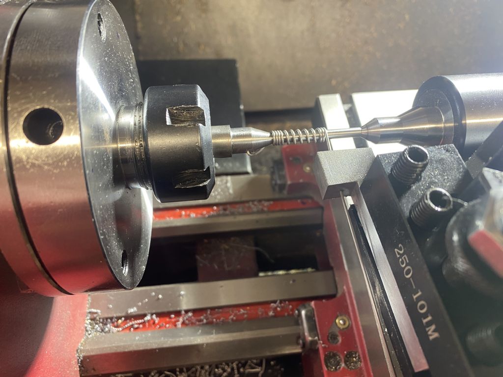

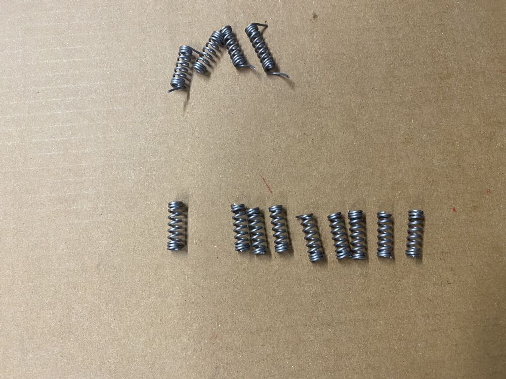

                                            I spent today making up the tooling and getting the springs wound and the ends ground down. Kozo's instructions are spot on – the springs are shown in the drawings as .240" OD – in my language 6.09mm, mine turned out at 6.05 – thinking about it, when I bought the spring wire for this (and for all of the other springs) I couldn't find any .039" only .038" – there is the missing .04mm
                                            Having made up the winding handle at the start of this project, it got a lot of use today.
                                            Here is the result of the winding session before grinding the faces- I actually made 10 that were good, the top 4 were either too long, or too short

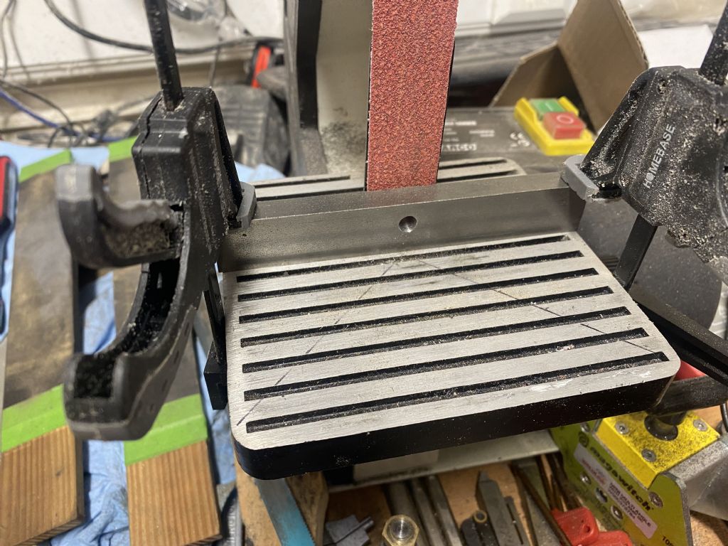

                                            I then drilled out a piece of spare steel bar and set it up on my bench sander to grind the faces. The grinding took a long time this afternoon, as I didn't want to get the ends too hot or overshoot the dimensions.
                                            And here are the best 8 ready to use

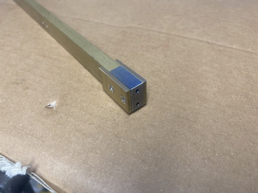

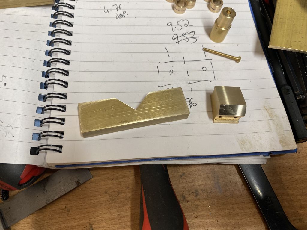

                                              I have been busy this week making up the bolsters. They took longer than I expected due to the 3 degree angles on the sliding surfaces. I set up and milled the slots down to the maximum dimension, then set up again with the sine vice to mill off the angles.
                                              Kozo gives some pretty tight tolerances for these. On the first lower bolster, I overshot the fore-aft dimension of the slot by .06mm, all of the others are on the tight side of tolerance. I'm umming and ahhing as to making up another lower bolster.

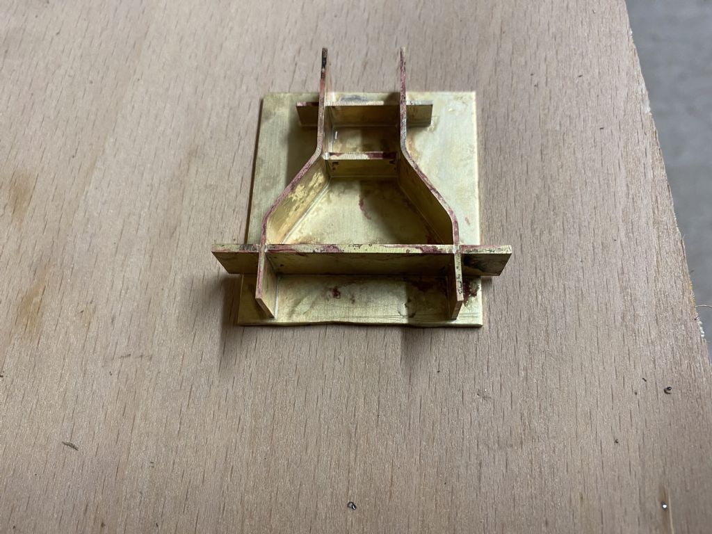

                                                    I got a bit more done this week. Starting with the tender frame. Not very exciting, just drilling holes and getting the stock to length. The bit I wasn't looking forward to was drilling and tapping the holes in the long side members. At over 15" they were too long to go in either my mill, or drill press. I ended up making a 'drilling jig' as a tight sliding fit on the end of the side member, then after drilling, I opened up the holes in the jig, to allow me to use it as a tapping jig. It worked a treat.
                                                    There are still some holes to drill in the end sills, but it is mostly complete.

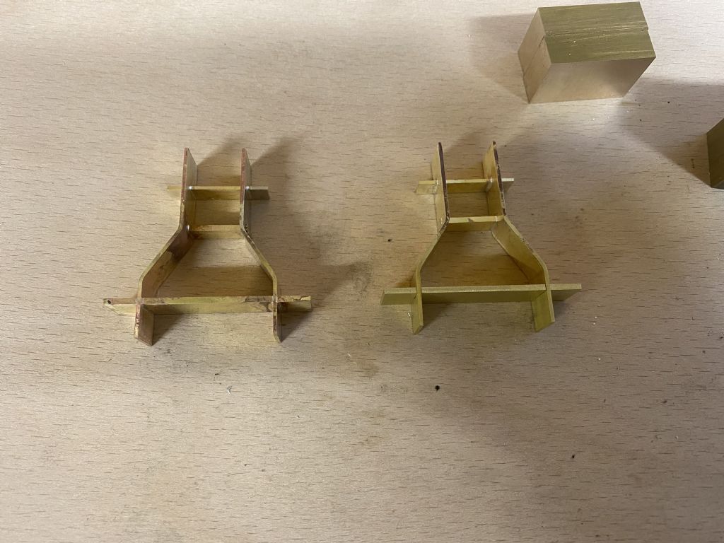

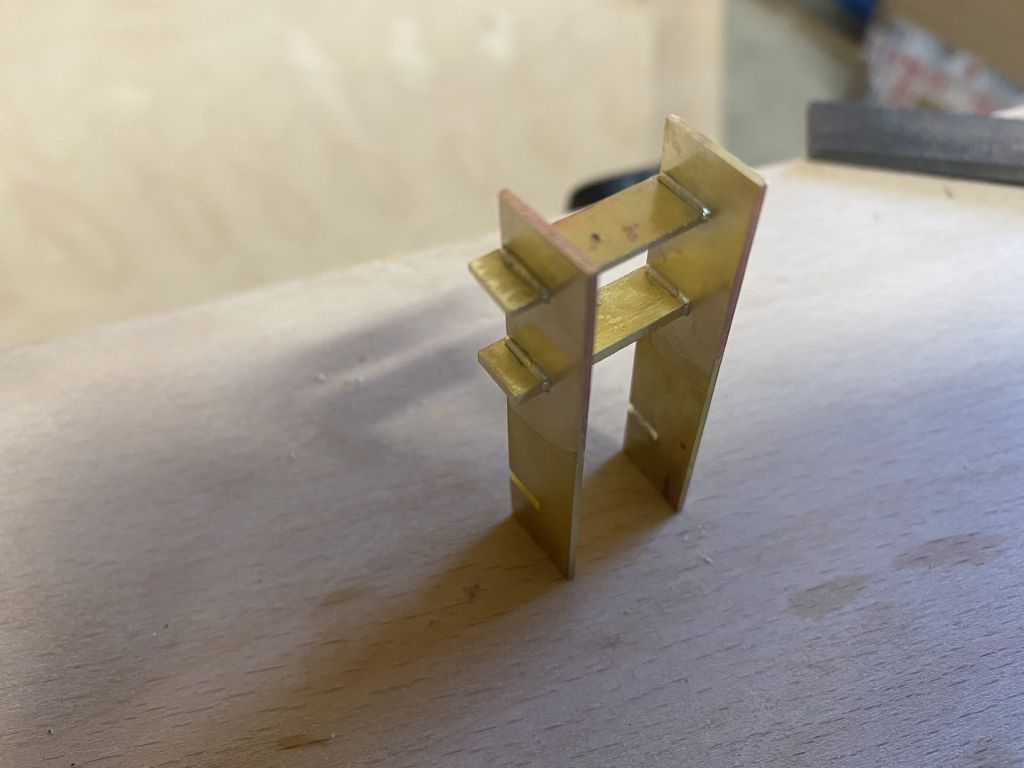

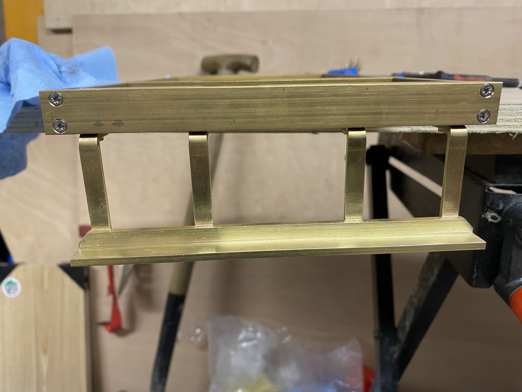

                                                    With that, on to something a lot more interesting, fabricating the front steps

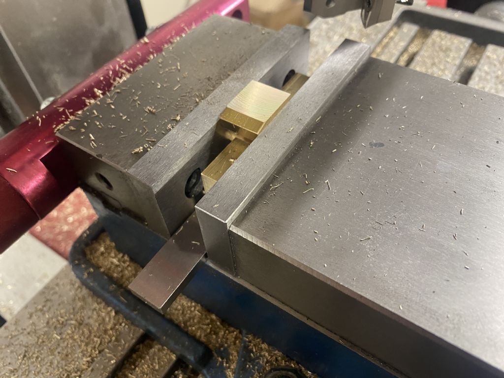

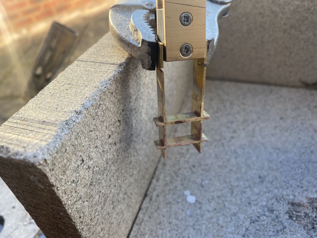

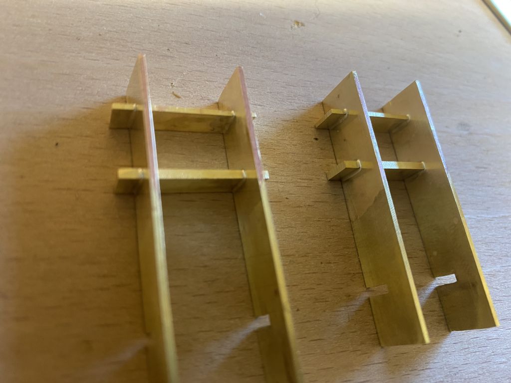

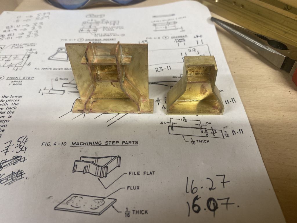

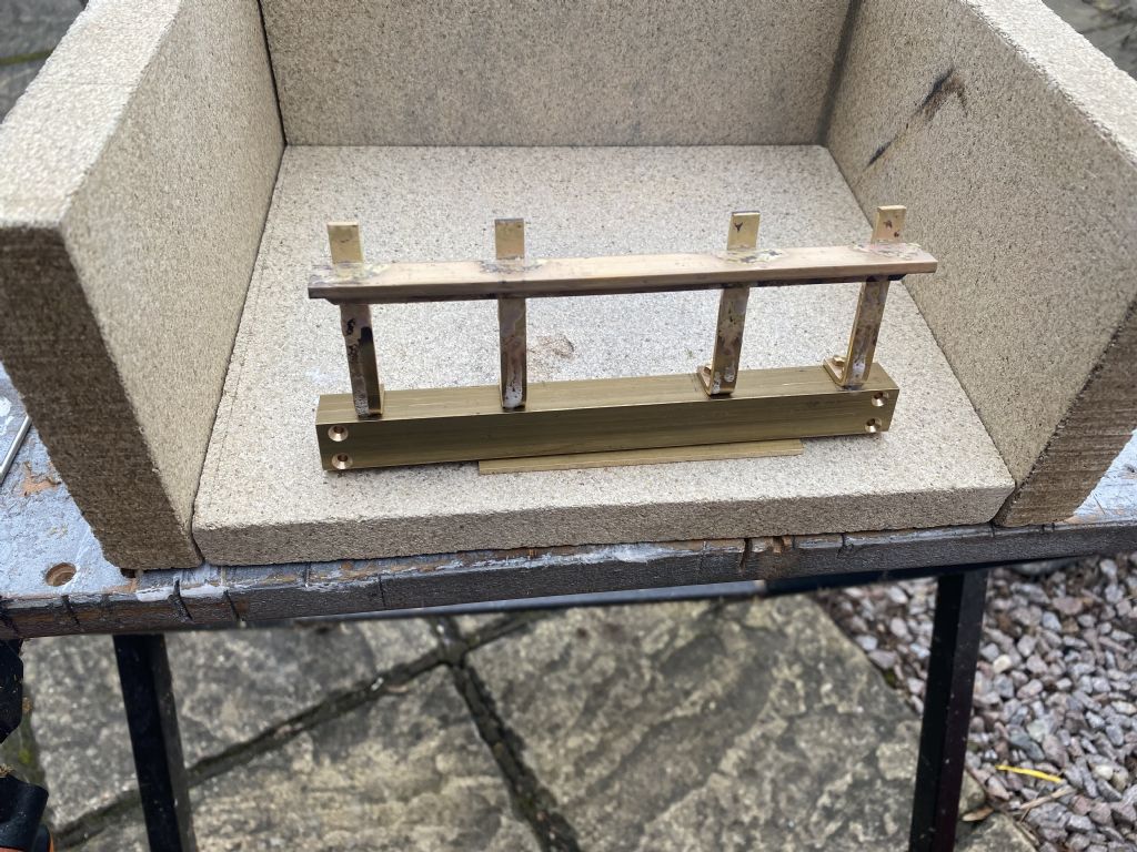

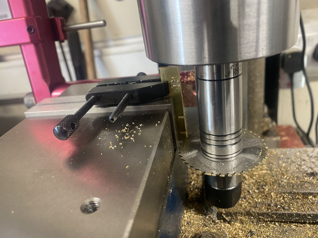

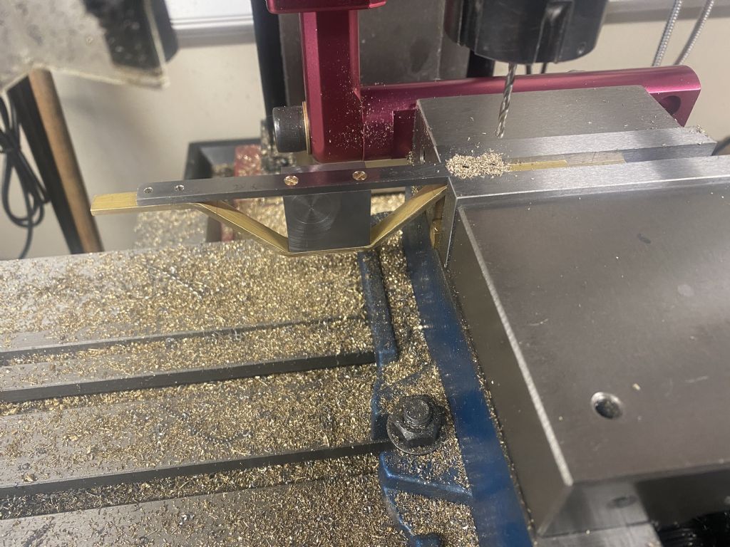

                                                    I cut up some small .04" strips and set them up to make the slots. Kozo shows using a vertical saw, I set mine up horizontally and took it really steady
                                                    Then got all set up and silver soldered the first step
                                                    I got the other one done to that stage as well. I was very happy with the silver soldering as I'm still a very novice beginner.

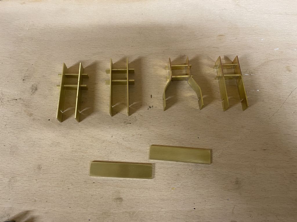

                                                    This is where it all went wrong. I had miscalculated the measurements for the slots in the steps somehow, and instead of them measuring 5/8" external at the tops, mine were 5/8" internal.
                                                    So, I started again, this time making double sure I got the slots in the right places
                                                    I'm now waiting on some 1/16" brass sheet to finish the backs of those, so have moved on to making up the rear step. Photos later
                                                    Cheers
                                                    Mark
                                                    #524630
                                                    Mark Elen 1
                                                      @markelen1
                                                      I seem to have got a load done over the last week. Helps that I'm not having to go to work at the moment. While waiting for the 1/16" brass sheet to arrive, I got on and made up the rear step:

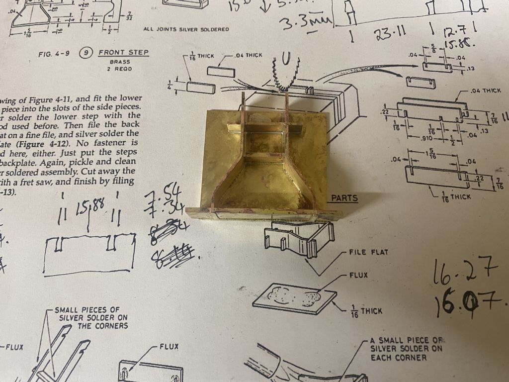

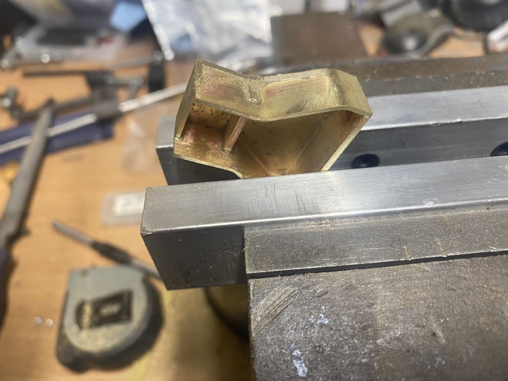

                                                      When the 1/16" sheet turned up, I got the steps silver soldered:
                                                      Then started cutting and filing to shape:
                                                      There is still some work required to file the fronts to shape, but as its going to be 'freehand' I'm putting that off until I get some inspiration.

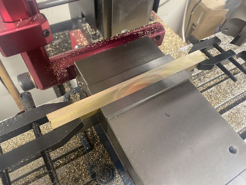

                                                      I then got on and made up a 'grooving tool' to take a hacksaw blade:

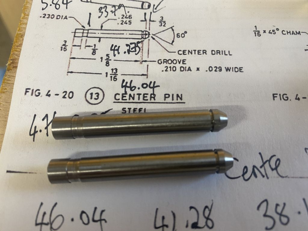

                                                      Then got the pins made up for the bolsters:
