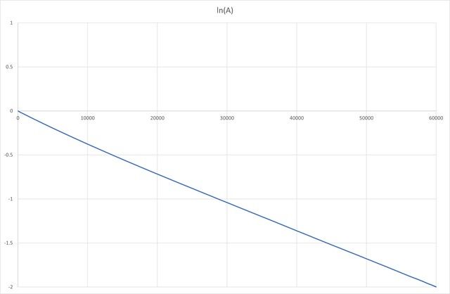

      I thought that the following example of a run-down test might be useful. I took this from my new pendulum just after replacing the spring and rod. Essentially allowed the amplitude to stabilise at just above the intended operating point, then switched off the impulsing and logged amplitude as it decayed, measuring it basically by the photogate time.
      The plot shows the natural log of amplitude against beat time (essentially seconds). Nearly a straight line with a barely visible "kink" after about 15000 seconds. The first part of the run (around the eventual operating point) yields a Q of about 22,500. Andrew Millington pointed out that the Q improves at lower amplitude to about 24,500. There are essentially two flow regimes around the bob it would seem, at larger amplitudes there is an increasing square-law dependence of drag on velocity whereas at lower amplitude it is essentially linear. Note that the curve is very clean with very little scatter of the points about the trend line.

        So if SOD measured Q by rundown and got the same answer as by bandwidth the argument would be resolved. I must admit some doubt over trying to measure energy loss whilst putting energy in feels problematical. Of course he might already have done this and reported it previously, my attention span isn't what it was.

              Wikipedia has a good collection of information on Q. Includes a couple of useful formulae.
              Time constant of decay T = 2Q/Wo where Wo = 2pi/To (To is the full period).
              Then amplitude decays at A = Ao.exp(-t/To).
              Setting A/Ao to various convenient values such as 0.5 or 1/e then gives the various formulas for Q in terms of number of cycles that have been quoted.

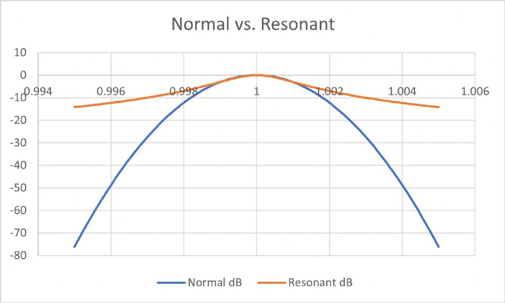

                                I thought it would be interesting to directly compare the normal distribution curve with a resonance curve according to the equation Dave quoted above.
                                In this picture the normal (blue) curve is plotted using Excel's normal distribution function normalised so the peak is unity. I've normalised the mean to unity and the standard deviation to the value that Dave measured divided by his period, to give 0.001194. I've plotted the vertical axis in dB to make it easy to compare the 3dB points. I wasn't quite sure how to render the vertical probability axis in dB since it doesn't really have a meaning but I chose 20*log10 to match what I did with the resonance formula. The resonance curve (orange) used the same centre frequency of 1Hz and I twiddled the Q to to get the -3dB points to match the normal curve, which needed a Q of ~500.
                                What's obvious is that though the curves are similar around the peak they diverge hugely as one moves away, by 10s of dB.
                                It seems to me that the period error must depend on the Q, obviously, but also on the "noisiness" of the whole oscillator, and the amplitude of the oscillation which the noise is perturbing. Those factors are captured in the equation I posted. Clock B is a nice example – the pendulum has a rather low Q compared to most regulators, but it swings with about 4 – 6x the amplitude, the drive torque is very accurately controlled with a remontoire, the escapement minimises frictional variation of force, the whole thing is extremely massive and (for the critical tests) was mounted on a masonry column embedded in boulder clay; and finally the pendulum is temperature and barometrically compensated.
                                I think Dave's distribution looks very gaussian (normal) and is actually a very useful measure though not of Q! It tells us I think that the systematic variations are pretty small and most of the fluctuations are random, though they could be due either to the oscillator or the measurement system.

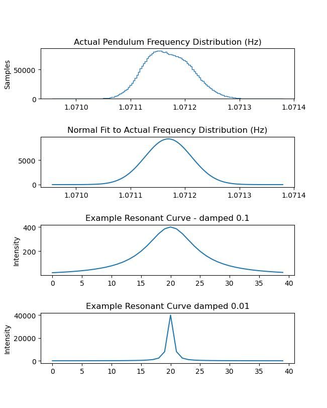

                                  No point in denying it – I'm worried, and have been since John emailed a couple of his papers to me last week . Not quite convinced myself yet I'm wrong about Q but I trust John's judgement in this area. So I spent this afternoon bashing my brains in hope of understanding it!
                                  Doesn't prove anything but I produced these similar graphs, also comparing normal and resonant curves:
                                  First up is my pendulum's frequency distribution.
                                  Second is my pendulum's frequency distribution fitted to a normal distribution. The match is good suggesting my pendulum is producing normally distributed periods.
                                  Third is a resonant curve generated from this formula found under 'Universal Resonance Curve' in Wikipedia's Resonance article:
                                  ω is the natural resonant frequency
                                  Ω is the drive frequency
                                  Γ is the decay factor
                                  Damping the third curve with a decay factor of 0.1 produces a curve similar to the actual pendulum distribution
                                  Fourth graph is the resonance curve generated with a lighter decay factor. As expected it produces a much sharper curve.

                                        With the greatest respect and empathy, Dave … I think even a damping factor of 0.01 [your fourth graph] would be appallingly high for a pendulum.
                                        Edit: __ in the case for the prosecution, I present this [found after I posted] well-documented, and easily replicated, experiment:  https://arxiv.org/pdf/2002.03796.pdf

                                                Oh dear, a major breakdown of communications! No wonder – it's getting complicated,
                                                My Graphs 3 and 4 are examples illustrating how the shape of a universal resonance curve depends on the damping factor. They're a response to John's post in which he compares a normal distribution curve to a resonant curve and suggests the curves move away from each other. I'm pointing out by example that the shape of a resonance curve can be made to look like a normal distribution by tweaking the decay factor. I said I don't believe it proves anything!
                                                This part of the discussion relates to a serious criticism John is making of the way I calculate Q-factor using what I believe to be the valid bandwidth method. Serious because I'm an amateur poking around in the dark, whilst this is John's area of expertise and he can do the maths! At the moment I'm in the unhappy position of not understanding my own work or understanding why John thinks I've got it wrong.
                                                My efforts this afternoon have shown my pendulum's frequency distribution is close to a normal distribution and that I can synthesise a resonance curve to take much the same shape. I'm no nearer proving to my own satisfaction that the way I calculate Q is right or wrong. Sadly, when an expert tells an amateur he's messed up, the expert is usually right…
