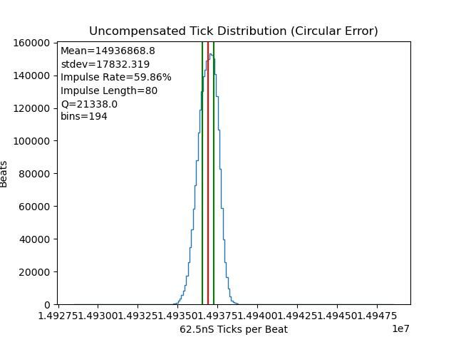

                Posted by S K on 09/08/2023 22:34:22:
                SOD, I know you believe you are measuring Q, and you are getting "numbers," but I don't believe you are actually measuring Q. The old "garbage in, garbage out" problem, to my eye. If your data was Gaussian and well behaved, and if the obtained value of Q was stable, maybe, but at this point none of that seems evident.
                Also, I am not sure you are using thousands of samples. Sure, you are collecting thousands, but per Q measurement you are throwing nearly all of them out after selecting only a few (I don't know the details, however, so I could be wrong on this point).
                In addition, you are subtracting two numbers that are very close together from each other, getting a very small number (i.e., 6 or so orders of magnitude smaller), and then dividing that very small number into a comparatively large one again, tempting the gods of mathematical fate. In this scenario, minute deviations can cause huge impacts on the end result, as it seems you are seeing.
                Try using the decay method to check. It can't be that hard, others have done it, and the decay method is much more intuitively related to the loss of energy per swing anyway. And also, the value of Q obtained this way should be quite stable from trial to trial (as I believe one would expect from a macroscopic pendulum of this sort).
                I plead not guilty to all charges!
                My data has a normal distribution, or at least close to it – admittedly there's a slight bias to the right:
                As the distribution is close to normal I am confident that the Q calculation is valid.
                I most certainly am using thousands of samples. The distribution above, was derived from the clock's log at 15:22 today when it contained 2,386,218 samples after a run of over 618 hours. Everey beat of the pendulum writes a record to the log. The Q varying by Hour graph slices the same data into hourly segments, each of which contains about 3,800 samples, from which Q in that hour is calculated. May I remind the jury that 3,800 samples is far more than the decay method collects: one of John Haine's posts mentions 30 samples, which is line with my experience.
                I don't believe the calculation is ill-formed, not when I have 64 bit floating point anyway. The method uses 3 percentiles taken from a large data set. Percentiles are related to averages – one of them is the mean. True Q tends to infinity as the distribution sharpens but my distribution isn't particularly sharp. Worth investigating further though, because I haven't checked how numpy's percentile function works – maybe it loses precision. I'm not seeing huge variatons – up to about 30%, usually much less,
                I have used the decay method in the past and it produces similar values. Decay method accuracy is limited by observational error and the small number of samples. As far as I know no-one has measured Q repeatedly and confirmed that Q doesn't vary over time. Although one might assume the Q of a macroscopic pendulum would remain stable, my data log suggest it doesn't. Given that temperature, pressure, humidity and other factors vary over time, I'm not surprised Q changes too.

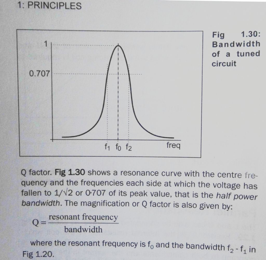

                                        Posted by John Haine on 11/08/2023 10:26:34:
                                        Posted by SillyOldDuffer on 08/08/2023 20:25:21:
                                        Bandwidth is calculated from the 29.3, 50,0 and 70.7 percentiles.
                                        Why do you choose those Dave? The bandwidth would normally be calculated from the "3dB down" points but it isn't obvious to me how "3dB down" = 0.7071 maps on to a percentile of a period distribution.
                                        All my clock books have disappeared! Luckily the gremlins forgot to hide my Radio library, and the same idea is in Dennison, Lorek (editors), 2005, Radio Communication Handbook 8th Edition, Radio Society of Great Britain
                                        Snip from page 1.16:
                                        And also discussed on this website.
                                        Might seem surprising that a pendulum and tuned circuits follow the same Physical Laws, but both involve oscillations.
                                        I have more background in communications than clocks, so tend to think of pendula as oscillators, emitting signals with a bandwidth, allowing me to use the maths and electronic techniques I'm familiar with to model them.

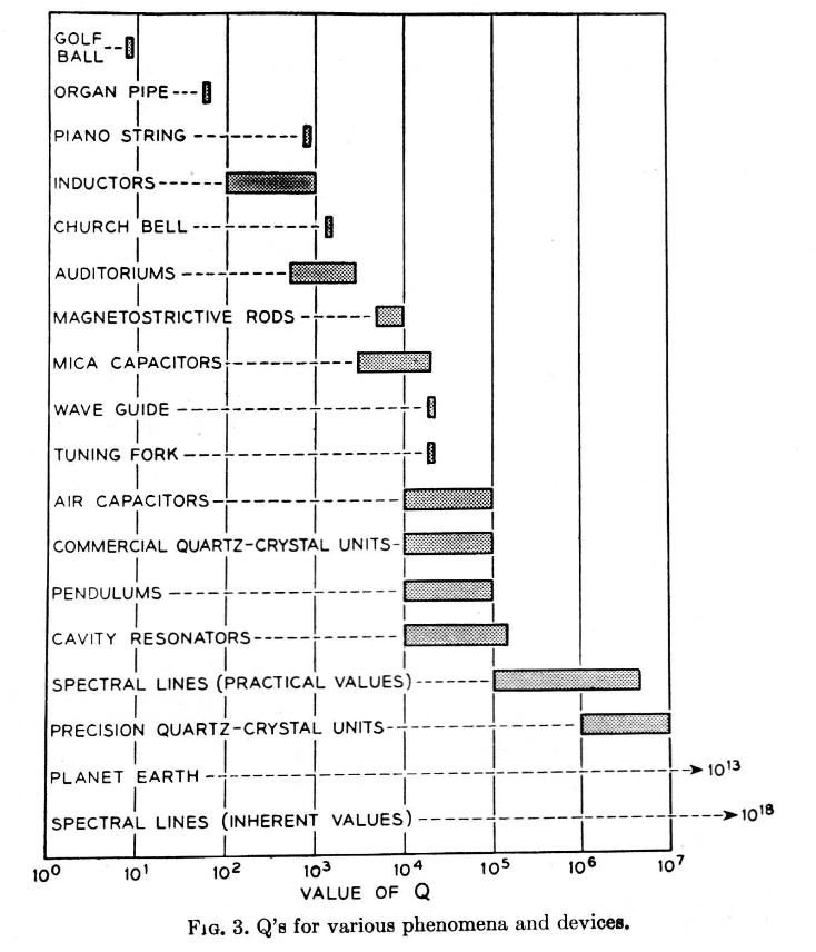

                                          I also came across Estill I Green, (1955) "The Story of Q", a not too mathematical history of Q and its wider adoption.
                                          This comparative table is useful:
                                          and it mentions the relationship between Q and Power Factor, which I hadn't twigged must exist.

                                                Something continues to bother me about your method and your obtained value of Q. I am not doubting the fundamentals of the method (much), but the numbers do not seem to make sense in relative terms.
                                                You appear to be getting about 1ms standard deviation in your period measurements, whereas in my last test I'm getting about 4us; a factor of 250 difference. Not all is equal, but assuming that the bandwidth is strongly tied to those numbers (i.e., 250 times lower S.D. means 250 times narrower bandwidth), then using your method I should get a Q that is very approximately 250 times yours. That would not remotely make sense.
                                                What am I getting wrong or not seeing?

                                                  Well, I used Dave's method on my pendulum data, as far as I understand it (and I may not), and got a "Q" of 190,000. That's not possible.
