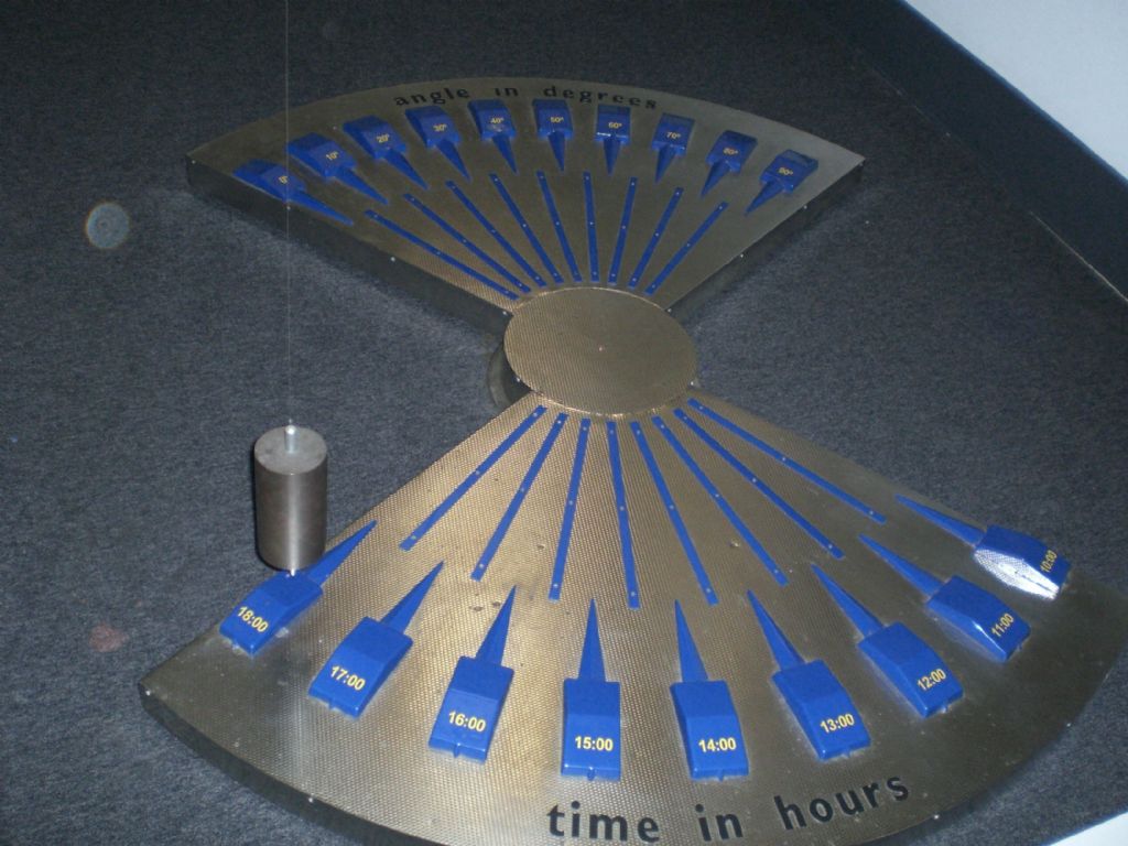

                                              Hi as MichaelG has mentioned, Foucault, I took this photo below of the one that was in the Science Museum in London ten years ago.
                                              I was hoping to see a really large one back in 2013 in Paris, which I think was in a cathedral, but it had been taken out due to renovations that were going to take three years, and I haven't been to Paris since then.
                                              Regards Nick.
                                              Edited By Nicholas Farr on 20/11/2022 16:11:52

                                                I don't know if it's the same one Nick, but there is a very impressive one in the Musee des Arts et Metiers which I visited 3 years ago. The Paris equivalent of the Science Museum, and very much worth a visit. Allow an afternoon at least.
                                                #621955
