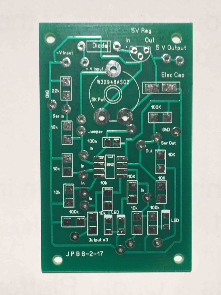

                          #285172
                          Peter Bell
                            @peterbell11509
                            Thanks for the lead. Designed a PCB for an 8M2 Picaxe project, sent it off 2 weeks ago and received today first class job and £17.50 delivered for 10.
                            Sorry for the shaky pic, board size is 55 x 33mm
                            Peter
