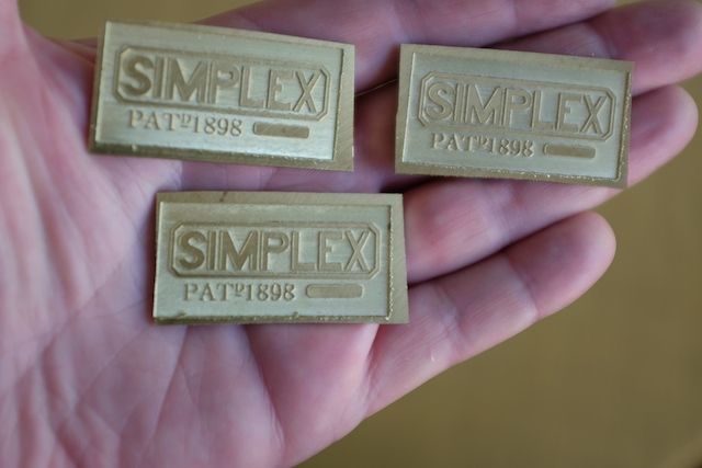

      Also, if you use LinuxCNC, (and probably PathPilot) it can directly read an image file (jpg is what I use) and it will allow you to engrave from that.
      I did write an article a while ago, (which is sitting in our worthy Editor's future-list – or did it get printed?? can't remember) for making some name plates from a wonky photograph – first part was straightening the photo, then sharpening the letters, the second part was the engraving part.
      It was done for a friend who is making a Canadian 0-6-0 switcher, and the tender truck bolsters had the maker's name on the ends in raised letters. He's very happy with the results, and the cost was only in the materials and engraving cutters.
      We'll see if the article makes it to print, or if it is too detailed/specific for Model Engineer.
      The resulting blanks (requiring fettling and trimming by my friend once attached to the bolsters) should be shown below.
      Fun Stuff!
      JohnS.
      simplex truck parts
