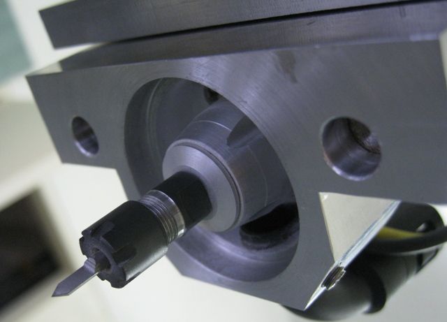

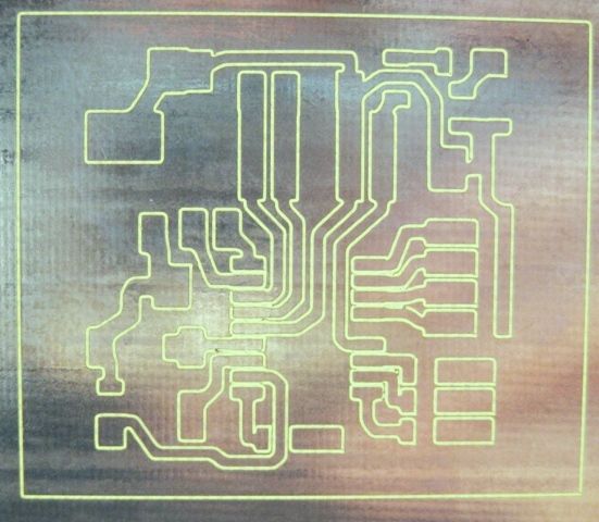

            I built my own 'mini-router' specifically for isolation engraving of PCB's. The kind of PCB's you want to do will determine the characteristics of the machine.
            For very fine tracks ( I do down to 0.4mm tracks with 0.4mm spacing between tracks..):
            The machine should be as rigid as possible with 'no' backlash in the leadscrews.
            The spindle should be as high speed as possible ( 20000RPM is good, 30000RPM is great), The cuuter tip is very fine – maybe around 0.15 to 0.2mm at the cutting edge, and speed is needed.
            The cutter geometry is critical – D-type engraving tips made from fine-grain carbide are needed, esp if working with FR4 – a fiber-glass PCB substrate. Cutter penetration is a scant 20um to 35um, so only the very tips does the work, and if that tip grind , relief, etc, is incorrect, all you get are ragged burrs and poor engraving!

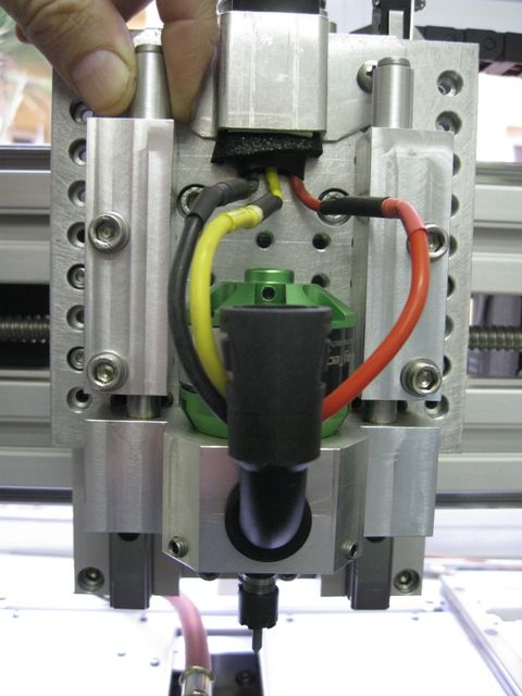

            And last, but very necessary, a floating spindle makes for a good engraving! Since the engraving tip is conical, the deeper you go, the wider the groove, and the more you cut away of the copper track sides. So maintaining depth is critical. Trying to get the router table perfectly flat is not easy – the frame of the router is flexible enough that if the machine is on a table top, just the flex in the table top makes for many 10's of um twist in the router table, which mucks with your depth. And then the PCB material is not perfectly uniform in thickness either, and it is almost impossible to keep the PCB flat on the router table either – some folk superglue it down, etc, but flat is never is. So, use a floating spindle , running on a teflon foot on the pcb, and depth is fully controlled.
            If you get a handle on these elements, then the process works, is totally repeatable, and makes great PCB's – I have made hundreds this way!

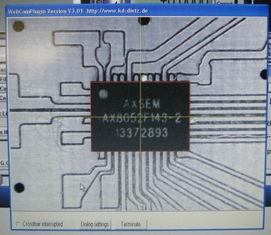

            I use the same engraver to pick and place the IC on the engraved PCB using a vacuum plunger..
            The tracks and pads on this IC are 0.5mm apart..
            Small IC placed on engraved PCB

                            Hi Joe, could you give some more details of your floating spindle design? I have a Chinese CNC which is sort of OK for pcbs but this looks like it would be a good retrofit
                            Cheers
                            Brian

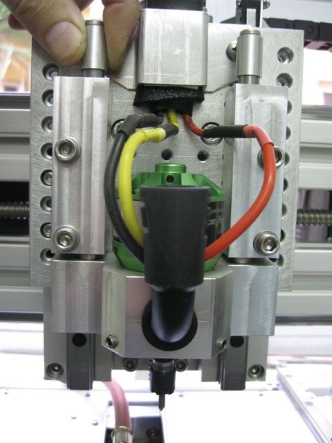

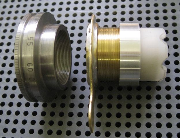

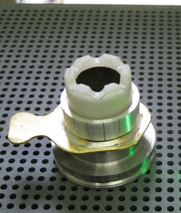

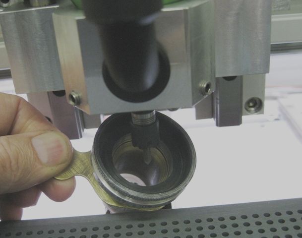

                              Hi Brian,

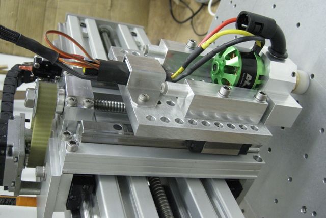

                              The floating spindle is fairly simple – the spindle ( itself just an RC brushless motor the main shaft of which removed and fitted with an 8mm long body ER8 collet chuck) – sits on the horizontal cross member in the photo below. That member has two 10mm vertical shafts that slide in the two aluminium blocks ( left and right) which are fixed to the Z axis. The nose of the spindle has a fine thread screw-in cone, fitted with a PTFE 'shoe' that rides on the PCB, with the engraving tool set to protrude below the shoe by the depth of the copper on the PCB – about 40um or so.
                              Some pics that may assist:
                              Spindle bussines end-
                              The floating 'foot'
                              The 'grooves' in the PTFE foot are so air can be sucked in via the vacuum attachment – see later pic down the line.
                              Floating Head in down position
                              And here in 'raised, position – as it would be when the foot touches the pcb and lifts the head.
                              The black elbow pipe in the pic above is a Vacuum attachment point – sucks up the debris through the nose cone and foot, keeping the PCB clean and clear of shavings – else the foot rides high and the engraving tip does not penetrate properly.
                              These tracks have a 0.12mm isolation cut ( the light shining through the groove) and the pads in the center for the IC are 0.5mm wide.
                              Hope that helps – ask if your want more detail. Important that the slide that the spindle rides up and down on on the Z axis ( not the z Driven axis..) is a close fit – no slop, since this will translate to poor track definition and resolution.
                              regards
                              Joe

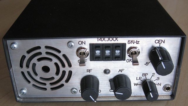

                                  But that is not the point. The router, if built decently and sturdily, is not just a PCB engraver. It does a sterling job of front panels for projects – easily do the lettering and control definition, route out the holes to fit controls, etc. And then route the enclosure panels out – I use single sided FR4, 1.6mm PCB, and then simply solder up the enclosure by solder tacking all inner corners lightly.

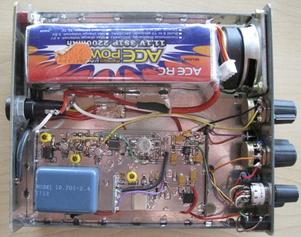

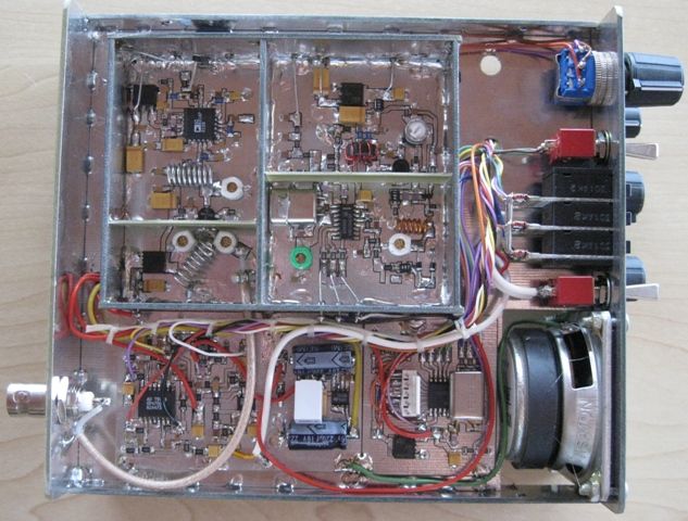

                                  Colin mentioned the intent being as a tool to supplement his Radio Ham hobby – As a fellow Ham, I use this tool almost daily. I do a circuit design and PCB layout after Dinner, Engrave the PCB the next morning in a half hour – assembled by lunch, discover the major snafu before dinner, and do a new layout after dinner. By the next afternoon the board is assembled and tested and I start the enclosure and front panel layout. The next day the enclosure is together and the project done and dusted…and it cost maybe $2 in PCB material…While you are still waiting for your boards to arrive, and to discover your Snafu…
                                  Here is a Wildlife Collar Tracking Receiver I made – enclosure all PCB, front Panel routed and engraved likewise.
                                  And here are the 'modular' PCB's for the various electronic gubbins that make the receiver.
                                  Try making commercial boards for that, and carrying the cost of repeats while you experiment..

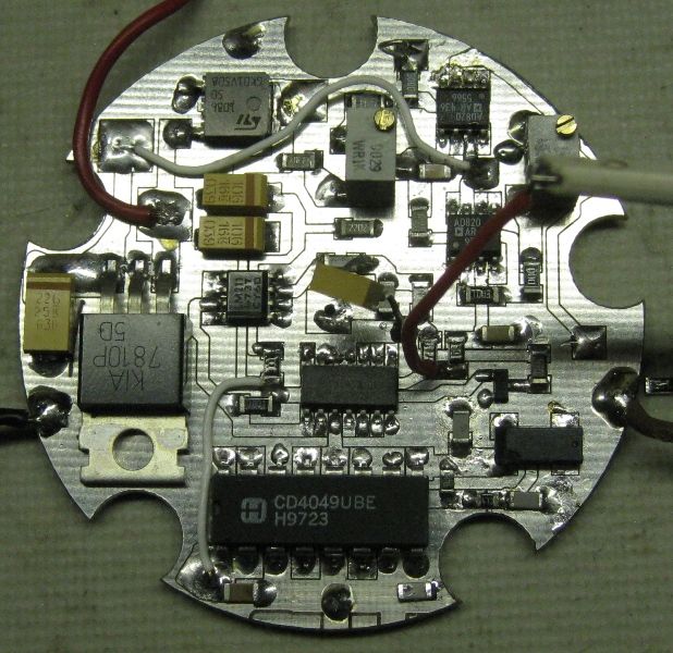

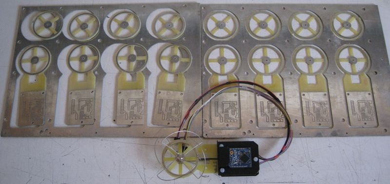

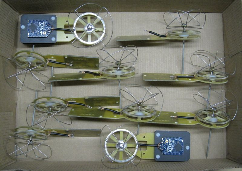

                                  Here are some neat Antenna I make for our UAV's – all PCB material, and routed on the engraver.

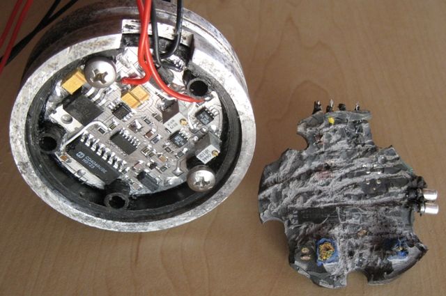

                                  And a Fuel level sensor I made for my Off-Roader – A BIG DIESEL!!!! Long Live DIESEL!!
                                  The old, failed, encapsulated sensor shown bottom right…
                                  So, Don't knock it till you have tried it – I would not trade it for ANY PCB service!

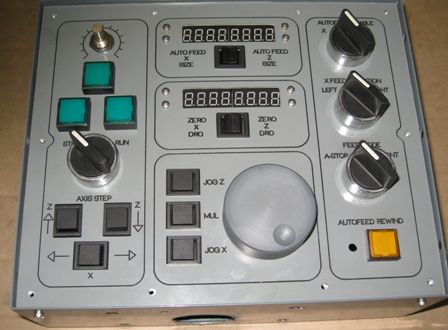

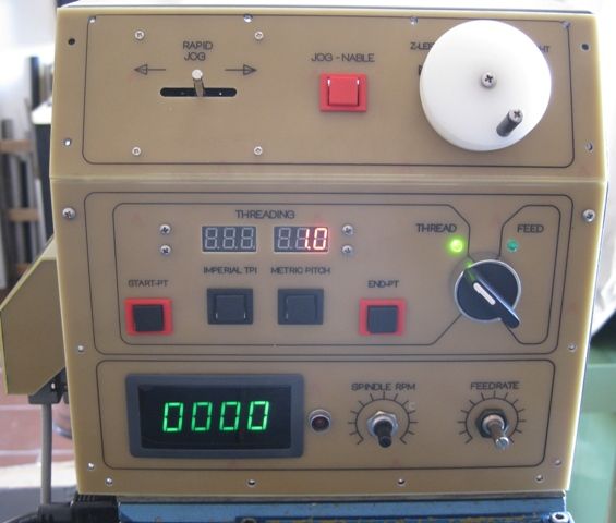

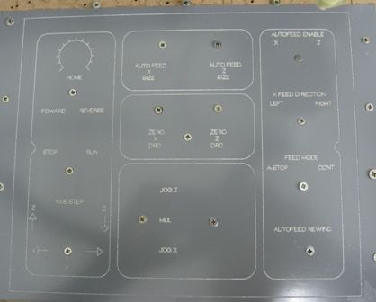

                                    Another 1 or 2 front panels made in the same way –
                                    This the control panel for my NC Shaper:
                                    And the completed panel:
                                    The Control panel for my Maximat V10P ELS system – all in FR4 PCB.
                                    …….Joe

                                              Bravo Joe – great kit and well explained. Can I just ask – do you ever do double-sided boards on this engraver, and if so, how do you register them and what registration accuracy do you get?
                                              #331399
                                              John Haine
                                                @johnhaine32865
                                                If I may chip in, having started to make PCBs on my Novamill recently…
                                                • As Joe says, bed flatness or some way for the cutter to adjust itself is important. For me the best approach is to skim a spoil-board flat before mounting the PCB on it, as I don't have enough space to fit a floating tool holder. I found that I had to re-cut my first board with a deeper cut as one corner wan't quite level.
                                                • TC engraving cutters are available quite cheaply on eBay such as here at about a fiver for 10. Also drills.
                                                • Though I would like to have a higher speed spindle I find these cut OK at ~5000 rpm.
                                                • For software, I use DesignSpark PCB to do the schematic capture/layout and LineGrinder (LG) to generate the g-code. Some features of the latter don't work so well and I've had to find work-arounds, but it's free! If anyone is interested I could refresh my memory (I need to do another board soon anyway) and put details up here.
                                                • LG provides for double-sided registration. It can flip the layout for the bottom copper and add registration pins. These are typically 1/8" diameter ground steel (or broken cutter shanks!), you drill holes through the PCB and into the spoil board at the same setting using the same size slot drill – I find that the resulting hole is pretty tight fitting on the pin and I would think the registration is as good as you can get with the basic machine.

                                                    Yes, I have done a few double sided boards, but tis rare that I need such – I use a lot of surface mount components, esp for the IC's, basic caps and resistors, etc. The leaded devices tend to be few in my layouts – deliberately so, and for the few that I do need to use I just bend the leads so that they can be 'surface mounted'. Works a treat. I then leave the copper plane on the underside as a ground plane/shield, and drill a half dozen holes through the top ground plane and join the bottom and top ground planes with a piece of the cut off leaded components leads…
                                                    My PCB CAD package is almost as old as me – Seetrax Ranger, but the OLD version from about 20 years ago – works fine for me! It can do multiplayer and so handles doubled sided fine – just flip the bottom when making the Gerber files, and place registration holes on all layers. I then drill ( in the engraver) the registration holes in the blank PCB's, and mating holes in the engraver sacrificial top, fit pins, place the blank PCB over and engrave away. Flip the PCB to do the other side.
                                                    John;
                                                    I have tried linegrinder – not to happy with it…I use another old package, called DeskPCB, by IMService – not sure if they exist anymore, but the tool is great and I have no issues. I also tried PhlatCam – others are very happy with it – freeware/open-source, but is does not work with the Gerbers my PCB package generates.
                                                    My spindle, as mentioned, is an RC brushless motor, cost about US$10, and the ER8 collet chuck that I replaced the motor shaft with cost US$7.00 from banggood…and it runs true as a whistle with a 3mm 10deg engraving bit.
                                                    Motor runs close to 34,000 RPM these days..Bearings are plain deep groove 8mm ID and have done around 420hours so far – no degradation that I can make out…
