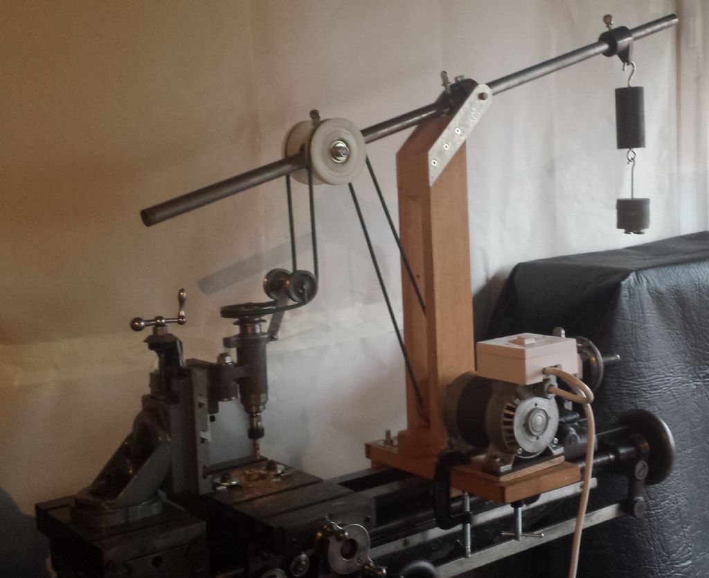

      I have an independent overhead drive which I use occasionally to power my potts spindle
      It takes a short while to set up on the lathe bed but is usually worth the trouble if I have a lot to do.
      Despite it's somewhat cumbersome look it does function well.
      The 1/4 hp parvalux provides ample power for end mills up to about 1/4" but is under powered on start up. I have to tug down on the belt to get the spindle running.
      Is it feasible to wire in a capacitor to provide a "kick start" and overcome the initial frictional resistance.

          Geoff, a Parvalux would normally have a run capacitor anyway, does yours not? The one I have on my Quorn came with it. Without a cap it will run but needs a kick to start it. How many wires go to the motor?
          To use a capacitor it needs an extra winding, whether cap start or start and run.

              I had a look at the link Michael, my motor is an sd38 and from the data sheet I can see that it already has capacitor start, which is what John indicated.
              It starts fine with no load, problem is the Potts plain bearings are "heavy" and the motor has not quite enough "umph" on start up, but is fine when it gets going.
              I may have a look at some sort of simple sliding clutch so I can introduce the power gradually.

                Please forgive my confusion:
                In your opening post you mention 1/4 hp
                … but the highest power that Parvalux skows for the Single Phase SD38 appears to be 60 watts, at 2800 rpm
                … which is only about 0.08 hp

                  Can you just ease the belt tension on starting, let it slip for a second or two. Crude but might work

                    The puzzling thing is that there is no sign of a capacitor in the pictures! According to that data sheet one of the options for this style of motor is shaded pole, and I wonder if this is such a motor. How may leads are there Geoff? If there are only 2 (plus earth) then it's probably shaded pole which would explain the low starting torque. The size of the motor relative to the pattress box is consistent with it being an SD38, but as Michael says this type is much lower than 1/4 hp (especially if shaded pole).

                      Yes Michael you are right the hp is much less than I thought. I bought it off ebay and it was listed by the seller as 1/4 hp I assumed that was correct, clearly it was not.
                      That was what attracted me to buying as it was compact and at 1/4 hp would probably have had ample power on start up.
                      I'm going to try it with a long bungee instead of the weights, as Duncan suggests lifting the arm and further tensioning the bungee will relieve the tension on the drive belt and give me a slow gradual start up, we'll see?

                              I believe what you have is a 3 lead induction motor, 2 white and 1 black leads from the motor. Although I can't see the type of switches you have I guess 1 is for on/ff and the other to reverse.
                              The 2 white leads are connected to L1 and L2 of the 2 way switch, the 2 leads from the capacitor are also connected to L1 and L2 (either way round ).
                              The live supply from the on/ff switch is connected to the 2 way switch common terminal.
                              The neutral supply from the DP on/off (switched fuse spur fused at 5A) has the black neutral connected in it.
                              The switch shown does not have any fuse so the plugtop needs to be fused down to 5A.
                              The size of the capacitor would be somewhere between 5 and 10 uf 400v working, if yours has a 5 fitted you may get better starting if you increase to 10uf 400v for 230v working.
