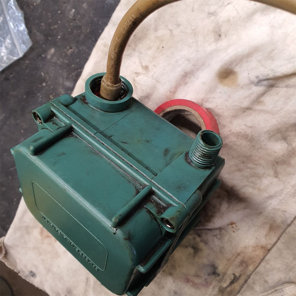

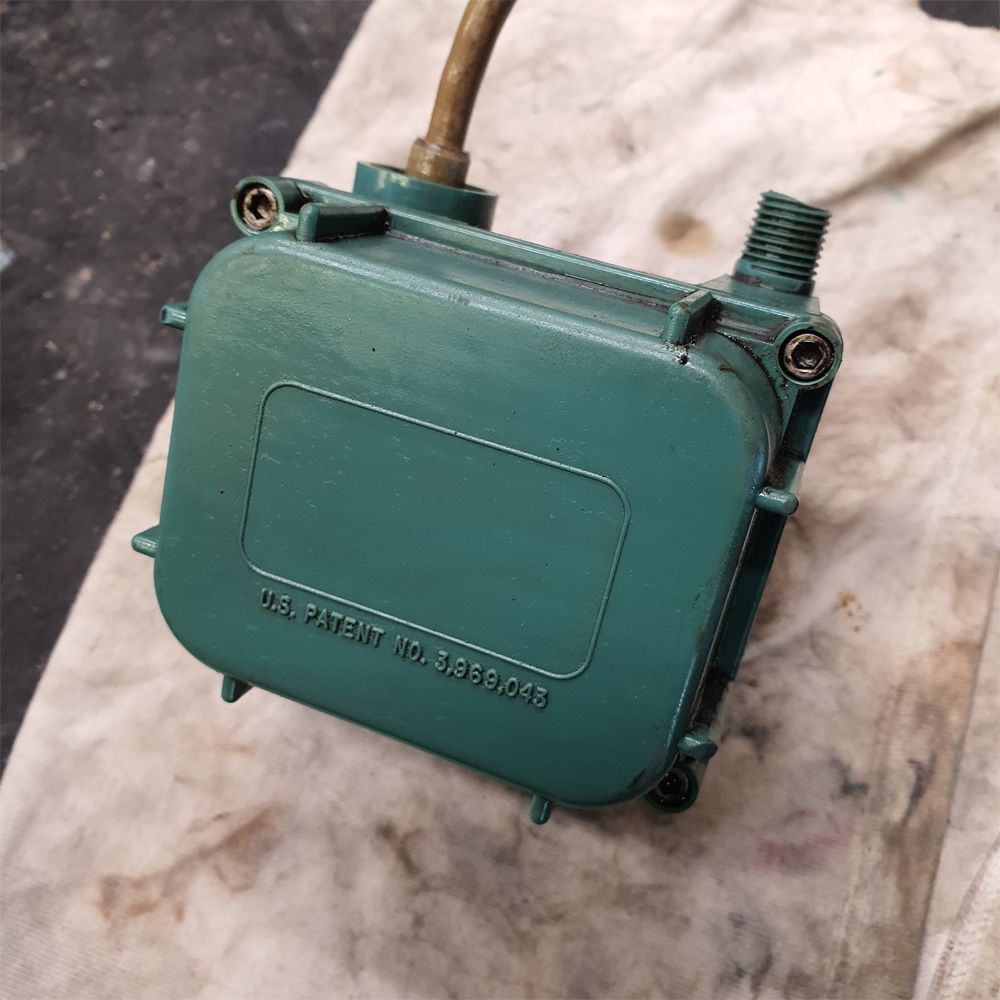

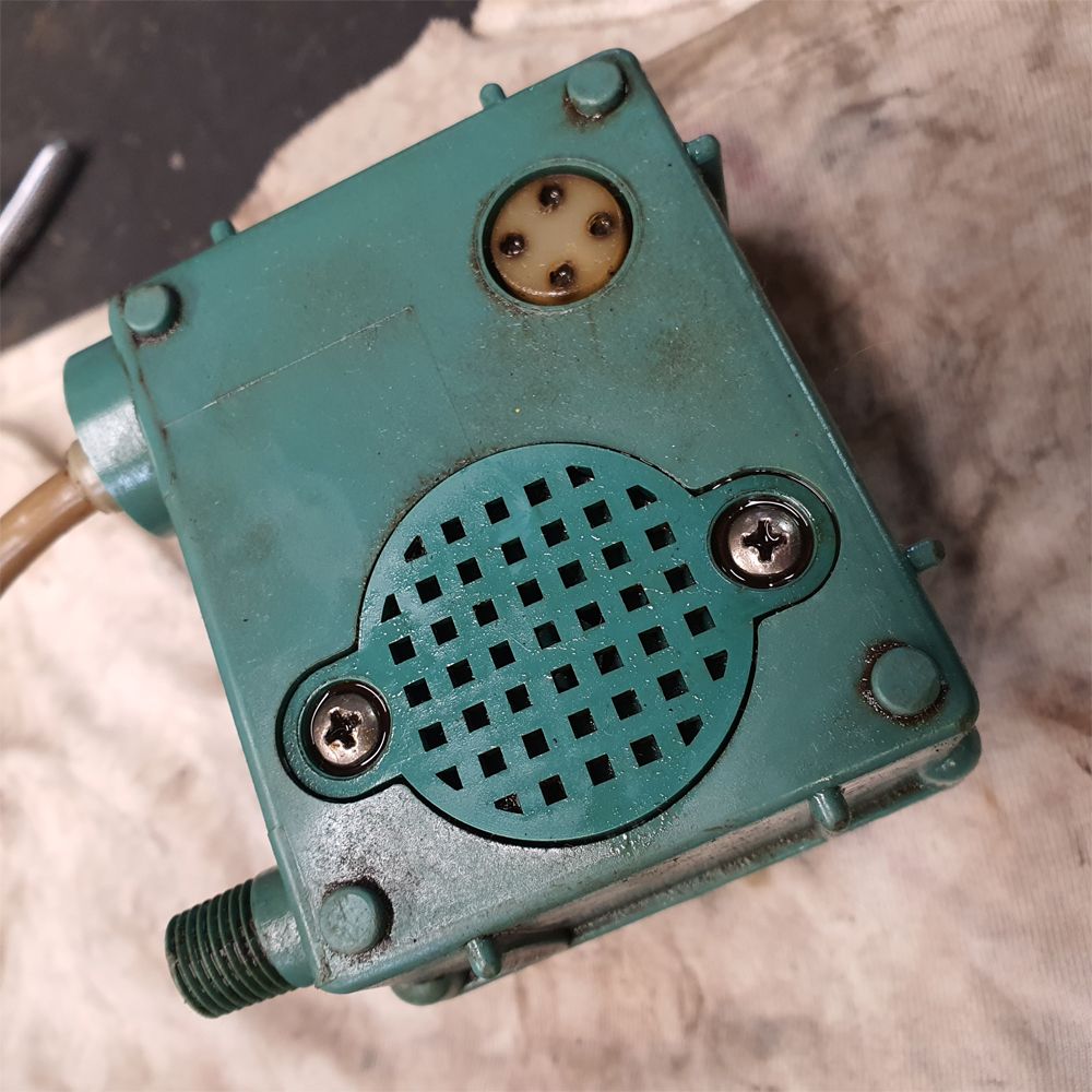

                                The company we got a replacement pump from is Safetykleen. I'm afraid I could not obtain a part no. just yet.
                                Incidentally the internal seals had gone on ours and there was fluid in and around all the electric parts, still working in that condition. Could have been interesting.
