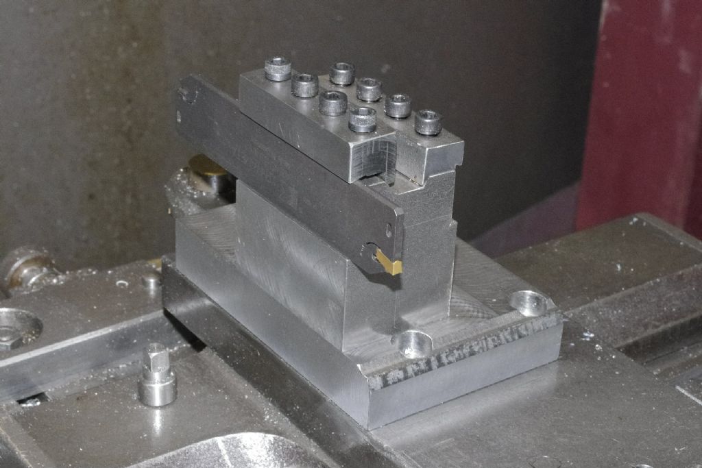

      I'm looking for a good parting tool, preferably with a HSS blade. Something like this:
      It should cut to a depth of at least 10mm. My tool post can hold tools up to 23mm tall. So I would avoid those 10mm tools that seems to be so common.
      Anybody tried this kind of parting tools? I don't see how that insert can stay there …

          the insert stays put because its in a taper and the forces acting on it push it further into that taper. the holder and the inserts also have matching V gloves top and bottom giving sideways integrity.

                          Success with parting off came when I purchased one like your first pic and mounted it on a rear tool post never looked back since to the point Ive got the insert type but never use it

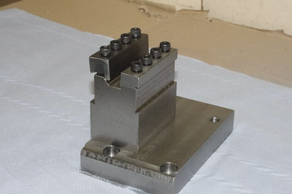

                              _igp2502.jpgAs Harry Wilkes mentiond, a rear toolpost mounted directly to the cross slide has great advantages. They are much stiffer and the swarf removal is helped by gravity. The top half to the one I made on a mill can be turned round for the 26 and 32mm blades which we use in 1.6, 2 and 3mm tips. Being able to lock the saddle front and rear also helps._igp2494.jpg

                                                On my lathe I can't use a rear tool post. But I can reverse the motor direction. So if I mount the tool upside down it should be the same thing.
                                                I remembered that I have this tool (20x20mm). Does it worth the effort to try to make a parting tool from it? This would mean to decrease the width of the top part to 2-3mm. A lot of grinding.

                                                  Running in reverse is completely safe if you do not have a screw on spindle. You do need to still get the inverted tool tip on the centre line and if the saddle can be locked it will be a bonus in stiffness. That tool you illustrated would be much too much bother to get thinned down to a usable 3mm or less width for parting. If you can use a blade for carbide inserts or a tapered section HSS tool in a holder it would be better. I would recommend getting 2 or 3mm wide tooling for most sizes of lathes for best results.
                                                  That tool could be used for grooving or be made into a general turning tool. Possibly right and left handed at the same time provided you could get it shimmed to centre line both ways round.

                                                      I find blades in a rear-tool post work best for me, but it's not really the cutter that makes the difference. Which tool is the wrong question, should be 'What's the best way to part-off?'
                                                      First secret is rigidity. Parting-off applies more force to the cutter, job, and lathe than most operations. They are all likely to bend, causing chatter and dig-ins. When a dig-in occurs, the forces involved make it likely be violent.
                                                      Second is the need for a steady feed at the right rate. Steady is vital, and most humans are wobbly. The tool has to cut continuously, not too deep or too shallow.
                                                      Third is making sure the cutter is aligned correctly, going straight in, not applying side-pressure because it's at a slight angle.
                                                      Fourth is making sure swarf doesn't collect in the slot and jamb the cutter. Cutting fluid in applied in quantity helps.
