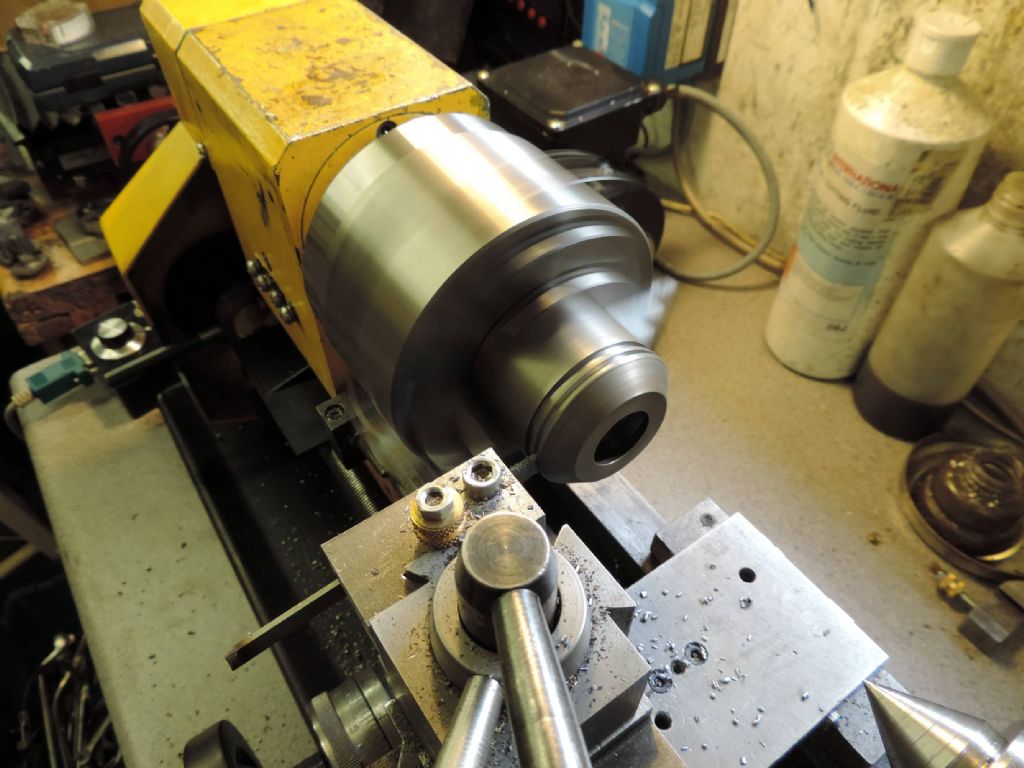

                          Sub Mandrel
                            @submandrel
                            Mini lathe in action, ten minutes ago.
                            Parting 1
                            Parting 2
                            2" diameter EN1A.
                            Home made front QCTP toolpost and toolholder using rectangular section 1/16" parting blade (Arc Euro)
                            Mini lathe modified with roller bearings, and now 3-phase VFD. (the groove to the left of this cut was made using a wider tool and the original DC drive)
                            No coolant, not even a smear of cutting fluid.
                            Some noise, but just change teh cutting spead until comfortable.
