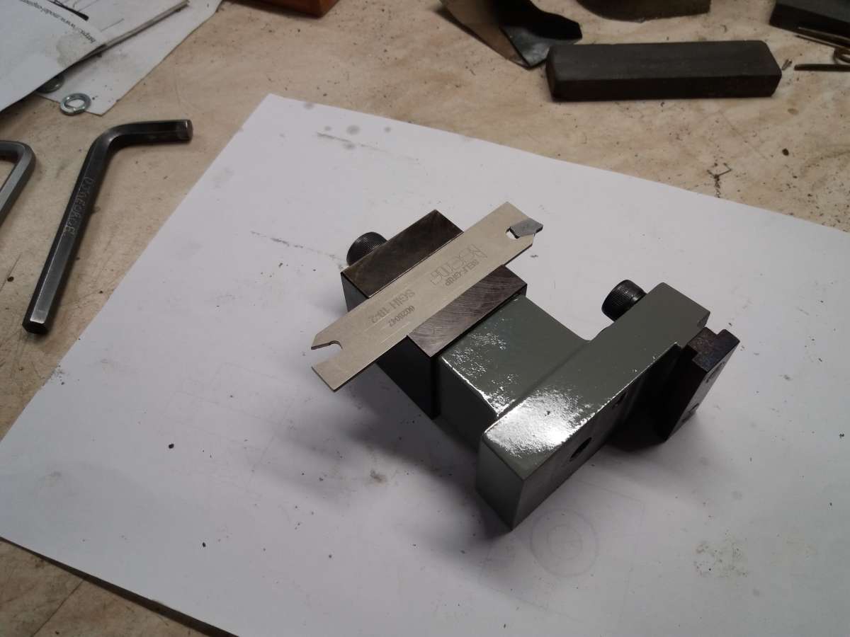

      Hi, I am very much a newbie, but am fortunate enough to have a Warco WM180 lathe and a WM18 milling machine.
      One problem I have is that when I tighten the blade in my QC tool holder using the rear Allen key, the blade always slightly rotates away from vertical. Am I doing something wrong? It doesn’t seem right, and makes parting off harder than I reckon it ought to be.
      TIA
      IMG_0125IMG_0126

        I had the same problem when I started.  I had bought the wrong type of blade for that holder.
        I eventually bought a parting tool that uses inserts, and clamps into the standard QCTP holder.  It works very well for me.

            Check you have the blade the right way round as many of them have slightly angled top and bottom edges so that they “dovetail” into the holders.
            Was the notch already ground into the top?

              The angle ground into the top will tend to make it dig in, especially in conjunction with the built-in angle of the toolholder. The slightly smaller “000” series equivalent has the blade level, and it works fine with no top grind.

                  I’m with JasonB. Not certain, but it seems from the lower picture that that might well be the problem. I’m assuming here that the top-rake was ground in by the OP, thereby “handing” the blade incorrectly.

                    Is possible the wedge is the wrong way round?

                      Looking at the picture, the blade is definitely angled away from the body.
                      As suggested, check that the locking wedge is the correct way round. It should pull the blade towards the body, not away from it. It might even benefit from some filing so that it does pull the blade against the holder body.
                      With the blade off vertical, jamming is likely, and parting can make enough problems, without using the wrong set up
                      Having a large top rake, on a blade that is already set at a rake angle, by the holder, will also cause problems with dig ins.

                          The cross section of a parting blade should be a parallelogram. Sitting on its bottom edge it should lean to the right, so lean into the toolholder and the top edge will then be lower on the left than the right so the clamp also pushes it into the holder body.
                          The front cutting edge should be a little off-square seen from above so that the right hand corner is ahead of the left hand corner so at the end of the cut the part falls off leaving a small pip on the main stock but ideally nothing protruding on the part.

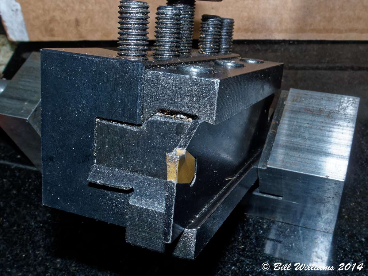

                            I have 250-207 holders, so the same design, but a size larger.
                            The locking wedge only fits one way, as the threaded hole is offset.
                            Also, its not designed to draw the side of the blade against the body, as the underneath of the wedge is flat.
                            Similarly, the vertical face of the tool slot is just that, vertical, so not designed for a tapered blade.
                            Mine came with a slab of flat HSS, to form a wide grooving tool.
                            The HSS Parting blade I use has a cross section more like a T shape, with a wider flat top, a flat bottom and parallel, but relieved sides as the upright part of the T.
                            It would take a smallish shallow insert blade tool OK, though the cross section of the blade would be a bit thin to be stable; it would also have to be one with flat top and bottom.
                            I do have other parting blades and holders for the Myford, which have the conventional tapered relieved sides, and sloping top and bottom, such that the angled nut pulls the blade against a slightly angled/off-vertical face of the holder.

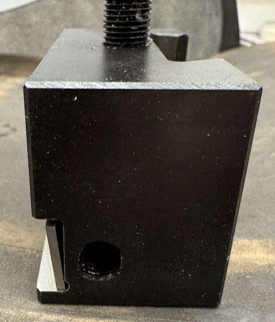

                              The blade holder from ArcEuro linked to in the second reply is a bit too versatile for its own good!
                              Its hard to tell from the website pictures but both the upper (the clamping wedge) and lower surfaces appear to have no ‘dovetail’ effect but look to be parallel to the toolholder base. It looks like the OPs blade is ground at the wrong end so the and the wedge clamp has pushed the (nominally, parallelogram shaped) blade downwards so the the blades lower edge is sitting flat against the lower seat.
                              I’m not sure how one parting tool holder can satisfactorily hold a range of blade widths and heights.
                              My experience with various single size blade holders is that even from new with the correct blade, the side clearance angles are not equal. I corrected an Eclipse holder by re-machining the holder underside at a very slight angle so that the blade stood exactly vertical giving equal side clearances. A Dickson holder also held the blade wrongly (no clearance on the the chuck facing surface of the blade) but as the whole block is hardened I resorted to gluing a 2mm wide strip of shim near the top of the blade recess (to cock the blade to the left slightly).
                              Blades used in the Dickson are not a parallelogram section, more accurately they should be described as a trapezoid.
                              I quite like the clamping wedge idea of the Arc offering but not keen on the rake being built in. I prefer to be able to extend/retract the blade to suit work diameter without having to change the cutter tip height.

                                  This is a close up of the rear of the ARC holder (snipped from the OP’s picture).
                                  It looks like the top and bottom faces of the blade are parallel to each other, and the clamping force has rotated the blade so that blade bottom edge is aligned with the lower tool recess face. Turning the blade end for end will ‘sort of’ rectify the problem, but the blade will then only have line contact support as it appears the blade recess is parallel to the base of the holder
                                  Clip 2
                                  With a recess able to take 5mm wide blades, gripping a 1.5mm blade looks like a trial and error process.

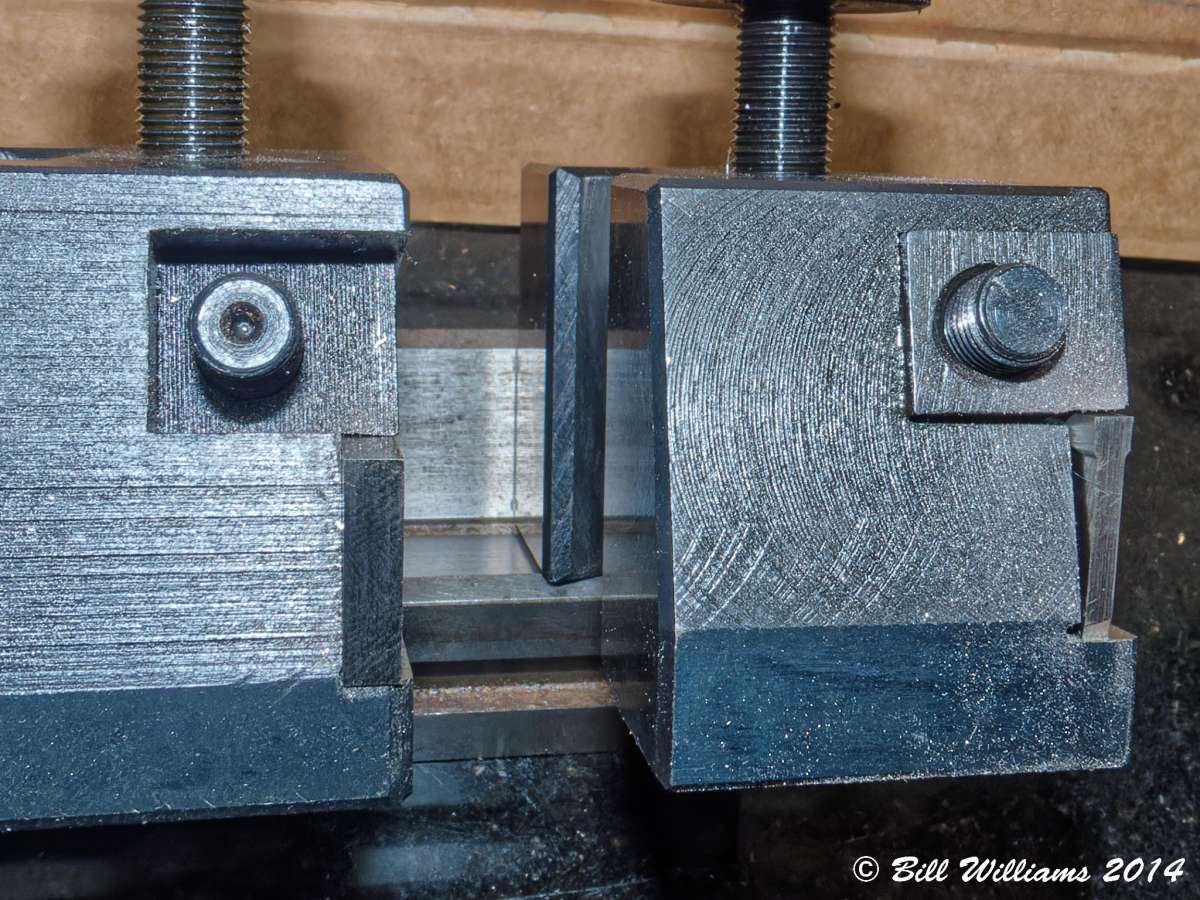

                                              As I mentioned earlier, the 207 version of these holders have top and bottom of the tool holding recess parallel,  and at right angles to the vertical face. I’m writing vertical for ease, as that face is also parallel with the toolpost itself.
                                              The wedges are flat bottomed, and not reversible, so designed for holding rectangular blades.
                                              They slots are not tall enough to hold carbide insert parting blades.
                                              2024-02-06 17.26.36_DxO-Facebook-s
                                              Sorry if the photos are a bit dark, but you should be able to see that the front view of the left hand holder houses a lump of HSS bar 0.161″ thick, with sides parallel to about half a tenth. It’s 0.634″ tall with top and bottom square to the sides. This one does appear to have a slight angle to the base of the wedge, but it’s just damage to the front edge.
                                              The right hand one holds a blade of T cross section, rather than trapezoidal, where the parallel relief on the upright part is about 0.040″ narrower than the cross bar of the T.
                                              I just nip up the wedge, whilst temporarily inserting a 20 thou wire feeler gauge into the gap twixt blade and holder to keep everything vertical/parallel.
                                              Bill

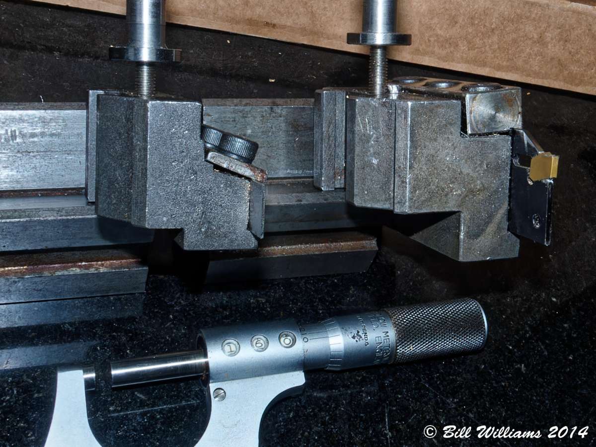

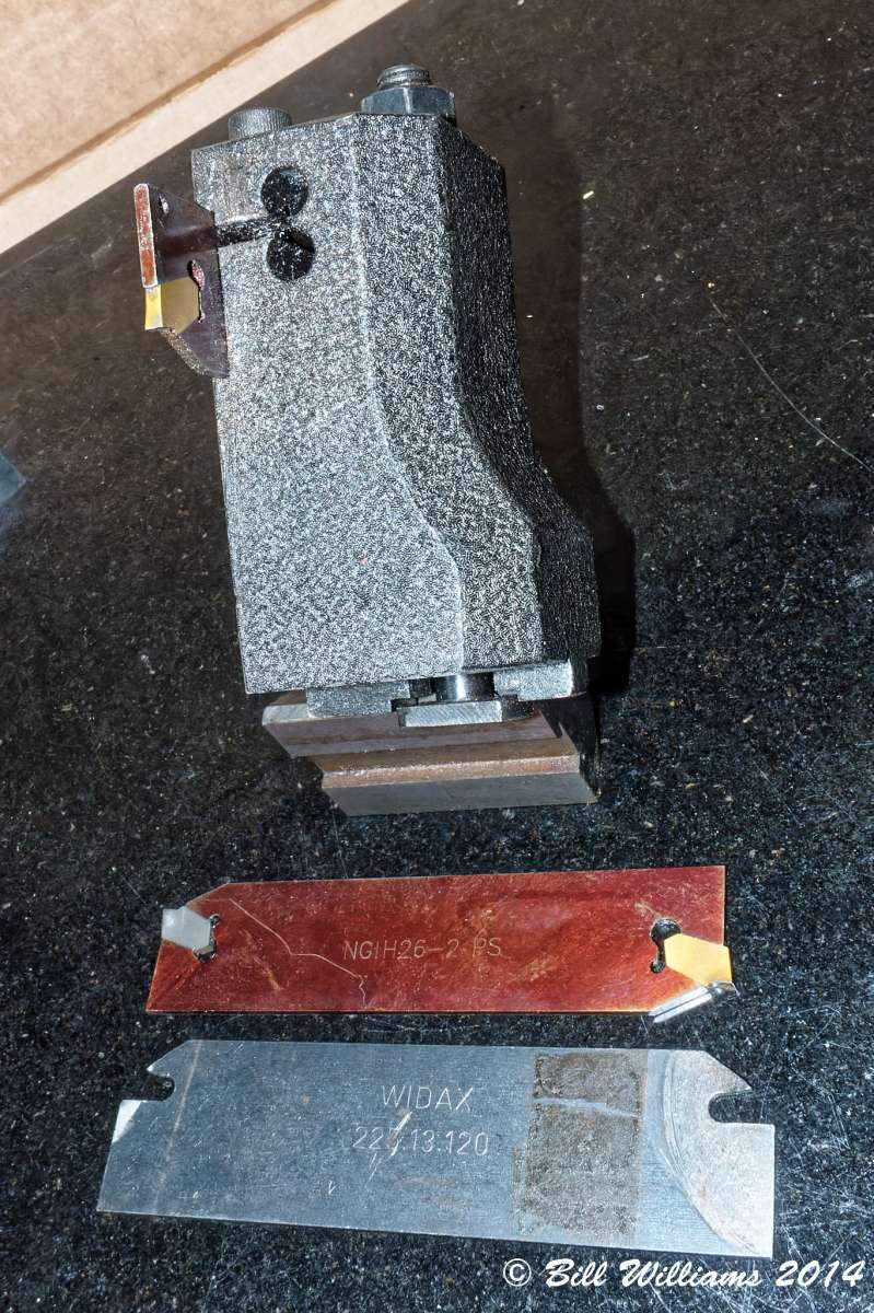

                                                Next one, also designed for this size of tooplost, is the insert blade holder; If the idea of holding trapezoidal parting blade with the centre line vertical  as opposed to just the right hand edge, it might not be ideal; I just don’t have one tall enough to experiment. In that case, as far as I can see, relief would only be provided on one side.
                                                As you can see, it comes as a separate unit, which mounts into a conventional 202/201 holder, which works well enough, though at the expense of a greater overhang.
                                                2024-02-06 17.26.02_DxO-Facebook-s
                                                Top and bottom of the recess is clearly angled to lock a thin blade against the vertical side.
                                                The insert blades I own,  have rounded, rather than single angles at top and bottom
                                                Bill

                                                  Now for the Dickson style.
                                                  The left hand one seems designed for ½” parting blades, though here I have an all hard hacksaw blade fitted to thinner parting/grooving.
                                                  The right hand one is obviously holding an insert tool blade, and works well.
                                                  2024-02-06 17.28.16_DxO-Facebook-s
                                                  Using my best tenths DTI, the vertical face, does appear vertical, and not half the included angle of a trapezoidal blade.

                                                    Here we now have my Myford rear mounting toolpost, specifically designed with a dovetail to hold inverted insert style blades against a vertical face.
                                                    You still run the lathe forwards of course, but the load on the cross slide is different, allowing for a much safer cut with less chance of a dig-in.
                                                    2024-02-06 17.31.00_DxO-Facebook-s
                                                    There’s a couple of spare blades below, one showing a coated + uncoated tip; the other, for which I don’t have inserts, presents the tip with a different top rake.
                                                    Part numbers clearly visible, some blades will hold both 2 & 3mm wide inserts.
                                                    I normally only use the thinner ones on the Myford/Warco 720.
                                                    Bill

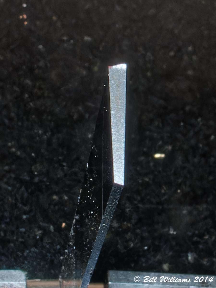

                                                      Finally, this shows the shape of a trapezoidal HSS blade.
                                                      I’ve deliberately taken the photo from a slight angle to change the perspective a bit; the top and bottom angles are a bit shallower in real life viewed end on.
                                                      2024-02-06 17.33.50_DxO-Facebook-s
                                                      This would be the view from the rear of course; the sharp end is away from you out of view.
