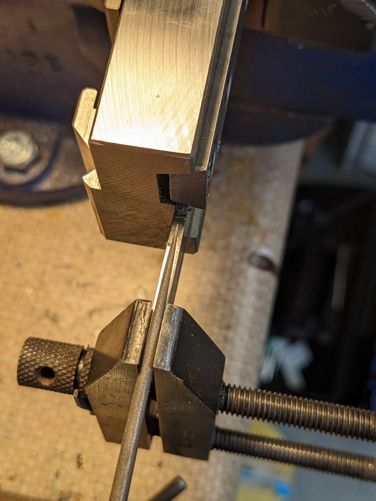

                                                    Well the answer is obviously some do, some don't. Personally I'm in the do category, partly because I don't have a cross-feed handwheel any more but mainly because it works so much better (for me anyway).
                                                    If you are using HSS parting blades (front or rear TP), you can make a dish in the "top" surface using a round diamond rat-tail file in a few minutes. You can hold the blade in a vice or toolmakers clamp so the faces of the jaws will stop the file sliding off the surface, but once you've made a shallow depression in the right place it's self guiding. I'll try to get a photo of mine.
                                                    #639063
                                                    John Haine
                                                      @johnhaine32865
                                                      Like this.
