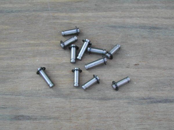

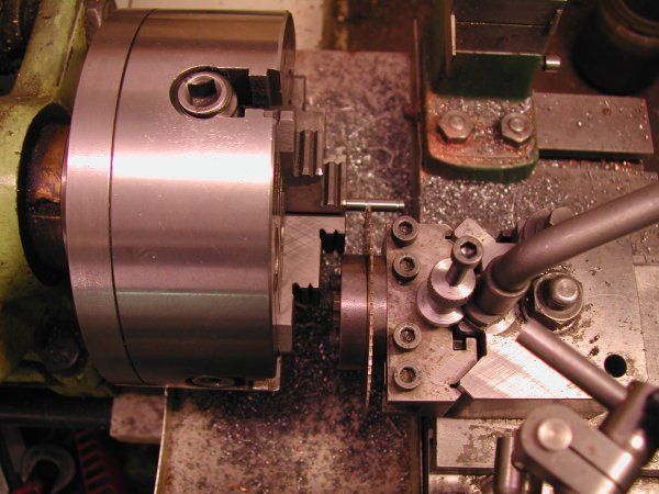

      I made this when I run into a problem parting off some small diameter washers my normal 1/16 parting tool was too wide it just bent the bar. It's not my original idea I saw it some ware can't remember ware.
      It easy to make and when one tooth gets blunts you just index round to the next.
      Stew

          Stew… That's very ingenious! I'll be making one of these soon. I like the fact that you don't waste as much material than you use. What's the diameter of the slitting saw that you use?

              Hi John
              It's diameter is 1 3/4"
              Thanks for your interest
              Stew

                How surprising. I made exactly the same type of tool, but for cutting 1/32" slots in 3/16" silver steel for 'E' clips for the valve gear of my PANSY.
