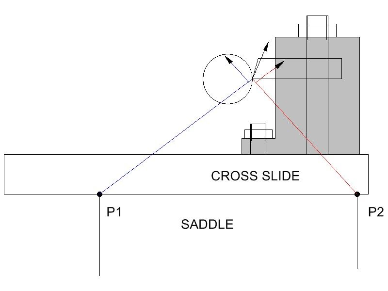

                I've never see a toolpost pivot on a cross-slide. That's about the most rigid joint in the whole setup, and the toolpost and cross-slide must act as a single body. far more flex in the tool, and more potential for movement at the cross-slide dovetails and saddle to lathe bed, which by definition have some play as they move.
                So, where does that put the pivots?

                  In all the places you mention, Neil
                  So; a system of interconnected levers; and probably, subtly different every time they act.
                  No wonder people get differing results.

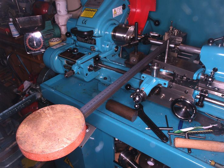

                      Part the Second, and another sketch:
                      Although the above sketch is not to scale, the relative positions of the cross slide, rear tool post and rear saddle edge are about right when parting with a rear tool post. With a solidly bolted tool post, the post itself isn’t going to pivot about anywhere, the cutting force at the tip must lift the entire tool post and cross slide assembly as one unit. Either lift it vertically, or pivot it about some point… but where?
                      I suggest that the tool tip can only be pivoted about either P2 or P1. It wouldn’t be too difficult to calculate this to determine which one it was in reality, once the weights of the rear tool post, cross slide, top slide and tool post were known, together with the cutting force applied at the tool tip. As far as the cutting force is concerned:

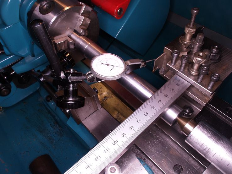

                      About 70 lbs for a 2mm parting blade with an infeed of 0.04mm (0.002” approx) per revolution when parting mild steel.
                      Knowing the sort of loads we’re talking about, it’s not too difficult to apply a load and determine how the tip moves. I first did this many winters ago on the S7, and have now repeated it on the Connoisseur, ostensibly for the purpose of taking a photograph of the set up, but really because I couldn’t find my results from years ago and had to re-run the tests. The good news is that they confirmed what I’d found previously. Here’s the set-up:
                      Something of a jury rig, admittedly, but nevertheless it works well enough for present purposes. Re. the indicator – it’s a Verdict, markings at 0.0005”, which means that tenths can be detected &estimated, but I would not claim to be able to actually measure tenths accurately with it! The results are interesting, units for the deflection readings are 0.0001”.

                      Saddle lift – zero, I couldn’t detect any lift at all, so that disposes of the ‘saddle lift’ theory as to why/how a back tool post works well. At least on my lathe, dunno about yours!
                      Vertical lift – the figures are relative to the bed. The vertical lift has two components, i.e. for the 72/92/164lbs. loads total lift was 8/16/23 tenths, of which the cross slide contributed 5/7/16 tenths, the remaining 3/9/7 tenths coming from the Dickson tool block atop the tool post itself, presumably because of loading on the single central hold down bolt.
                      The lateral figures were INWARDS towards the work, not out and away from it. So the pivot point must be at P1, and the tool movement is definitely ‘up & IN’, as per the blue lines on the sketch above, not ‘up & OUT’ (red lines).
                      The results are, of course, for static loading of the tool post. I’ve done some dynamic tests as well, the vertical results were in reasonable agreement with the above, the lateral results showed no movement one way or the other, but I’ll discuss those further when we’ve looked at the front tool post.

                        Good work Cabeng. It's refreshing to see some good investigative work rather than the constant repetition of opinion we've seen.
                        Now, if that's repeated on the front toolpost I wonder what we'll see.

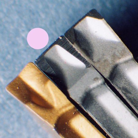

                            The inserts designed by the likes of Sandvik & Iscar etc show what's necessary to part off successfully from the front toolpost.

                                Cabeng – good to see some actual measurements, although I've yet to see a parting tool that parts off without requiring a fair amount of horizontal force pushing the tool into the work. Your setup simply produces a vertical reaction which is only one of the two main components.
                                If you are going to the bother of setting up and measuring, you might as well make it vaguely representative of the actual situation. Or do you now plan to repeat the test with horizontal-only forces applied?
                                Are you honestly claiming that your saddle doesn't move even 0.0001" vertically under load? Come on, this is now taking on quasi-religious levels of farce!

                                  As I said somewhere above, my Myford S7 can, using the Sandvik/Iscar style part from the front at my chosen speeds. If others cannot, then the setup they are using is faulty or else their machine is wanting in one or more respects.

                                                Hello Muzzer & Frank. Clarification…
                                                Muzzer: the results I've shown are for the loads that I applied as given in the table – I didn't detect any saddle lift at those loadings. It does lift if enough load is applied, e.g. by leaning on the lever, when it suddenly 'jumps' up by about 2 tenths. It's an example of one of the non-linearities to which you refered in an earlier posting.
                                                My heaviest chuck on the end of the lever (equivalent to about 240lbs on the toolpost, which is as far as I can go and still be able to determine the loading) doesn't move the saddle when applied as a STATIC load.
                                                240lbs. corresponds to the tip load when feeding a 2mm tool at 0.13mm (0.005&quot per rev.
                                                Shock loading causes the saddle to behave differently, it can be made to lift suddenly by 2 tenths at what I think are lower loadings on the toolpost, but I have no way or applying shock loading in a repeatable manner. Shock loading can however be important during parting, jamming of the chips and all that, I'll be discussing that later… but not in a 'calibrated' manner, I'm afraid.
                                                Re the direction of the applied force – you make a valid point . I know the general direction of the cutting force, but not the specific angle. So I decided to work with the vertical component only, as that was repeatable. Further tests with horizontal force only wouldn't be realistic, as that would merely end up causing lots of backward movement due to backlash in the feedscrew.
                                                Frank: nothing is pivoting on the saddle, the lever pivots on the bar between centres.
                                                I suppose I should have said something about the machine and parting tips – the lathe has been in service for about 3 years, and is in as-new condition. My S7 is 40 years old, but more about that later. The parting tips are Iscar GFN2/IC20, no other identification on the box re the specific form of the chip control features. It's the one with the dot against it:

                                                  It's worth having a look at the diagram on p46 of this catalogue extract.
                                                  As I said earlier; I think they have it sussed.
