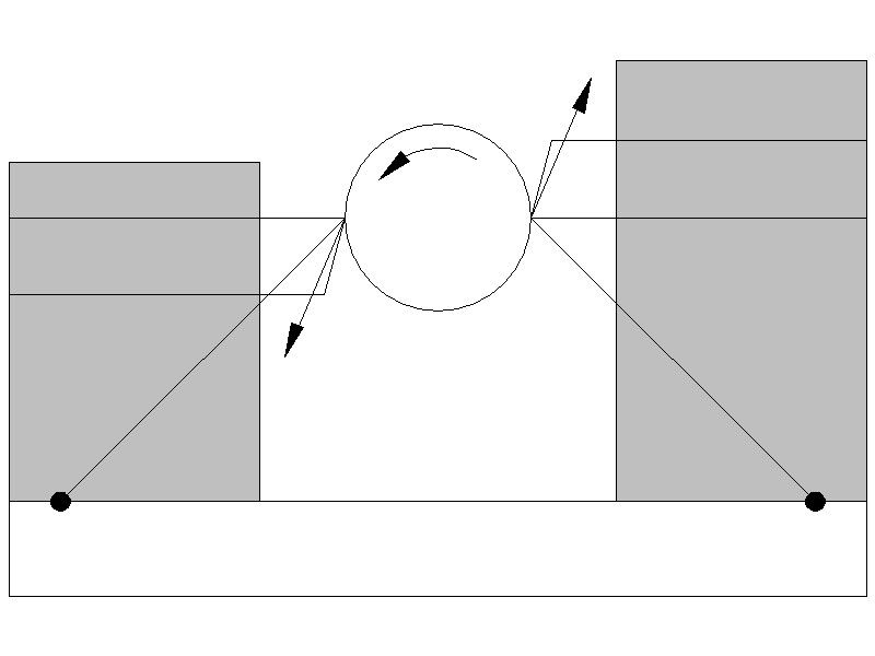

      Let us look at some numbers for the forces involved. I'll take my lathe as an example; it has a 3hp motor. That equates to 2238W available at the motor shaft. The lathe has a V-belt drive to the headstock, and then, I think, two sets of gears to the spindle. I am going to take the efficiency of the belt drive as 95% and that of each pair of gears as 98%. So at the spindle we get an available power of 2042W.
      Typically I would part off in 2" plus diameter low carbon steel at 370rpm; equating to 38.746 radians/second. We know that power is equal to torque times angular velocity. Re-arranging, we get a torque of 52.7Nm. Let us suppose we are parting a 50mm diameter bar, so the radius is 25mm, or 0.025m. This gives a force, at a 25mm radius, of 2108N. If we convert to kgF, we get a maximum of 215kgF acting on the tool. I must admit that seems quite high to me, but I cannot see the boo-boo in my arithmetic?
      Looked at another way, I use a 3mm (0.118" )  wide carbide insert and normally set a feed of 0.006" per rev. So at 370rpm, on the outside of a 2" bar that is a removal rate of 1.65 in³/min. A rough rule of thumb says that 1hp will remove 1 cubic inch of material per minute in low carbon steel. So we're looking at about 1.65hp, roughly half of what the lathe can provide. So in terms of power probably rather less onerous than normal roughing.
      If we believe these numbers I know which way I would prefer the forces to be acting, ie, down through the slides and saddle to the bed, rather than trying to lift everything off. crook
      I have always assumed that chatter is a result of an interaction between tool and work, and the cutting forces involved therein. I would not have thought that well adjusted headstock bearings would have much, if any, influence. My experience of chatter is it always occurs on light cuts, normally finishing ones. sad

                      If I assume a front mounted tool and start feeding the cross slide towards the lathe centreline, and then push on the cross slide it moves even closer to the centreline by the amount of play in the screw. So far so good. If I now assume a rear mounted tool and start moving the cross slide towards the lathe centreline (in the opposite direction to before) what happens when I pull on the cross slide, ie, in towards the work? On my lathe it moves closer to the lathe centreline by the amount of play in the screw. smile o
                      Surely the rotating work is always trying to drag the tool inwards towards the centreline, irrespective of where the tool is?
                      Andrew
                      Because as the load builds up on the front mounted blade tip, the blade/toolpost combination are flexed into the work suddenly increasing the load enormously to the point where the cut stops and the work rides up and over the tool (or if you prefer, the tool is dragged under). Any slop in the feedscrew can only allow this inward grab to increase unless your gib strips are so tight, the friction overcomes the force. With a rear mounted upside down tool being pulled into the work, the more force you apply, the more the tool wants to flex away from the workpiece. If it's easier, imagine you have a small tree with a single branch sticking out at ninety degrees (the equivalent of our front mounted tool). If you pull down on the branch, the whole tree tends to flex towards you. If you lift the branch (rear mounted tool), the tree tends to flex away from you. Ypu have to assume that there is a tiny component of flex in the toolpost, the way in which it bolts to the cross slide and the cross slide itself. It may not be much but not much makes a difference when parting off which is already a heavy cut. And yes, technically, rear mounted tools of all sorts would work better if you can anchor the cross slide sufficiently to the bed. The whole system would in effect be the same as a swan neck tool.

                                          Can I offer a somewhat different view of the parting off situation, arrived at after many years of expensive research – a.k.a. playing about and writing off parting tool tips? But first, some caveats:
                                          1) I haven’t read the MEW article (I don’t buy the comics)
                                          2) the following comments are based on the S7 & Connoisseur lathes, which I've used for umpty-one years, you'll have to make up your own minds re their applicability to your machine, if different.
                                          3) This will take some time and space, I can't upload it as a single posting, and chopping it up, adding diagrams, etc. is a pain in the parting tool with this system.
                                          4) I fully accept that I risk being accused of heresy by disciples of GHT, and hence being condemned to eternal damnation – after being burnt at the stake, of course!
                                          But first, a response to Blowlamp's last posting – compliance isn't the solution, it's the problem! Think about a beefy CNC machine chewing metal off at high rates, parting like a knife going through butter – works perfectly, but it's very rigid, no compliance.
                                          Kiwi Bloke1 wrote:
                                          “The late, lamented George Thomas wrote pretty much all anyone could ever need to know about parting off (and many other topics) in his many comprehensive Model Engineer articles and his books.”
                                          He did indeed write a lot of good stuff, but I certainly wouldn’t extend that accolade to his analysis of the front versus back tool post argument! As far as I know, he never actually claimed that his explanation was rock solid, e.g. in Model Engineer’s Workshop, p61 he writes:
                                          “…I imagine (my underlining) that the main reason is that a tool subjected to a downward pressure tends to lean forwards and so dig in whereas upward pressure will cause the tool to move back and out of cut.”
                                          So he’s not all that sure about it, then. Also on p61 is his sketch (Fig. 5.1) in support of the explanation:ght.jpg
                                          He does say that the diagram is an over-simplification… well, dunno about that, I’d say it’s plain wrong! Firstly the directions of the forces on the tool tip are wrong, they should look like this:ghtmod.jpg
                                          That on its own is sufficient to get rid of the 'down & in' versus 'up and out' argument, but additionally GHT's choice of pivot points for the tool posts is entirely arbitrary, and bears no relation to reality! Unfortunately, if one starts from an incorrect assumption, one ends up with at worst an incorrect answer, and at best a misunderstanding of the problem – so given the above errors in the ‘explanation’ it is indeed unfortunate that GHT’s efforts have resulted in the imprinting of the ‘down and in’ versus ‘up and out’ argument into the genetic code of countless model engineers.
                                          Muzzer wrote:
                                          “We love taking simplistic views of problems. When we talk about the tool "springing", we are actually referring to the movement of the point of the tool relative to the point on the work piece where it acts. In between them is a whole series of slides, screws, bodies, joints etc – as well as the workpiece itself. The whole system is a combination of linear (sprung) and non-linear (backlash etc) elements, often with quite different characteristics in different directions”.
                                          Absolutely right Muzzer, particularly the bit I’ve underlined, which hits the parting nail (and indeed any machining exercise on lathe or mill) smack on the head. What matters is the ability of the complete system to support the tool tip in a stable position relative to the workpiece, when the tip is subjected to the forces resulting from the metal cutting operation. So let’s look at that, having removed our GHT-coloured blinkers!
                                          But first, can we agree that the problem of parting off can be parted off into two problems (sorry about that!), viz. chatter, and jamming?
                                          Better stop there for this posting, or it's going to tell me it's too long!
