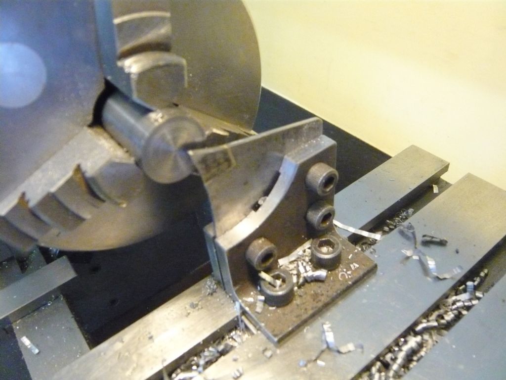

                                              Vertical Parting Tool
                                              A while ago I tried out a vertical parting tool it worked ok but I must admit I did not give it exhaustive testing to destruction etc.
                                              In order to clarify the operation of a vertical parting tool here is my rather primitive description of how I think it works.
                                              Imagine that you are the parting tool holder whereby your two hands are held straight out from you body. You hands are gripped together and your fists are the cutting edge. You have a friend who represents the metal being cut and he (If you are a front parting tool) pushes down on your hands while you do you best to resist him pushing down. You can see that he can quite easily push your arms down. If you want to now become a rear parting tool you can turn round 180 degrees and your friend would now push your hands upwards still he can easily overcome your resistance to him pushing up. So in order to stiffen you up, say you are frozen solid or have rigor mortise and are wearing a large pair of lead diving boots to anchor you down. When your friend (or should I now say de-parting undertaker) pushes down on you hands he will not be able to move your arms down because they are rigidly fixed to your body and he have to apply more force until you tip forward on you toes. Note that as you tip forward you rotate about your toes moving your cutting tool hands deeper into the metal being cut. If you are now rotated 180 degrees to become a rear parting tool your friend (some friend) now has to apply more upward force until you tip backwards on your heels. Also note that your cutting tool hands now move away from the metal being cut as you rotate backwards on your heels. Now you have to play the part of a vertical parting tool as I am proposing, so you now can be thawed out or de- rigor mortised. So lay flat on your back and push one arm vertically upwards and clench your fist to form the cutting tool. Your friend now has to apply considerably more force to overcome your vertical arm. Your arm will be in direct compression and until your elbow or wrist give way you will have much less a problem resisting his downward cutting force. It will also not matter if you are a front or rear vertical parting tool as long as the rotating force is pushing down on your hands. You can now get up and go back to your work or whatever you were doing. I apologise for being so flippant but I hope it does explain the reasoning.

                                                Muzzer
                                                  @muzzer
                                                  You want to be careful wrestling in the workshop near all those sharp things!
                                                  About the actual tool – looks like a carbide tip brazed onto a blade – is it? And I assume the machine turns in the "normal" direction? Looks as if it could cut either direction or be swapped around in the holder.

                                                    Alan Jackson
                                                      @alanjackson47790
                                                      Muzzer,
                                                      It is actually a HSS cutting bit brazed to a mild steel sheet. The machine is turning clockwise in this instance but I see no reason that it could be remounted for anti clockwise 'normal' rotation Here it is in action
