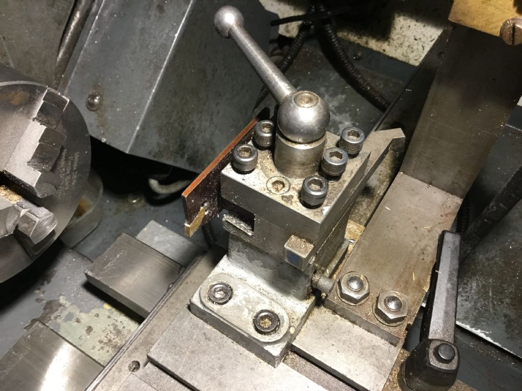

                  Mick Henshall
                    @mickhenshall99321
                    This is mine,uses 1/2"hss blade, inspired by Hopper. Mick 🇬🇧

                      #398507

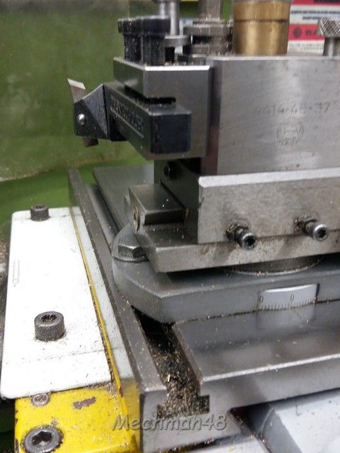

                              mechman48
                                @mechman48
                                I'm another user that likes the rear part off tool holder albeit only when I need to part off MS of a large diameter. I made up mine from a kit from Hemmingway's ( usual disclaimer ) & have successfully parted off 1-1/2" under power with neat cutting oil as a lubricant….
                                The original design mooted a slanted slot for the blade, which can be seen centre right of pic but found that there was too much flex & overhang so decided to make alternative use of the other side of the tool post design with alternative holder, works a treat. For the amount of small stuff I do it's not a problem to use the front mounted system & I can comfortably part off under power, brass, ( dry ) aluminium, at 400 – 500 rpm ( WD40 ) & dropping the rpm to approx 300 for MS., ( neat cutting oil ) with minimum feed rate. For extra rigidity I have the compound slide set back to provide more rigidity under the tool post, so far works fine for me.
                                Tool post set back…
                                George.

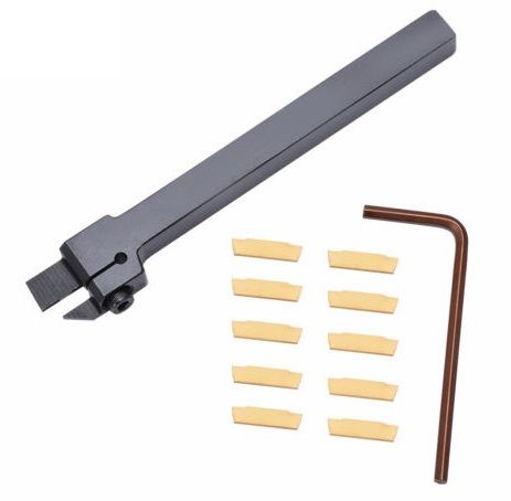

                                                  Massimo Dalmonte
                                                    @massimodalmonte45801
                                                    Good evening,
                                                    I bought a Myford leadscrew handwheel to mount it as an apron handwheel on my ML10, instead of the stock ball handle.
                                                    The leadscrew handwheel has an index ring cast on its periphery that I wanted to remove.
                                                    I took one of these:
                                                    the name is something like "MGEHR1010-2 Grooving Turning Tool Holder" (there are several sellers, I chose the cheapest one with 10 inserts, around 7 GBP including shipping costs):
                                                    I set the tool in the front toolpost right with a try square and proceeded in lowest backgear (48 rpm) as the cdiameter was 86mm: the operation completed perfectly, with the proverbial "sizzling bacon" sound, and in the end I could remove the cast iron ring.
                                                    Admittedly Myford cast iron seems a nice material to machine, but I never had the impression to reach the limits of safe operation and the 2mm insert finished in as good as new conditions, though, when the ring was almost severed, the cut was interrupted each time it met the spokes of the handwheel.
                                                    Cheers,
