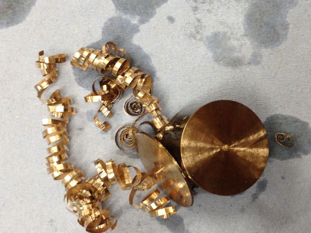

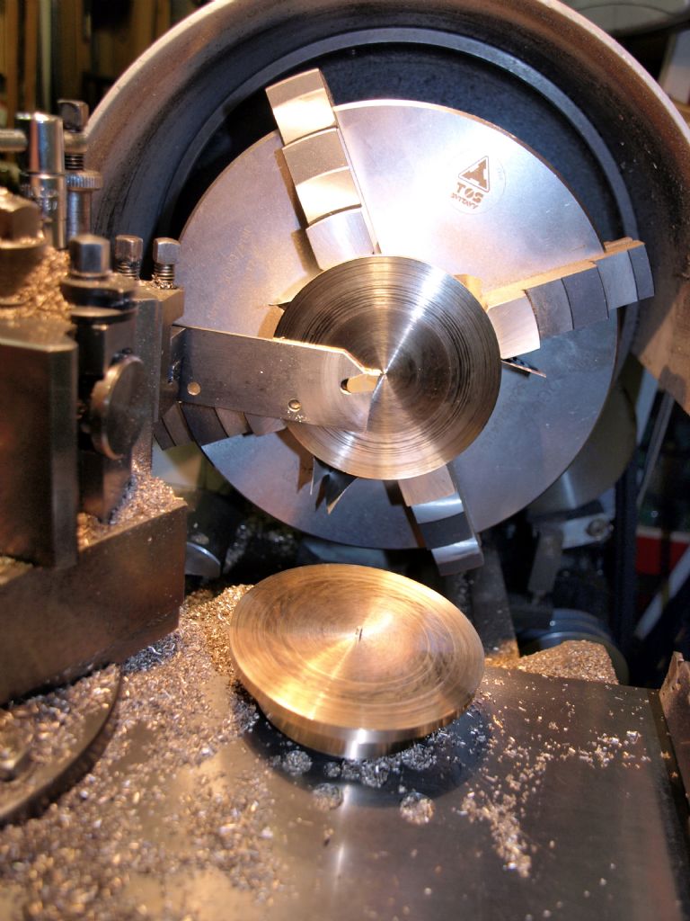

                                #525199
                                KWIL
                                  @kwil
                                  Bk 5 Dome Blank
                                  #525201
                                  KWIL
                                    @kwil
                                    Missed the text!! 3" dia PB tool overhang a bit long, Machine is M300
