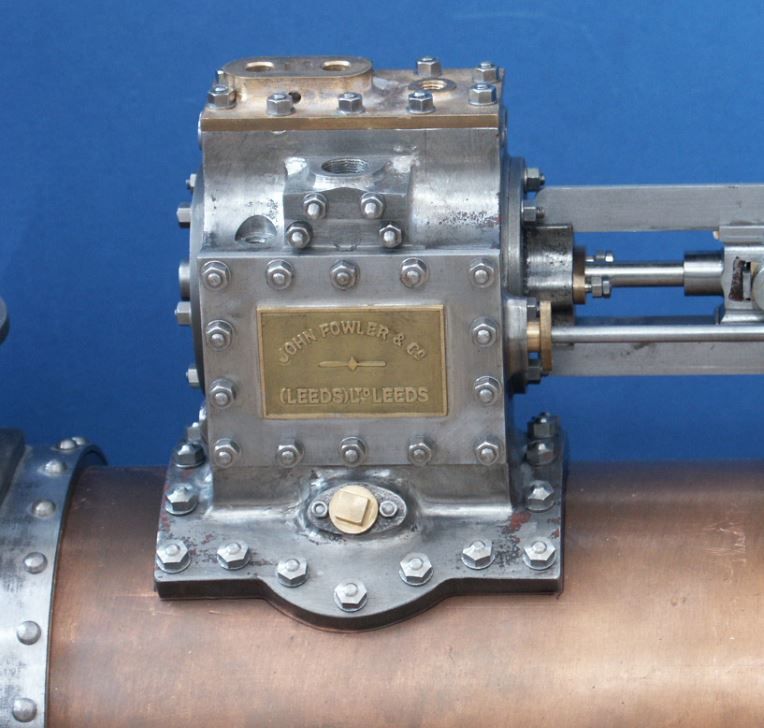

        Posted by JasonB on 07/02/2019 10:40:02:
        ……. use hex stock to make bolts but do them with a dome on the top of the head to look like a protruding stud.
        Wot, no two exposed threads of the stud for safety? For reference I will be using home made EN3B studs and EN1A nuts for holding the cylinder block on my traction engines; although they are larger scale and have steel boilers.
        Andrew
        #395136
          No need for a specific amount of thread showing when it's all solid metal. wink
          I think even the most avid rivit counter would have a job telling the one piece ones going into the boiler from the rest which are all nuts and studs especially under a coat of black paint.

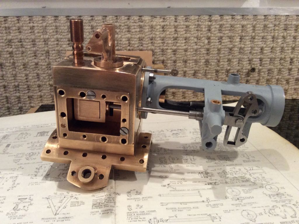

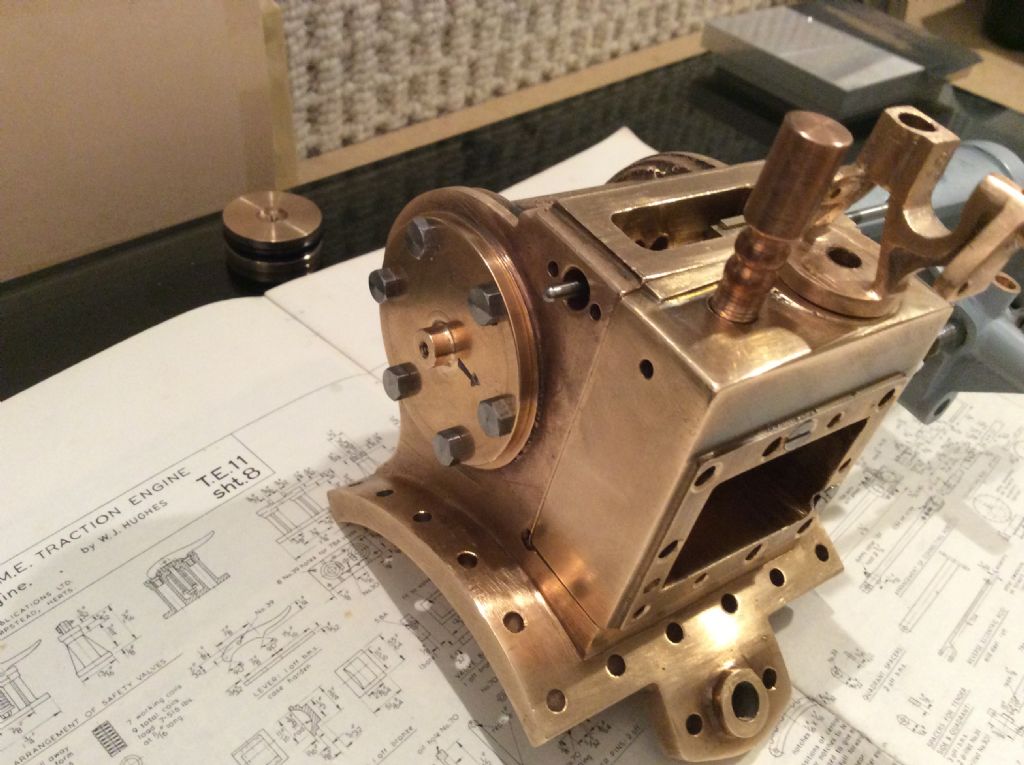

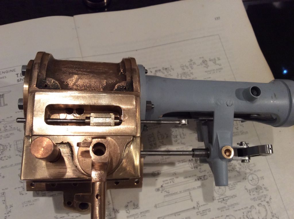

                                  abit more work on the cylinder done after receiving it back from Ken who very kindly did some tasks I just couldn’t do on my lathe.and I still have no milling machine.
                                  ive finished drilling and tapping the cylinder cover holes front and back, more fixing holes on valve chest cover and attempted first fit of slide valve.
                                  im pleased so far, let’s see if it all works in the end…

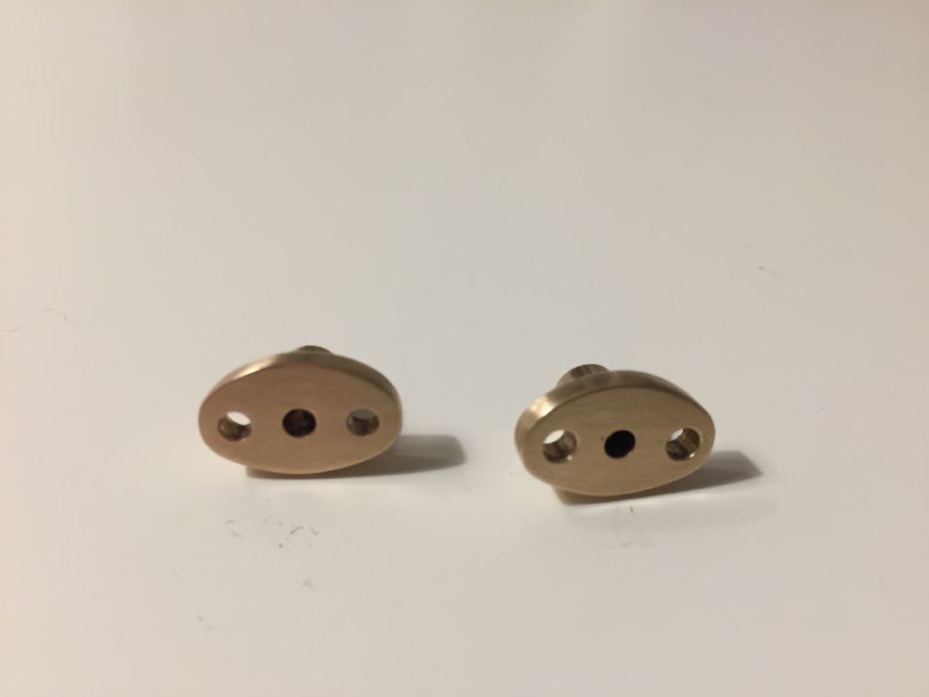

                                        Hi All
                                        I'm in need of a cheat, I'm making the steam glands this week.
                                        ive made the one for the piston but have the regulator and slide valve ones to make, I turned two yesterday and they were great until I tried to transfer the stud holes into them and I was misaligned.
                                        is there a easy way of transferring the stud position from the cylinder into the rear of the gland ready for drilling instead of trying to measure?
                                        I was thinking of maybe turning some studs with points and gently pressing the gland onto that this transferring a small dent as a marker.
                                        the glands wont go right up to the cylinder so I cant use ink etc.
                                        I just wondered if there was a really simple way that I'm missing.
                                        Many thanks,
                                        Del
                                        #400990
                                          Pointed studs will work, infact you can even buy them. When you turn the point also file a couple of flats either side so you have something to wind the stud out with.
                                          #400992
                                          derek blake
                                            @derekblake72550
                                            Thanks Jason, I think that’s the best bet.
                                            i will make some tonight, especially as they can be used again.
                                            Del

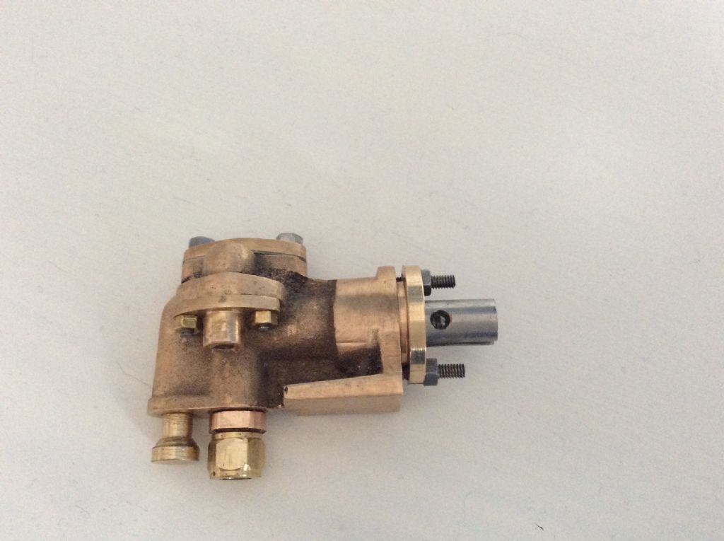

                                                    so I’ve been quite on here but not in my summerhouse, I will update pictures today.
                                                    boiler still being worked on so in the mean time I’ve worked on the water pump which works.
                                                    gear guards, cylinder, and some other small tasks.
                                                    i have one question please, I’ve brought some graphite’s yarn for the glands on the cylinder. How do you fit this stuff, do you wrap around the rod and push gland in or do you stuff pieces in around rod and tighten gland down?
                                                    i have a O ring arrangement on main piston so this advice is for the regulator and slide valve rod.
