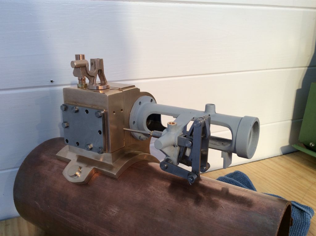

                      #394361
                      derek blake
                        @derekblake72550
                        Couldn’t resist seeing how it may all look, just stuck trunk guide on with some double sided tape, fingers crossed everything will line up.

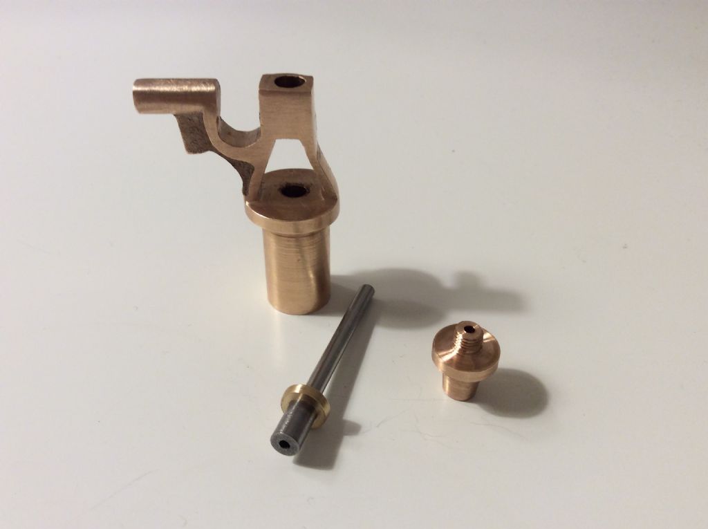

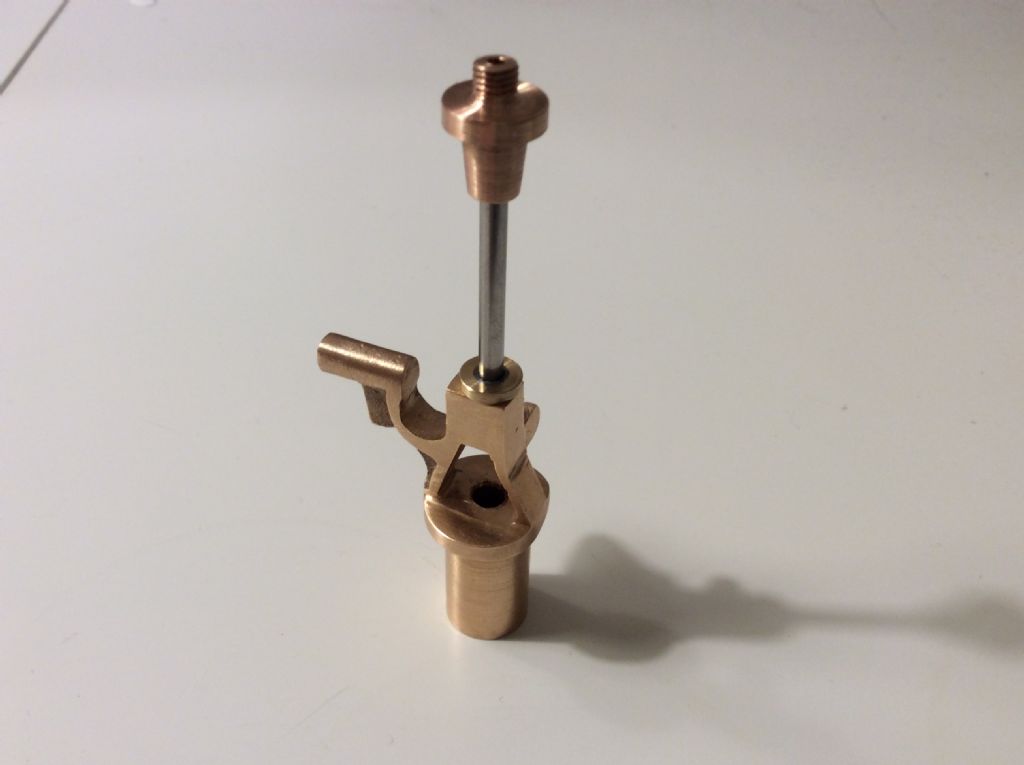

                          Evening all
                          Little bit of work done tonight, thought I’d have a go at the Pickering governor gives me practice at least on the lathe.
                          #394879
                          derek blake
                            @derekblake72550
